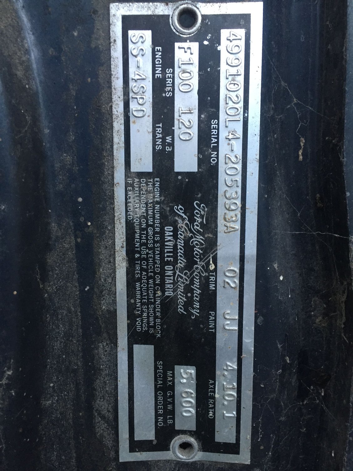

Need help decoding my vin
4991020L4-205393A
trim -02
paint-JJ
engine-SS-4SPD
5600GVW
4.10.1 axle ratio
Mostly interested in the paint and trim codes, and wondering if the 8 bolt axles are factory. Second owner of this truck and was told nothing has been changed.

Can you post a picture of your warranty plate or send me one in e-mail?
4 = Ford (8 Cylinder)
99 = Styleside Pickup
10 = 100 Series
20 = 120" Wheelbase
L = Left Hand Drive
4 = no reference to this digit
205393 = 1965 Model Year
A = 0 - 6,000 lbs. Gross Vehicle Weight Code (a range they assigned)
trim -02 = not sure on this one
paint-JJ = Caspian Blue - MC-30J-1544
engine-SS = 8 Cyl. 352 C.I.D. 2V - Service Code CEHC
4SPD = 4SPD manual transmission. Likely an NP-435 since it is a 4x4. Pics of the transmission and any codes would help ID it if it is original to the truck.
5600GVW = Gross Vehicle Weight in lbs.
4.10.1 axle ratio = Rear axle ratio. Likely a similar ratio in front like a 4.09 - axle tags or more research on my part might help with that.

Originally Posted by TA455HO
A = 3,600-5,600 lbs. Gross Vehicle Weight Rating.
trim - 02 = Medium Blue Crush Vinyl & Medium Blue Wicker Pattern Vinyl-81A Standard Cab.
A = General Information, Page 28 (1965 sample Canadian VIN decoded).
02 = 1965 Soft Trim - Page A2
Chad, OP's truck has 8 lug wheels, so despite what the VIN says, it's not a 100 series.

Here is the vin plate. I double checked it with the frame rail and it matches. Not understanding the 8 bolt rims and why they did that to a f-100. Unless after a specific GVW they upgraded them? Thanks for all the replies it really helps with my project truck! I also noticed the engine has double belts. Is that normal?
