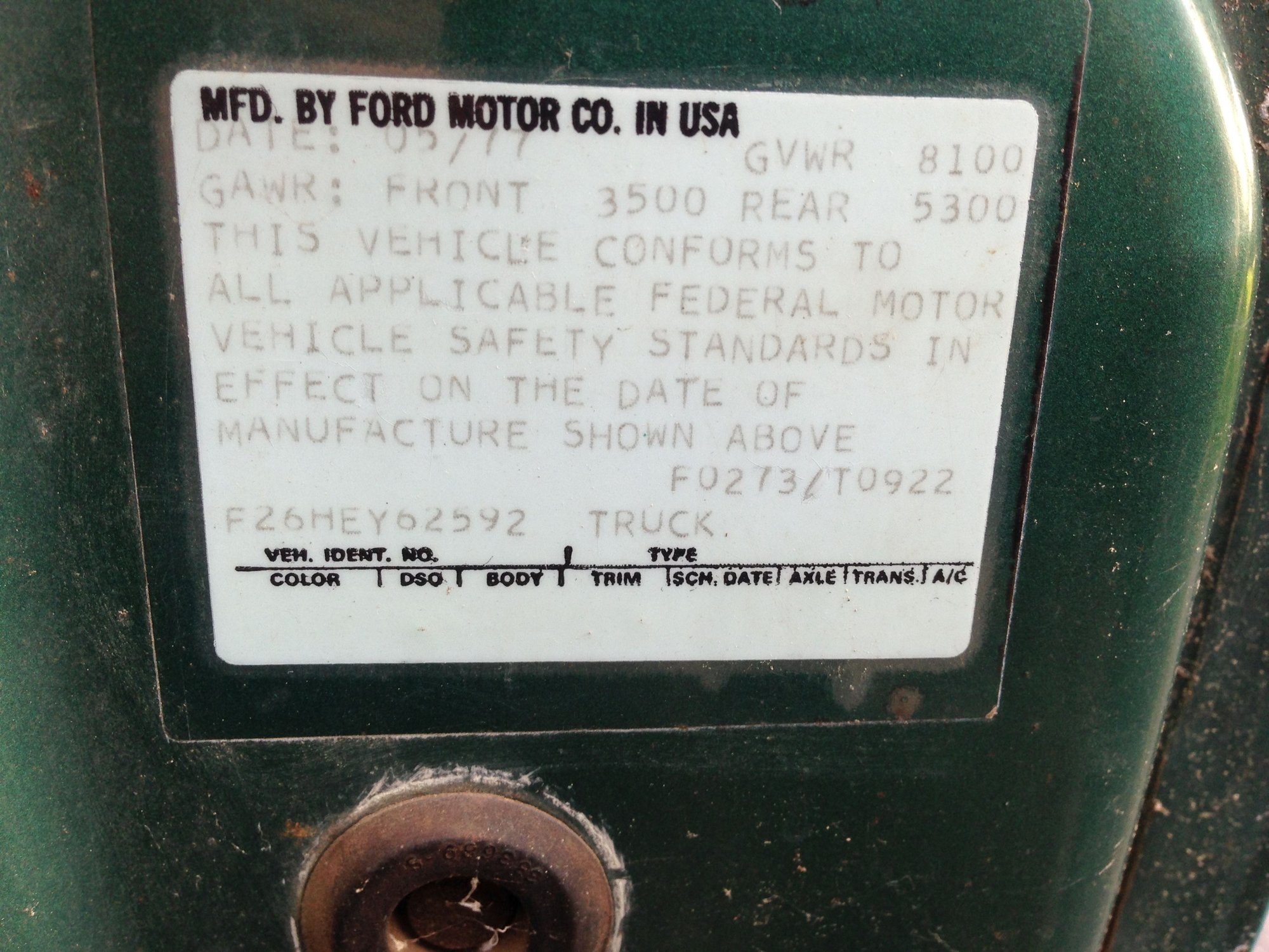

Hi all -
Please see photo and de-code when convenient, thanks. Just picked this up yesterday. Sold to me as all original vehicle, looks as though it could be.

F26HEY62592
F26= F250 4WD pickup
H=351 2bbl V8
E=Mahwah Assy plant
Y62592=1977 model year serial number

Thanks. How can I pick out the paint code, interior, original axle ratio, etc.? Or is that not possible simply form the VIN tag?
The picture you posted is the paper federal cert sticker on the driver's door jamb. Look on the back edge of the driver's door, below the latch, you should have a metal warranty plate riveted on. That will have paint and trim codes, axle and other info.
Note, quite often it's painted over, but looking at the picture you posted, it doesn't look like your truck has been repainted.

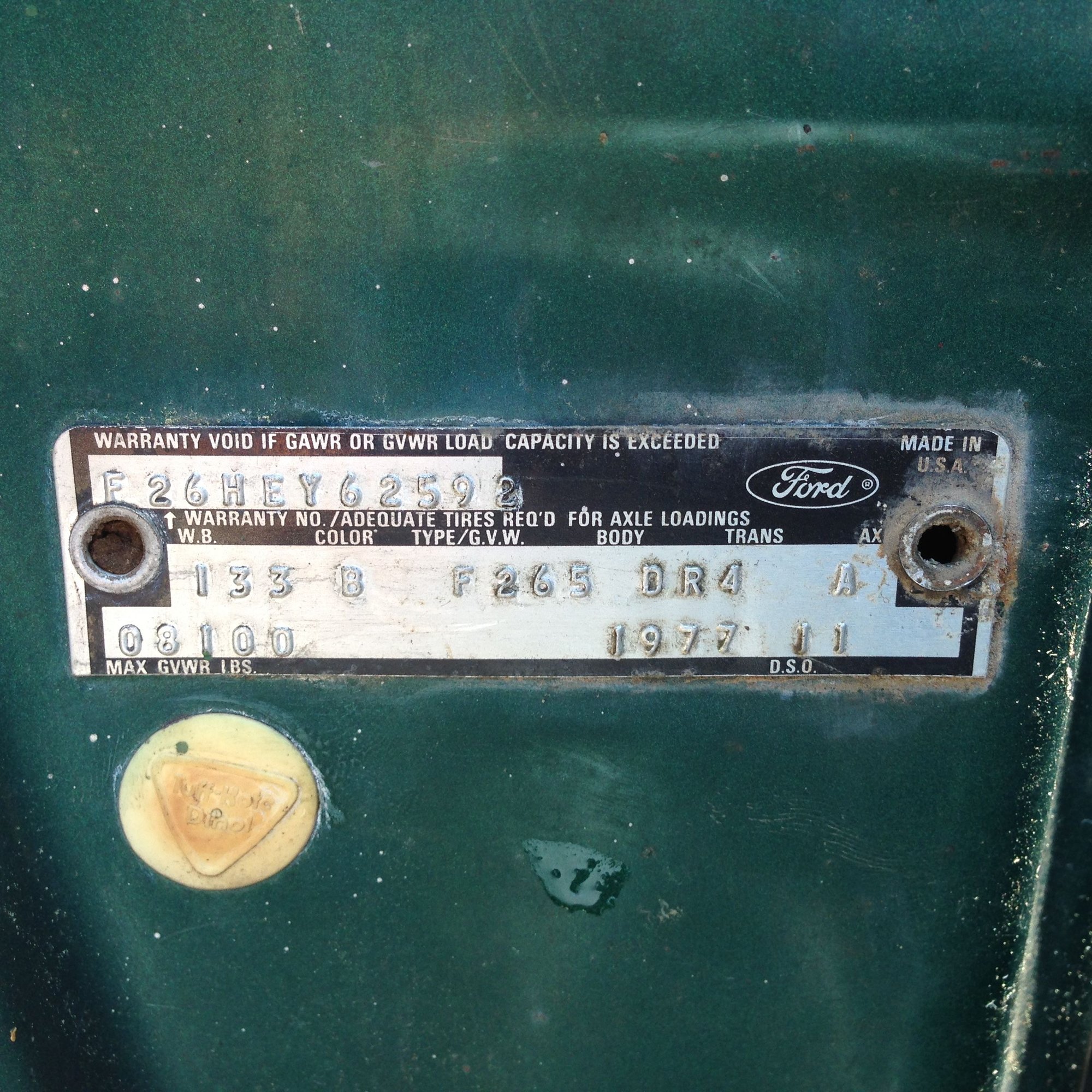

Here ya go, thanks for checking this out for me. I know the front axle is Dana 44 High Pinion, rear is Dana 60. This truck looks to be 100% original so far...who knew..!!

Color code B is Dark Jade Metallic, and DR4 is Jade all vinyl, the 4 denotes Reg cab with styleside bed.
Technical Index - FORDification.net - The '73-'79 Ford Pickup Resource
The assembly line worker at FoMoCo that stamped the codes on the 2nd line, did a p!ss poor job. The codes were stamped sooo far to the right, that there's no place for the AXLE code.
133" Wheelbase.
B = Dark Jade Metallic.
F265 = F250 4WD Pickup .. 8,100 lbs. GVWR
DR4: DR = Jade all Vinyl / 4 = Styleside Pickup.
A = New Process 435 4 Speed Manual Transmission.
AXLE:
8,100 lbs. Gross Vehicle Weight Rating.
1977.
11 = Boston MA Ford District Sales Office, where the original selling dealer ordered the truck from.

[QUOTE=NumberDummy;15460342]The assembly line worker at FoMoCo that stamped the codes on the 2nd line, did a p!ss poor job. The codes were stamped sooo far to the right, that there's no place for the AXLE code.
Thanks Bill. Yes, that was near the end of the once magnificent Mahwah Ford Plant. Things got a little sloppy at the end...lol. I think the tags are still on the axle covers!! So I will get some de-greaser and pressure wash tomorrow, see what we got. All the best...
