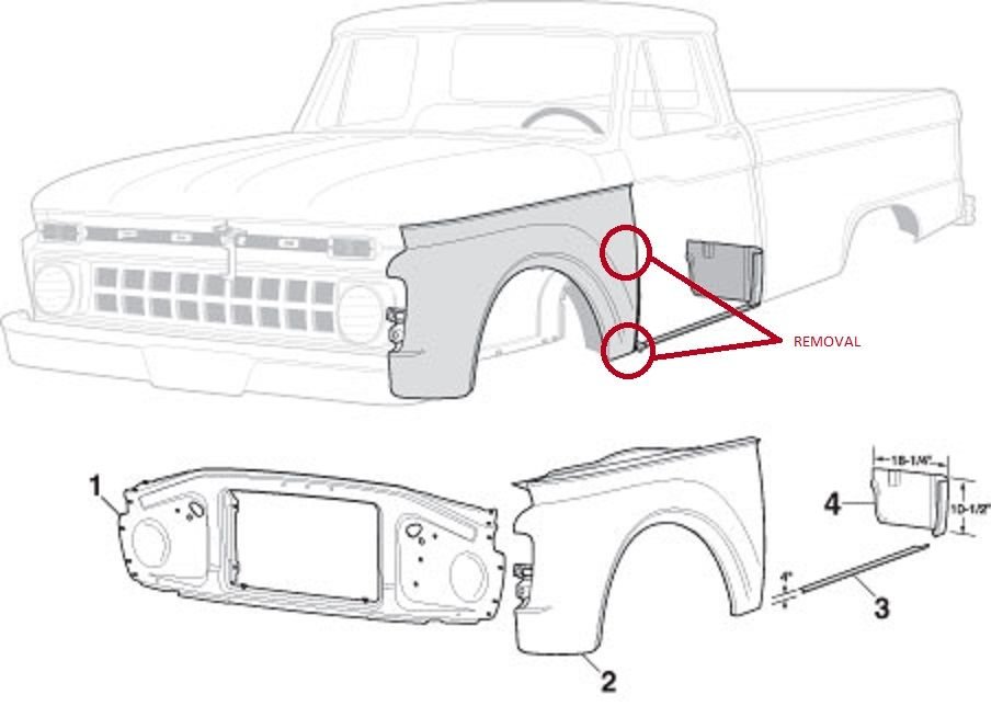

What is the best way to remove these two bolts? They just spin. Thanks

A sawzall with a long blade, and a helper holding the fender to provide some tension on the bolts. It worked for me.

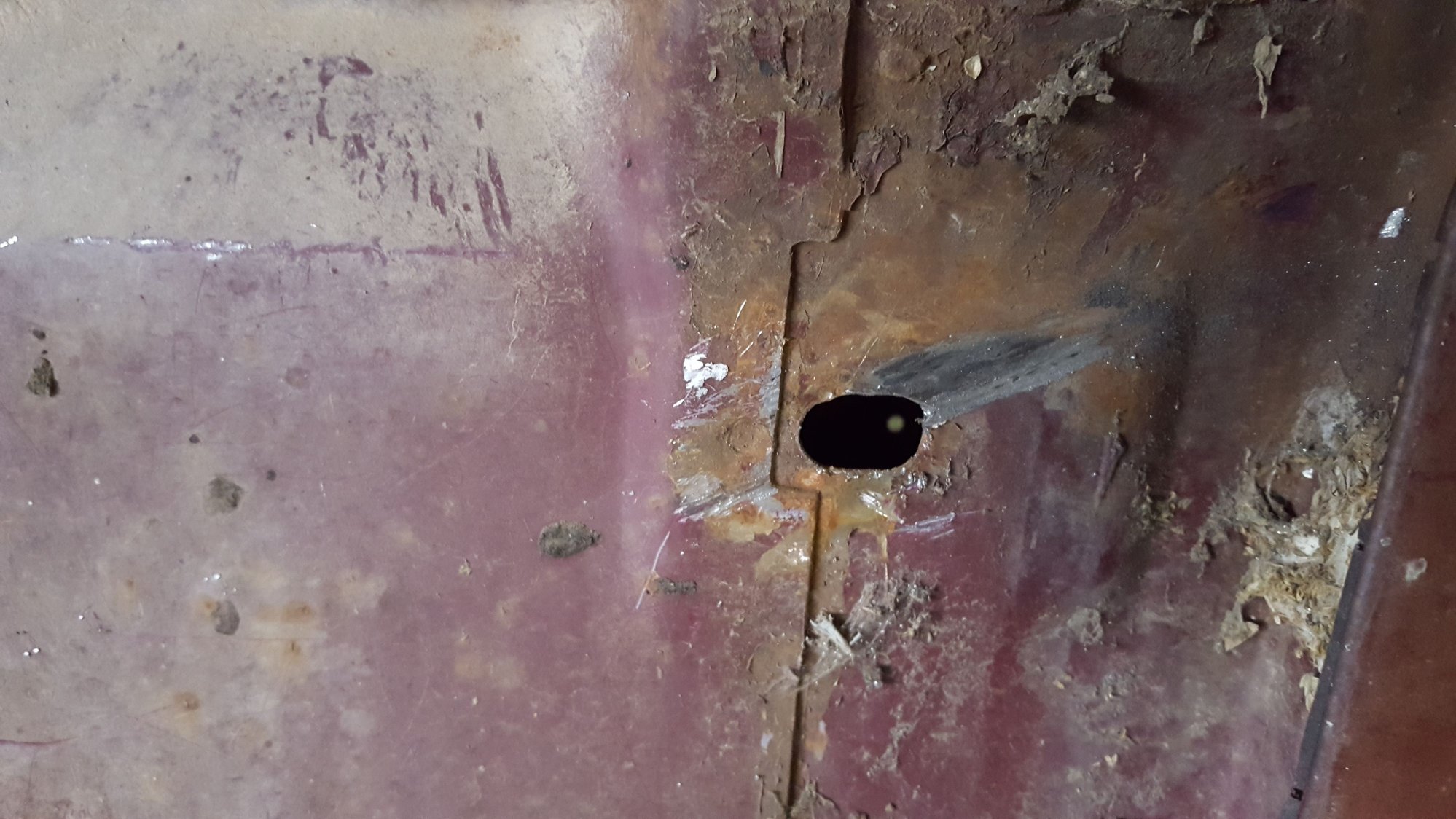

Fender after cutting with a 12" sawzall.
This is what the cab looked like after cutting the bolt. Very little damage.

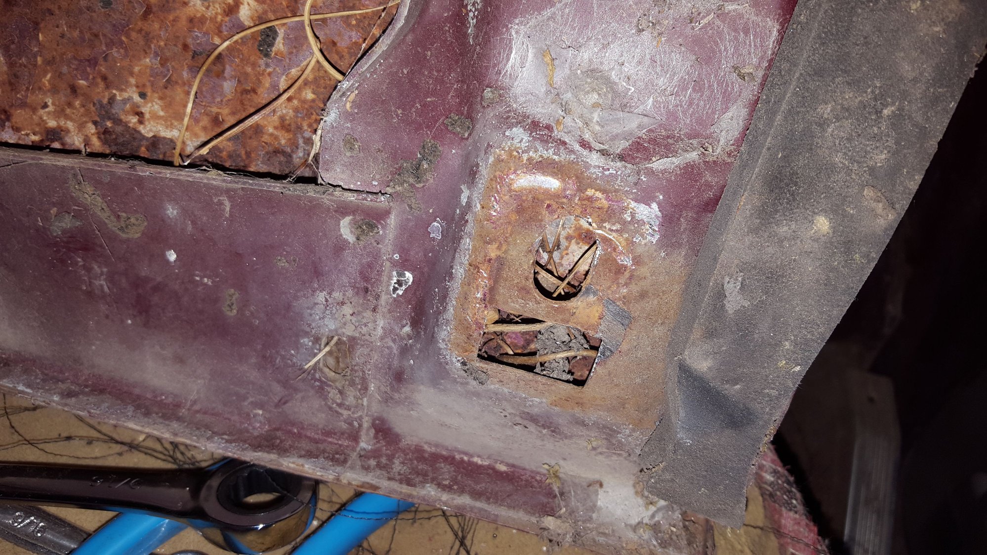

Bottom of fender, cut with a cutoff wheel. Going to need to revisit this one.

Nice pics, the rounded holes are luckily still in good shape. I wonder if you can separate the round end plate and tack it to to a new bolt or maybe start with a new washer and zip off the sides a bit to get the basic shape you need?
