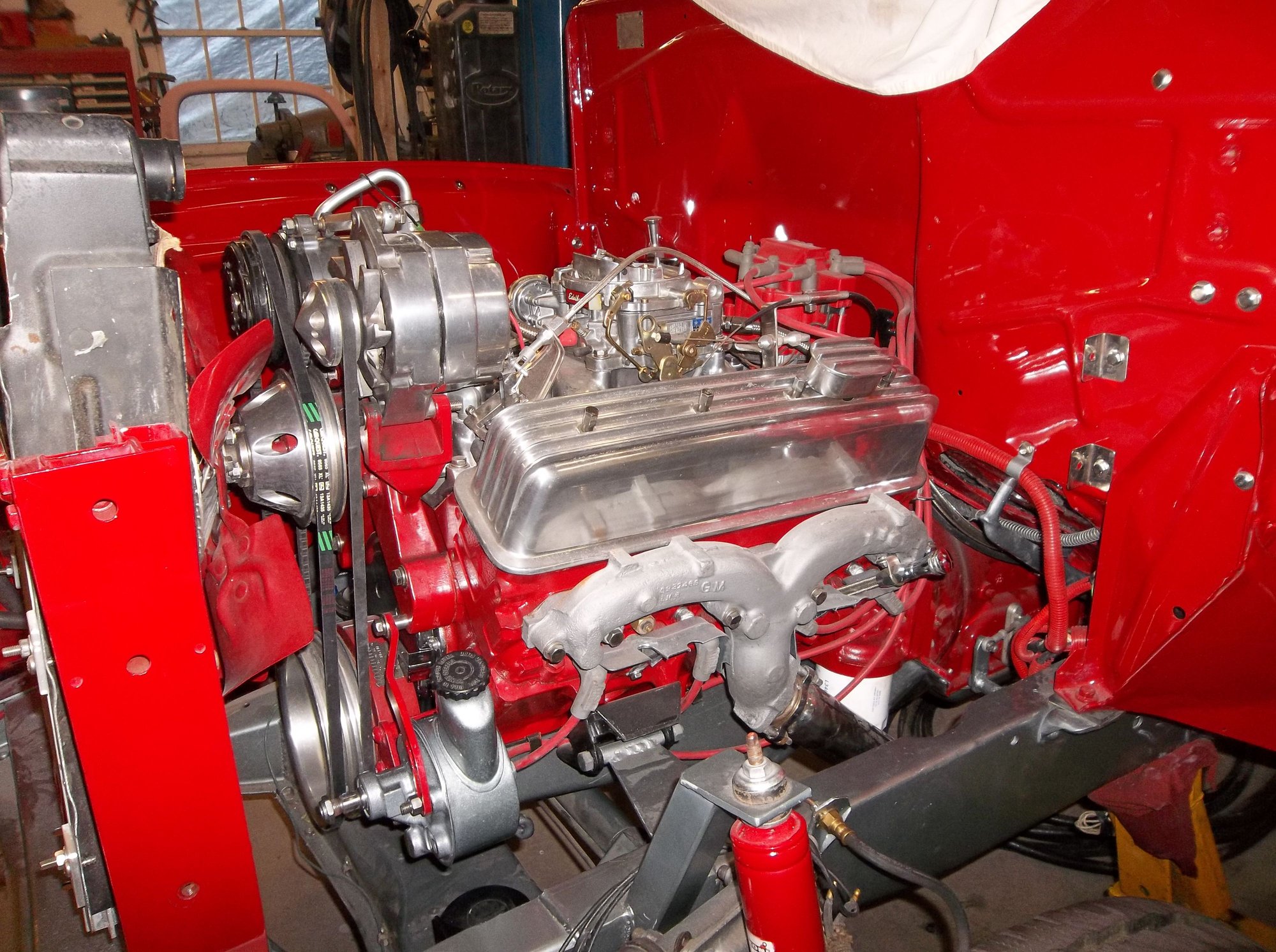

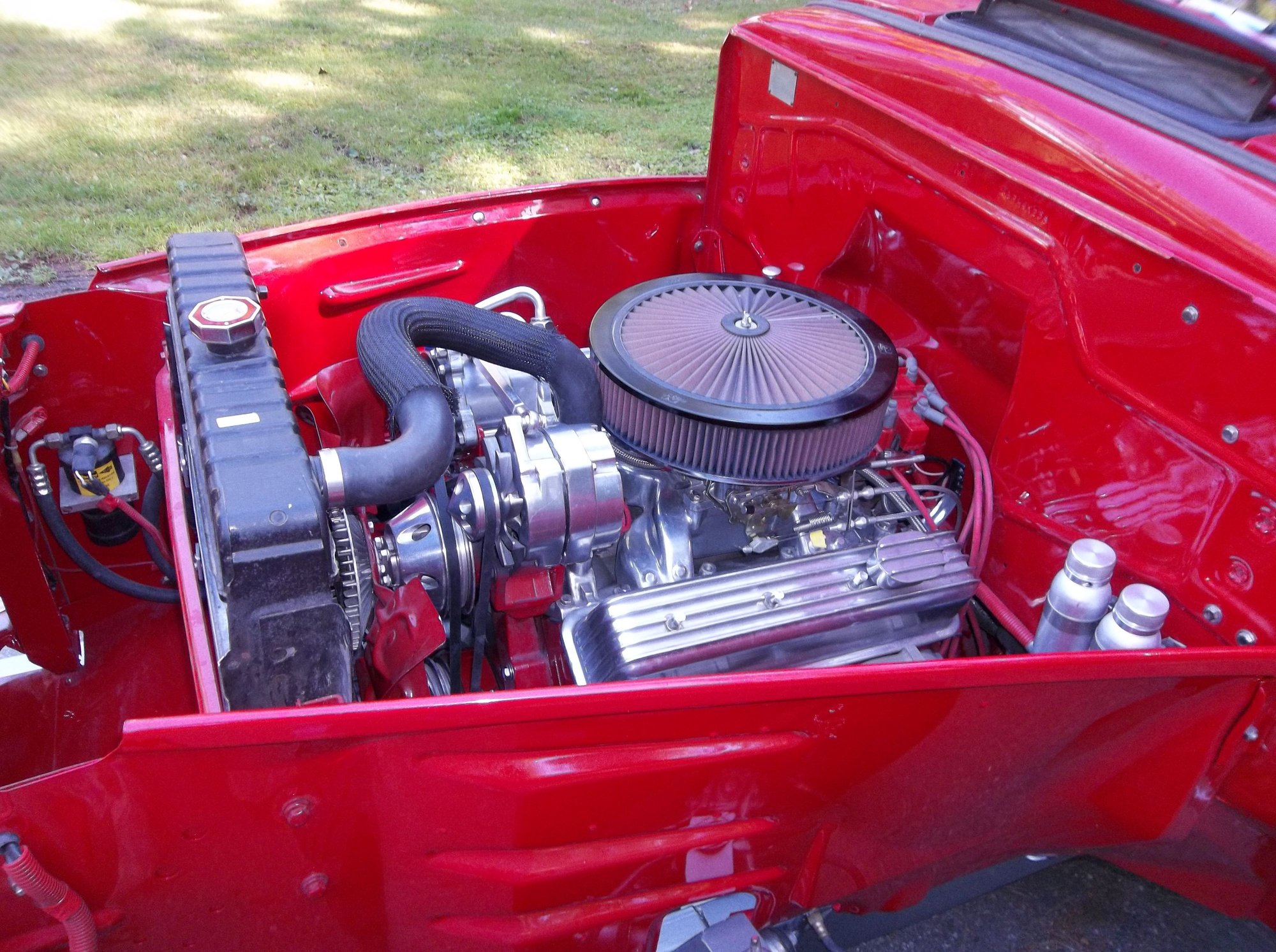

John,
I also wanted a clean firewall. I ran the wires thru upper left corner of the drivers side toeboard which on my F-1 exits just behind the front cab mount. The front wires are in the boxed forward portion of the frame and the rear wires are held in place with clips on the top of the lower flange of the frame rail. Just a few wires, distributor, AC clutch, oil pressure sender, etc are in the red wire loom low on the firewall. My heat and AC run under the right front fender, Not an option with a tilt hood.
