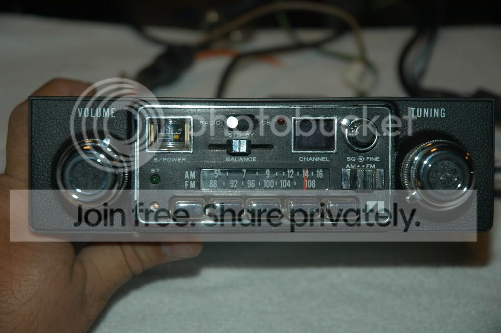

If you could find one AMC had as an option a AM/FM/CB radio that installed in the dash
taken from here
https://www.google.com/search?q=am+f...mzySFkTGmaM%3A
Dave ----

In any case, its one of those things where I will gladly go with another brand but I need a radio with weather alerts in this style as I am limited on space. I would do the radio one but I looked on Ebay and didn't find a single Ford or AMC factory radio.
