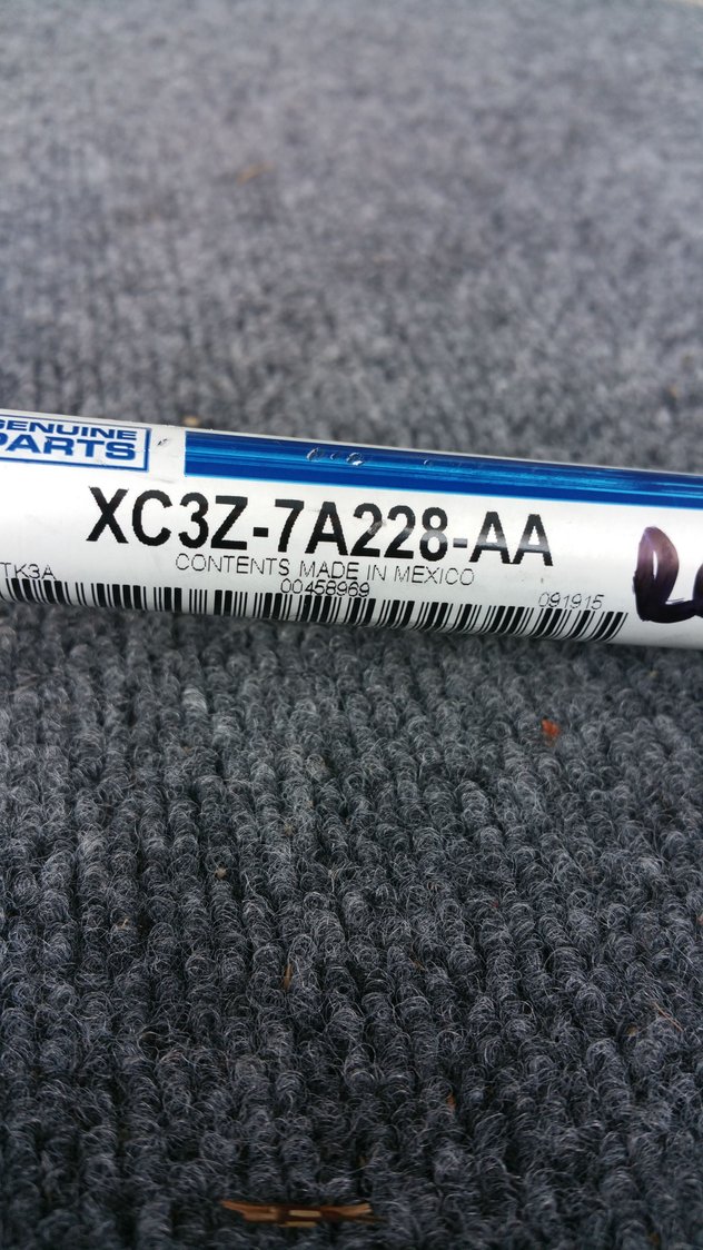

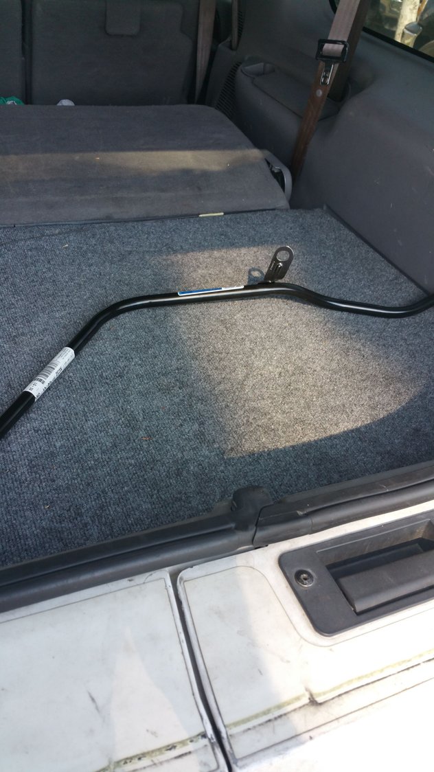

Here is what you get for $40 at Ford.
And for anyone wanting the part number.....
It is getting installed at a local shop here. If anyone needs trans work in the hemet/san Jacinto area in so cal I recommend blues transmission . Great people they squeezed me in on a very busy day. Price was less than a 5th of the stealership too.
