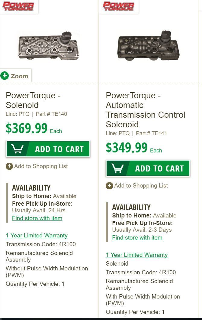

The part number for the one I used was TE140. It states it is for the 96, also when i took the old one out it looked the same.

I looked up part compatibility and it showed that one for a 4R100 Automatic which I believe was put behind powerstrokes...they're both 4 speed automatic but the similarities end there...
Mark will know better than I...
After some research, it seems the E4OD and 4R100 are basically identical in a lot of ways, so I figure the solenoids may be identical...

Well, no, that's not right.
The 4R100 is a renamed E4OD. The name changed when the Superduty was introduced. There are mechanical differences, but if it were not for the SAE (Society of Automotive Engineers) suggesting a common nomenclature for naming transmissions, I'm sure the E4OD name would have stayed with the trans through the end of it's run in 2004.
Those two solenoid bodies you show are NOT interchangeable. One is a PWM and one is not. The E4OD did not use a PWM solenoid body, the 4R100 (other than the early '99) did use PWM. Don't mix them up, it will cause problems.

The part number he said pulled up as not having PWM.

He should not have a PWM in an E4OD. So that is right.

Ok so part number TE140 is correct? what does this mean for the current codes? just not sure what the next step is.

The TE140 is the correct part for an E4OD.
It doesn't mean anything for the current codes. You have to diagnose if the problem is in the wiring, a connector, or you got a bad solenoid body.
