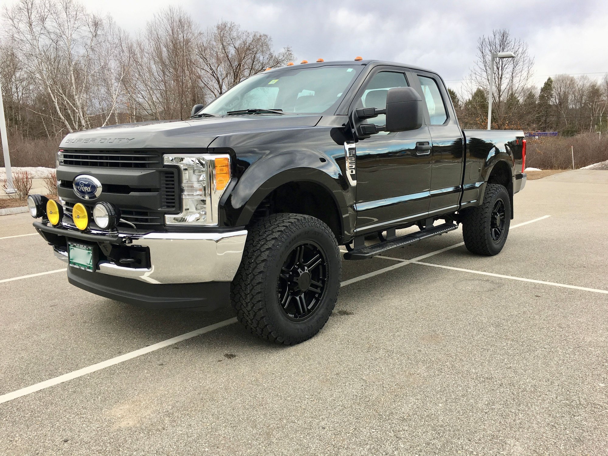

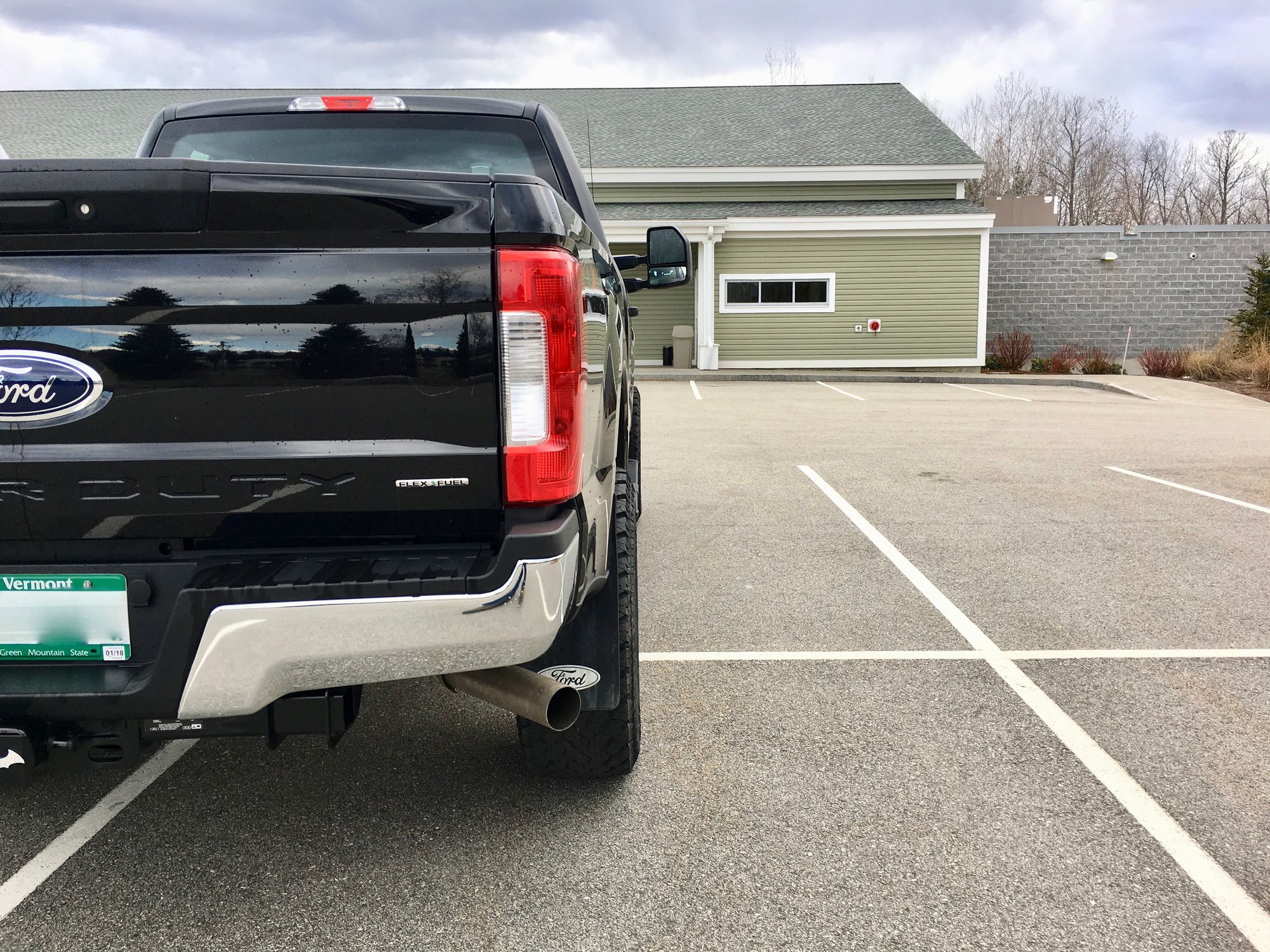

I have the snow plow package, so it's almost level right off the lot. That being said, I went from my factory 245 17's to 20" rims with General AT2's in 35x12.5R20 tires. They BARELY stick out, maybe 1/2". No level, no lift, no rub. I did remove the front mud flaps. I will re-contour the front flaps with a heat gun a bit, as the inner corner rubbed a little at full lock. My rims are Granite Alloy 20's with a +19mm offset.
Granite Alloy 8-spokes 20x9" with +19mm offset.
Not a great pic to see offset, but it's only about 1/2"
You can sort of see the rear offset. I think it's about perfect.
Totally digging the tires and wheels. Just what this truck needed, IMHO.
beautiful truck. really like those tires. oh also like the state liquor store your parked at! lol
