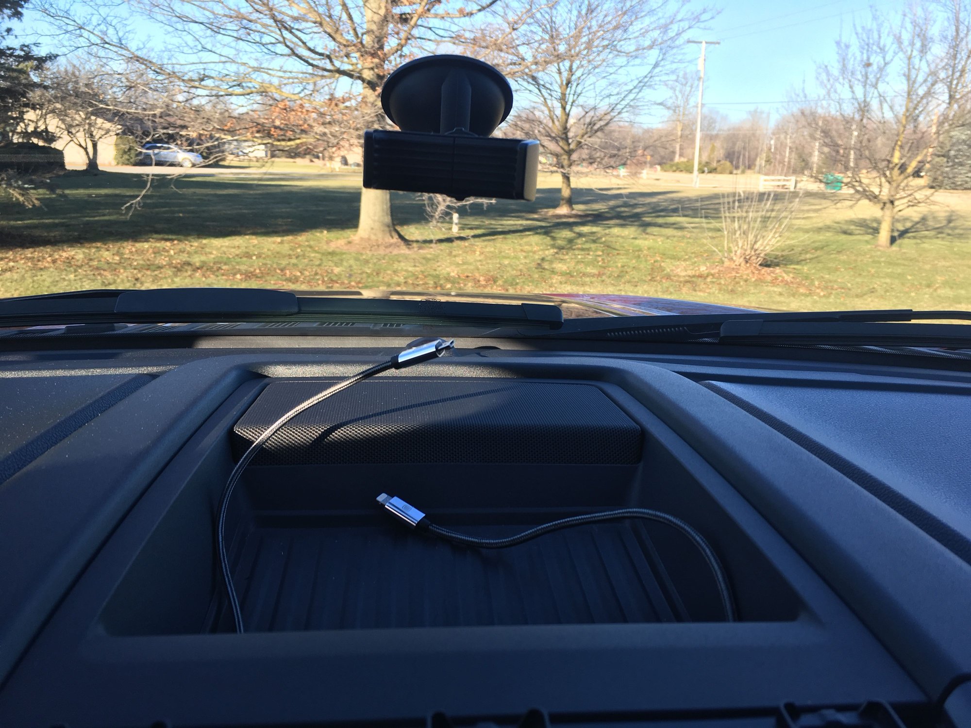

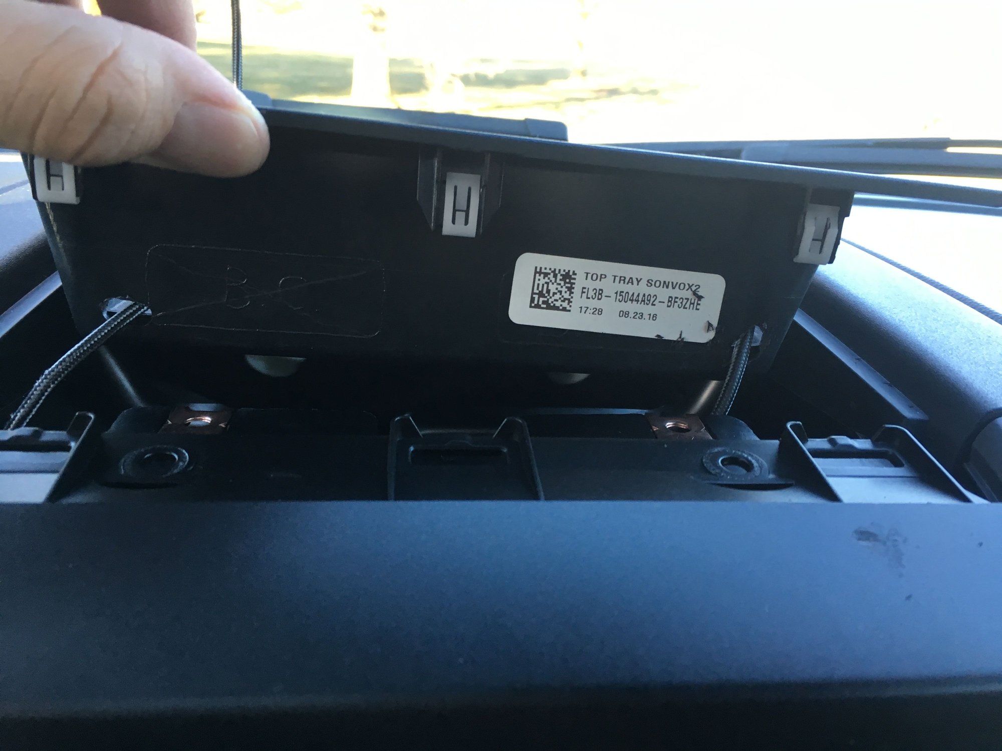

so I try not to touch the phone much while driving so I typically have it in a phone mount on my lower center windshield. I hated having charging/sync cable wires draped down the front of the center stack so I pulled one USB mini wire and one lightning cable from below the driver side lower dash panel upto the top of the center stack. I then drilled two small holes in the center top stow tray and pulled the cords through and have them laid in there for when I need either one or both of the cords. There is over a foot of loose wire slack inside the dash so I can push and pull as much cable as I need.
Below the dash I currently have the two USB ends of the cables plugged into a 12v charging adapter that is plugged into a hard wired 12v power point that's wired to my #6 upitter and I have the relay set to it can be powered with key off. I don't typically need to plug my devices into the USB port in the tray however if I want I can't easily reach down and pull the USB cord out of the 12v source and run it into my tray port.
i love it!!!

i love it!!!
Great Job.
