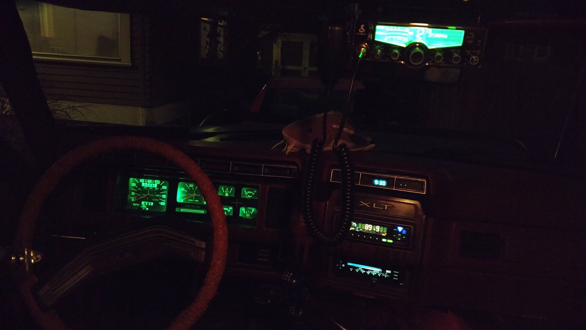

I installed green LEDs and left the blue lenses in
These are the ones I bought:
https://www.hipoparts.com/ultra-brig...er-wide-angle/
They mention that they will only light up when put in one way to the way I did it was I left the cluster plugged in but not attached, and then I plugged in each light one by one to make sure they'd light up. All in all I'm pretty satisfied with them.
