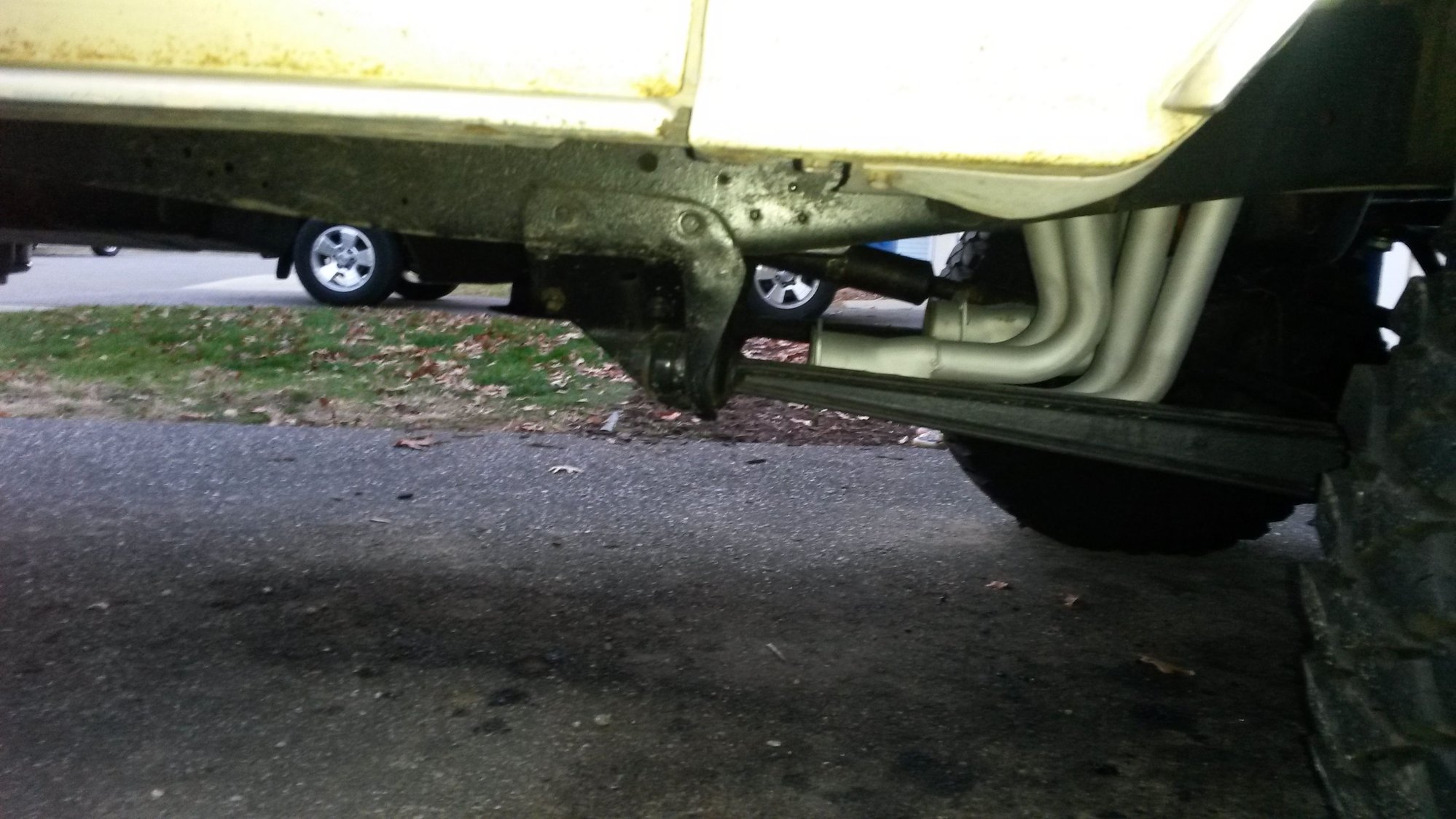

Fenderwell versus block hugger IMO.
Fenderwell exit design get more of the heat producing pipe out the engine compartment faster. Way easier to finish the rest of the exhaust system, meaning header mufflers, turn down tips and done. Or at least you do not have to work around the trans/xfer case crossmember.
Block huggers produce heat also, but IMO the design puts it on the block/starter and that keeps it in the engine compartment. Also a caged starter meaning PITA to remove starter.
Full length are long tube/longer ended. Usually right in front of the crossmember. PITA again. Fenderwell exit are just that, exit outside the fenderwell.
I have Headman fenderwell on the F250 4wd red truck. Easy peasy, no steering shaft interference, little brake line reroute. Only had to trim like 2" tall X 6" long strip of innerfenderwell. Maybe bump grind a bit of the front cab mount cup?
Put the straights with tips at 1st (insert STUPID LOUD), then stacks STUPID LOUD X100....then the header mufflers. Way better now, I can hear myself scream in the cab. LOL
Here is a link to my 0.02 on it and what worked for me. https://www.ford-trucks.com/forums/1...l#post14696882
Ever had my issue with tire clearance. Asking cause mine is 2wd and yours probably has just a little more clearance than mine.

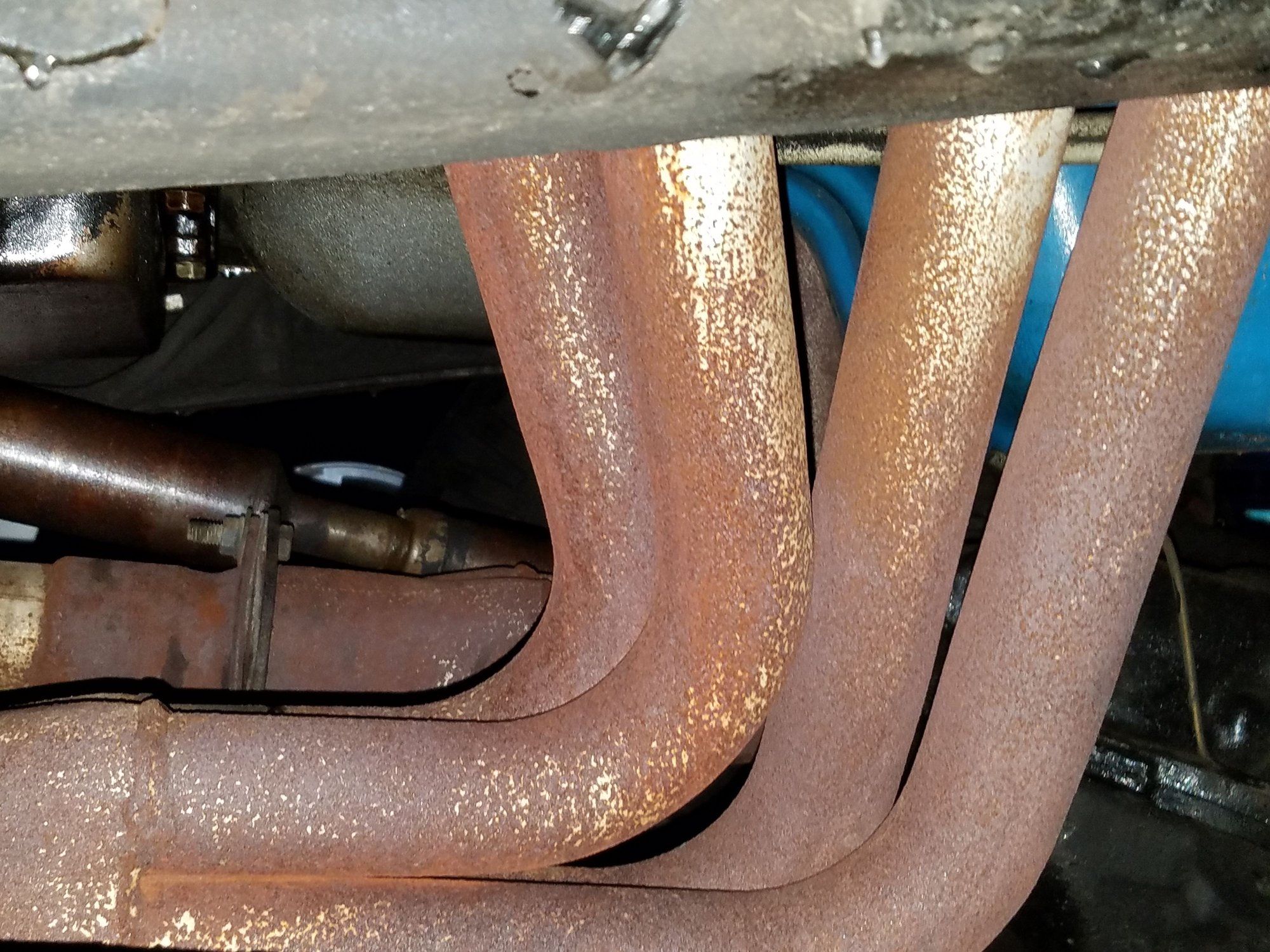

Sand blasted them, wiped them down with acetone, POR high temp primer, POR high temp silver paint, put them in a powder-coating over at 600* for one hour. Installed on truck. Less than two months looked like this.
First install
Two months later
Old Dec 13, 2017 | 04:21 PM
Aaron-71's Avatar
Aaron-71
Joined: May 2010
Posts: 4,436
Likes: 19
From: Regina, Saskatchewan
My first thought was sand-blasting was the issue - but that doesn't make sense if you wiped them down.
Man that's a huge bummer - I'm already praying to the Ford Gods that all my POR-15 efforts doesn't have the same result. You must have been pretty mad when that started given all the effort to sandblast those suckers down.

Oh yeah, I was pretty angry. I called POR and they just said sorry. They said if I send my headers to them, they would redo all that I did with hopes of a better outcome, on my dime of course. I'm not hating on them at all. They were pretty cool about making it right but I had to remove my headers, box and ship them, be without my truck for god knows how long, reinstall them, and hope the headers don't rust like they did. At that point I would just reinstall my manifolds and be done with it.
