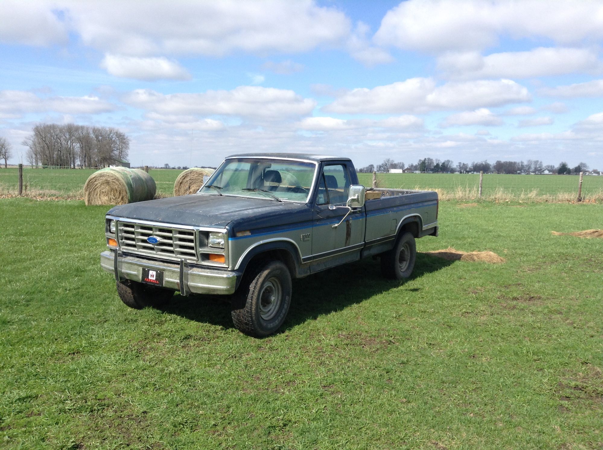

Wish the weather were As nice as it was in that photo but the truck is back to good
