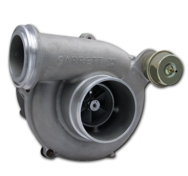

Unfortunately the KC38R looks a little too aftermarket to reliably pass CA smog.
I'm not really considering reman or rebuilt injectors.

The smog techs here are told to look for the name "Garrett" on the compressor housing.

The fact that "Garrett" is cast into the housing of the the 38R is exactly why I'm going that route.
If it failed, you could just swap the old turbo back on for the test. It's only every 2 years and it's not THAT much work to swap turbos.
