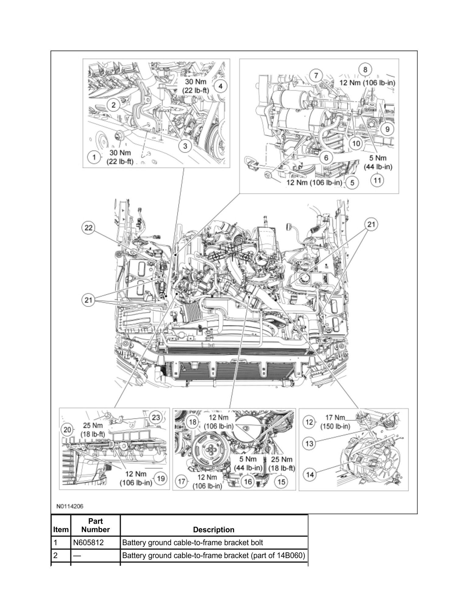

Hope this helps. You will have to read through it to get the info about the cable you need replaced
