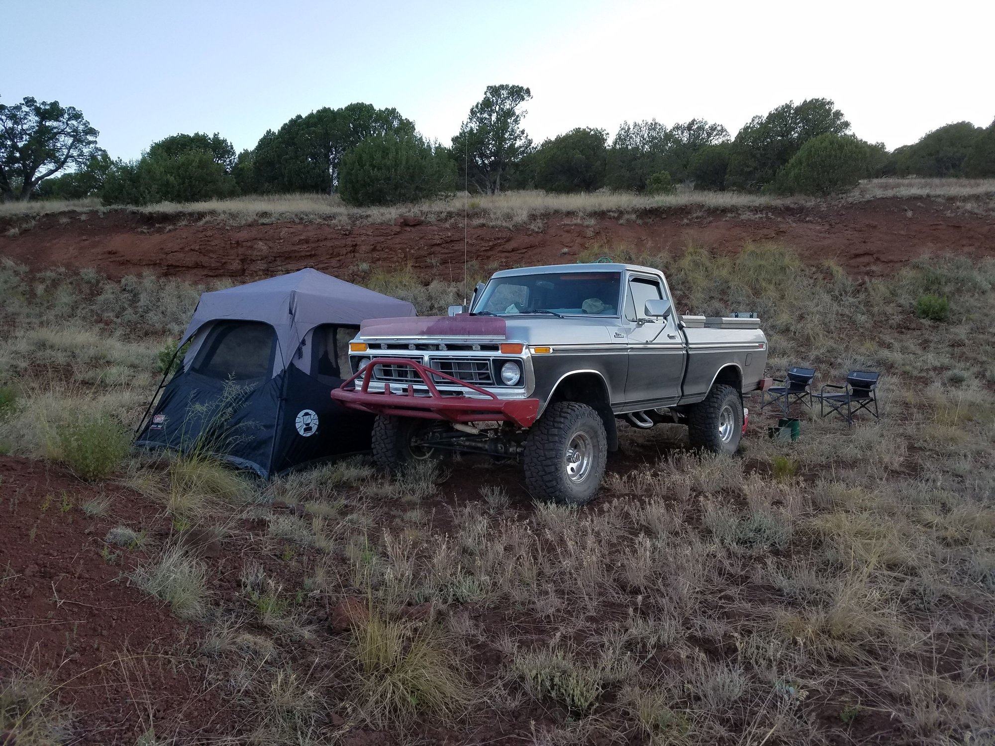

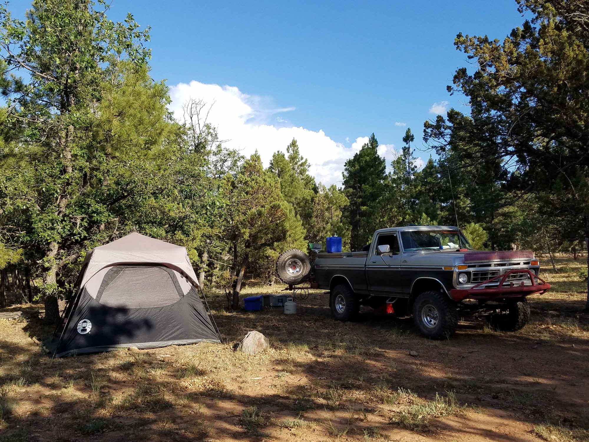

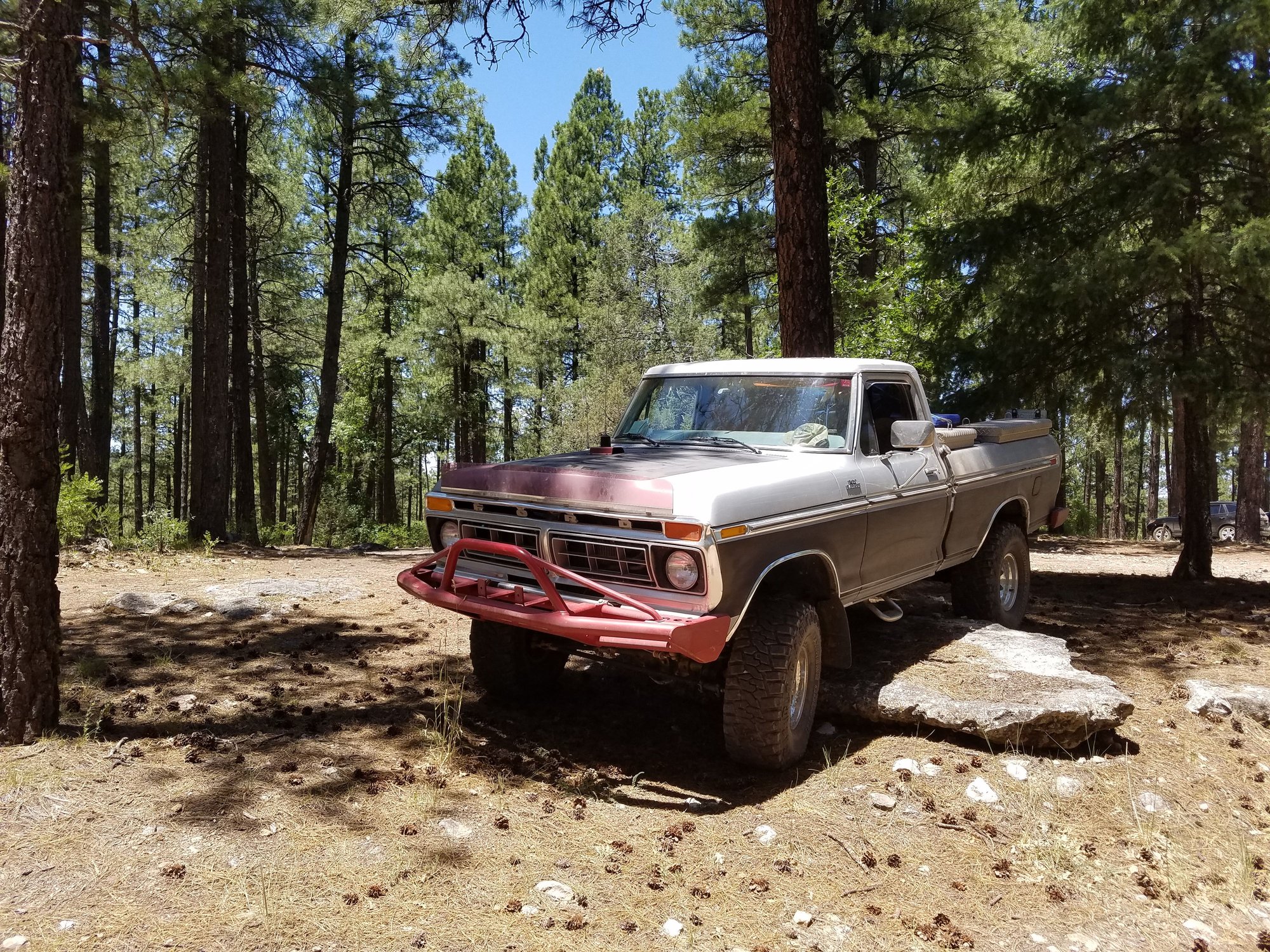

Oh, and since everyone likes pictures, I took a couple.
First is a poser shot. Next two are two of the three campsites we used.
