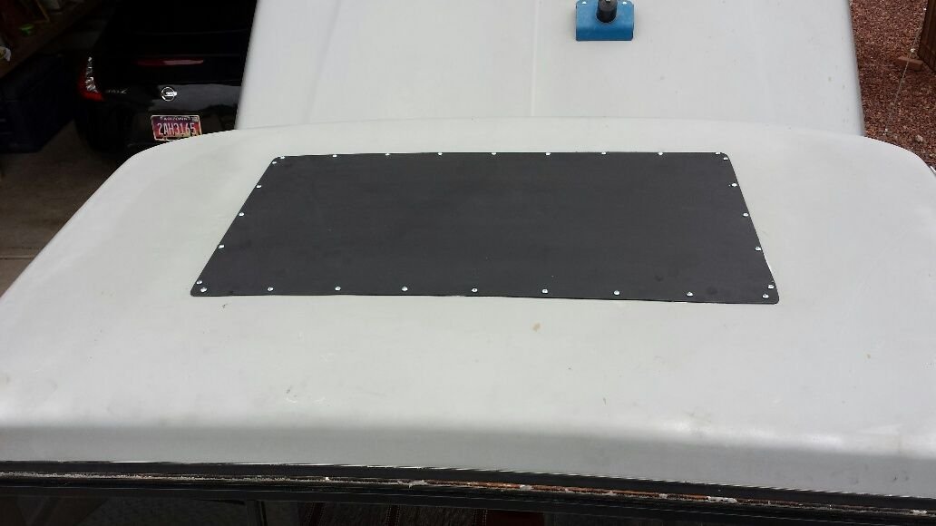

Tearing into a few other things this weekend to include the upgraded alternator, and sunroof delete. Got a nice new plastic headliner from LMC truck that I painted red last night to match the interior. The non-op 70s sunroof will soon be history. Using aluminum to cover the hole.

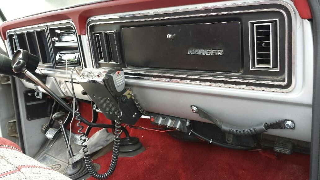

Cup holders, 5 grab handles, and a new headliner minus the vintage 70s non operable crap sunroof.

Nice. I like those grab handles I need one on the passanger side on the dash like you have.

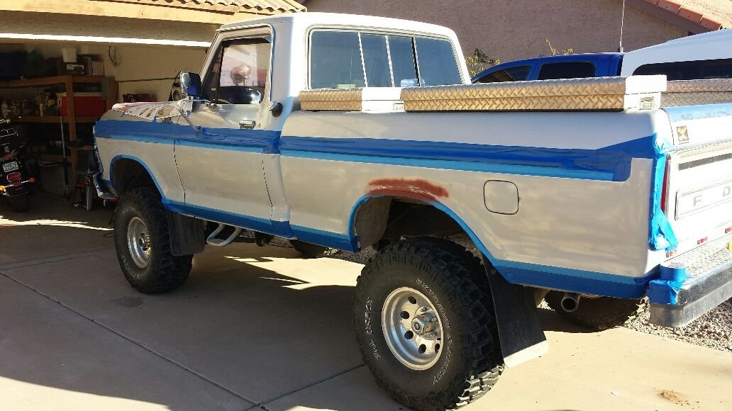

Started on the bedliner side paint job last night. Ran out of daylight so pics will have to wait....

Body masked off for bedliner. Will post more when that job is deemed complete by me...

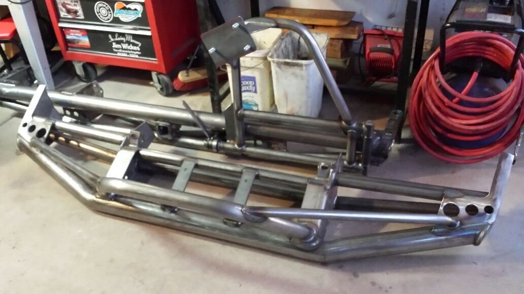

Look what showed up yesterday!

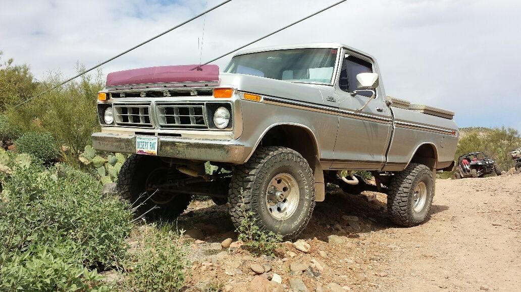

It hasn't been all work. Here it is on the trail a couple weeks ago.

Protofab built the bumpers. They're the ones you see on the JBG site, but I went to Protofab directly since they're pretty close to me here in AZ.

Got some color on the bumpers this week...they're pretty much ready to go on. Just need to get an extra set of hands or two to help.

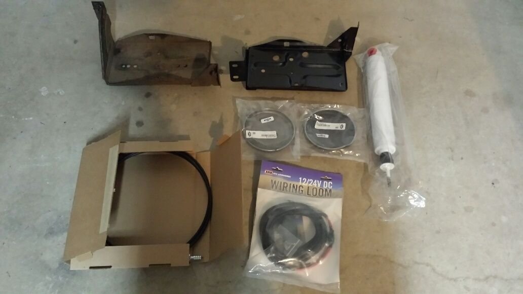

Oh, and I also have two battery trays there. The one on the left is from a local yard and is for the driver side - can't believe I found a rust free one.
I also bought one from a board member so will use the better of the two, but both should be good parts. Anyone interested in one? Want to get my money back out of the one I bought here.
Dual batteries are going in.

New rim I got from Discount and had my new tire mounted to....idiots ordered the wrong lug pattern. That rim was backordered for a month.
Spring seats I bought were also the wrong ones. They changed them to a different bolt pattern mid year in 1977. I have a February truck. I guessed wrong. Ordered new ones.
Dual battery kit I bought from summit was missing parts in it - specifically the wiring harness and the isolator switch. There's one of those kits left in the US...it's getting shipped to me this week. They told me to get the parts I needed out of it and send the rest of it back.
My bumper hardware and rear bumper mounting brackets were also supposed to be shipped out of Mayer, AZ on Weds. Those also never showed up, so I have these really nice bumpers I can't mount.

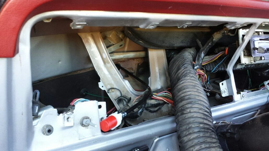

Anyways, first shot is with the guage pod removed.

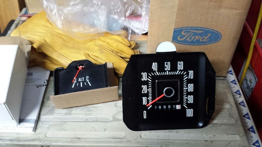

The new speedo went in, as did the reworked voltage meter I got from Classic Cougar. It's calibrated to read voltage instead of amps and 12.5 volts is dead center on the guage. 14.5 moves the needle over to the C side. It was an easy install. I made a couple connecting wires for it and insulated it from the circuit sheet with nylon washers. Then I ran a ground to the dash and the hot tied into the radio power wire. Works like a charm, as does that NOS speedo.
