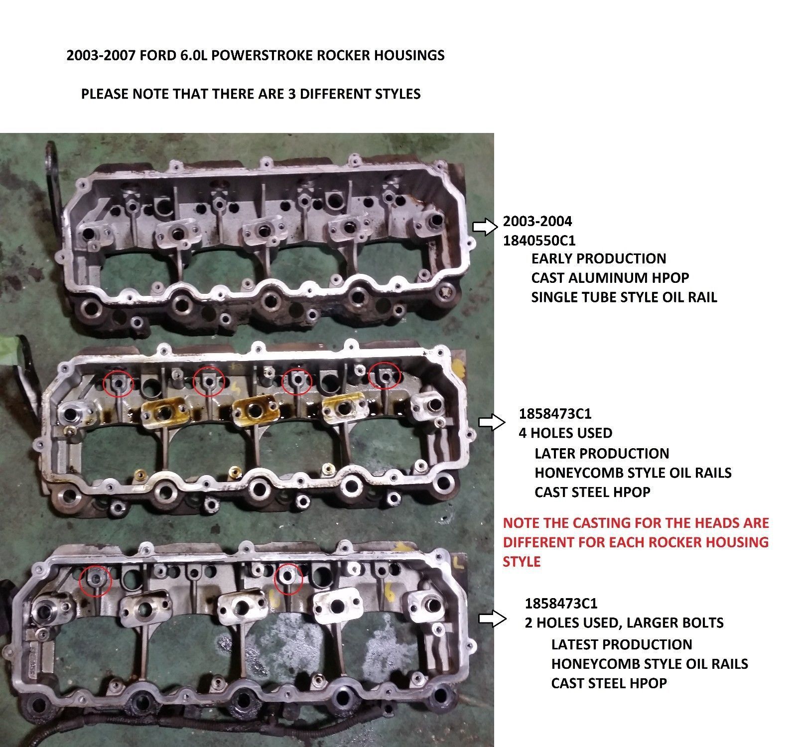

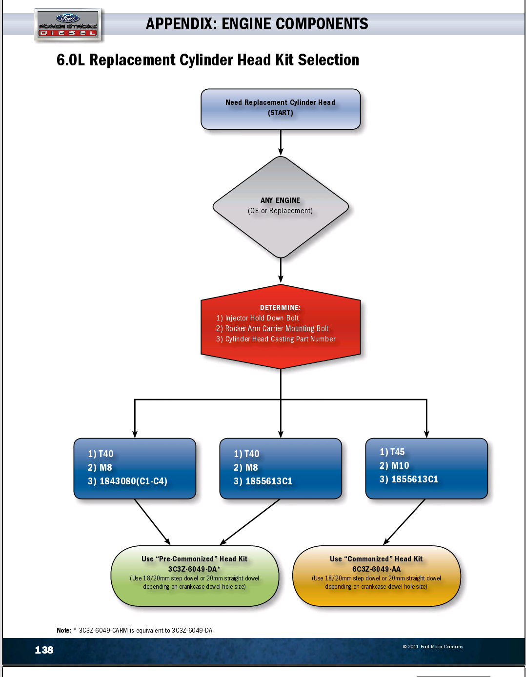

Will the 20mm head fit on a 03 which is a 18mm?

with a dowel adapter yes, but I have zero knowledge of the reliability of them. I seen the adapters one day while head gasket hunting

There is more involved. The rocker boxes are different along with glow plugs and injector holddowns.
