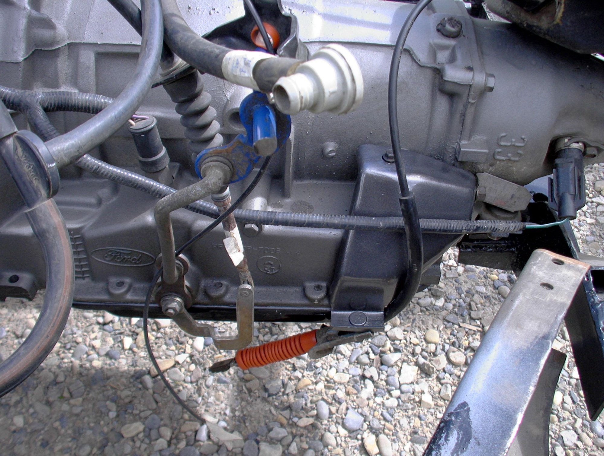

BB Ford in the hot rod truck . Custom fabbed the heavy duty motor mounts . Lokar shifetr w/ one off carbon fiber trans cover . Mover the steering box down 2 " and out 1" to use the cast iron exhaust headers .
