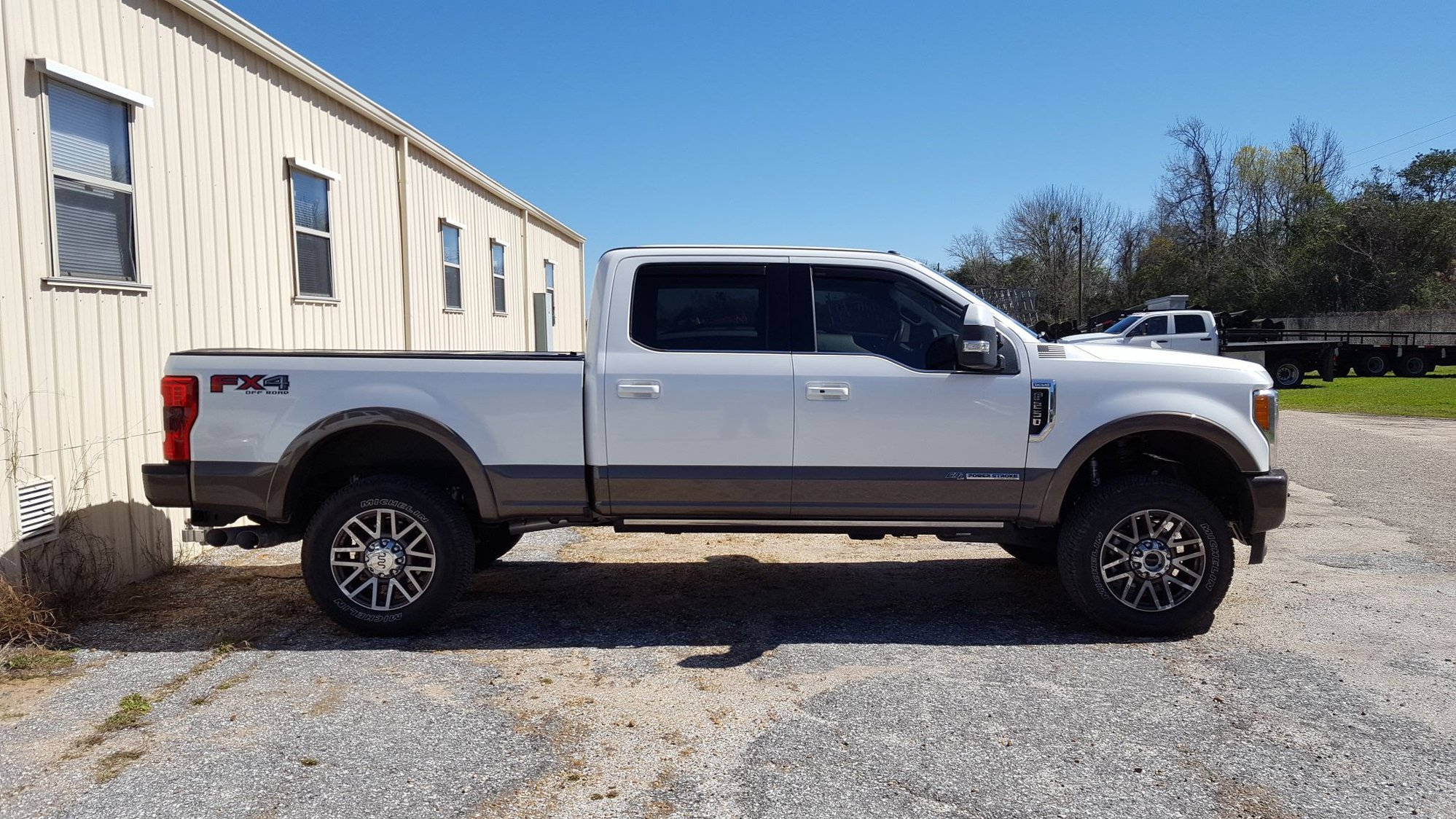

I just had Pro Comps 2.5in leveling kit put on with Fox shocks all the way around and I couldn't be happier with the results. The ride has definitely improved and the truck's stance is much more to my liking.

How about a picture?

My cell pic is cocked to the right so it looks like I'm going down hill but you get the point. Please forgive me it needs a bath and I haven't put the new Toyo's, mud flaps and wheel liners on yet.
