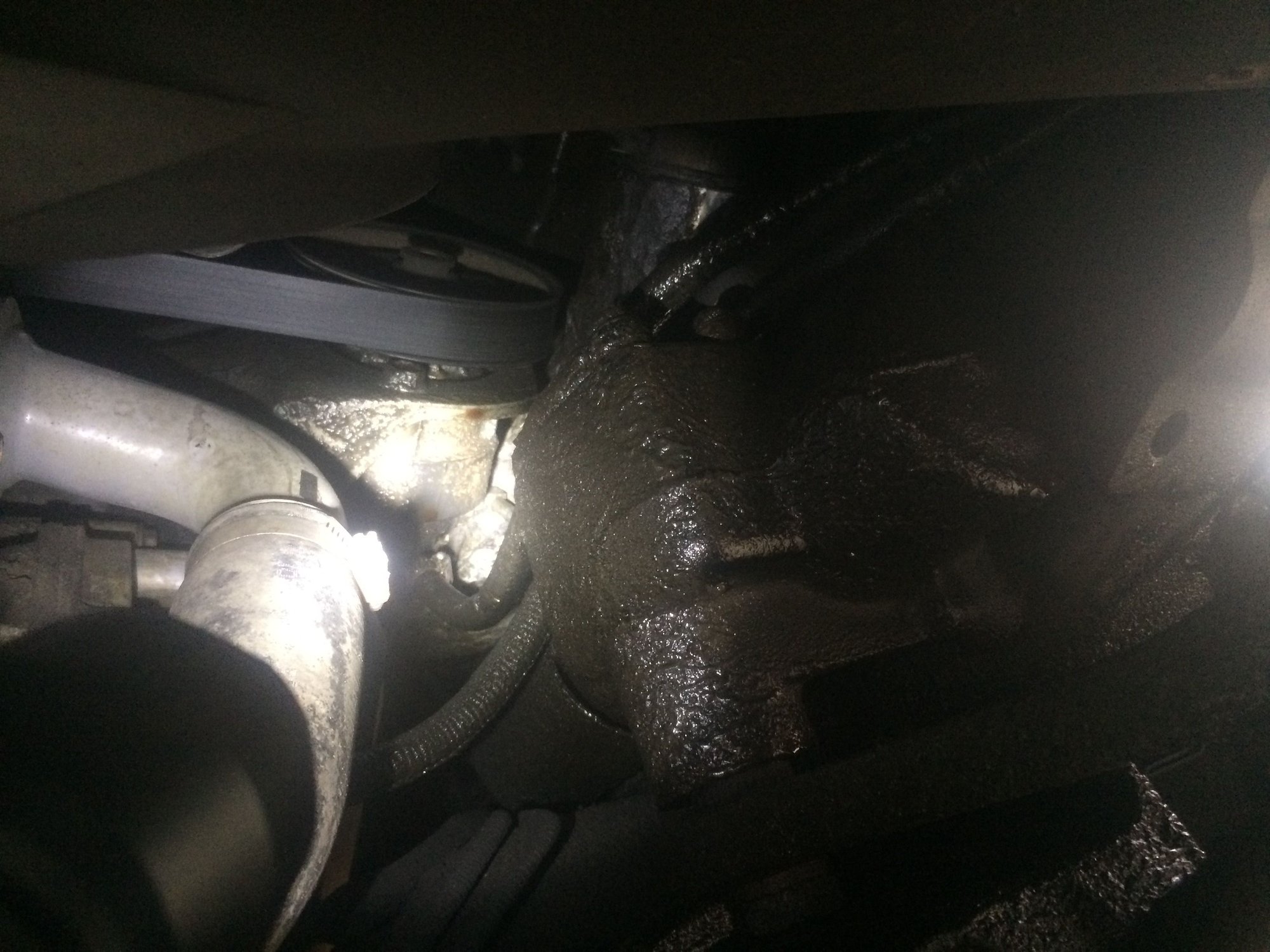

The leak this time is as non descript as before. Just seems to be ATF everywhere on the hoses and pump and drop in level on the reservoir. I will do a clean up again and post some before and after pictures - good advice thank you - i should have realised I didnt give much to go on

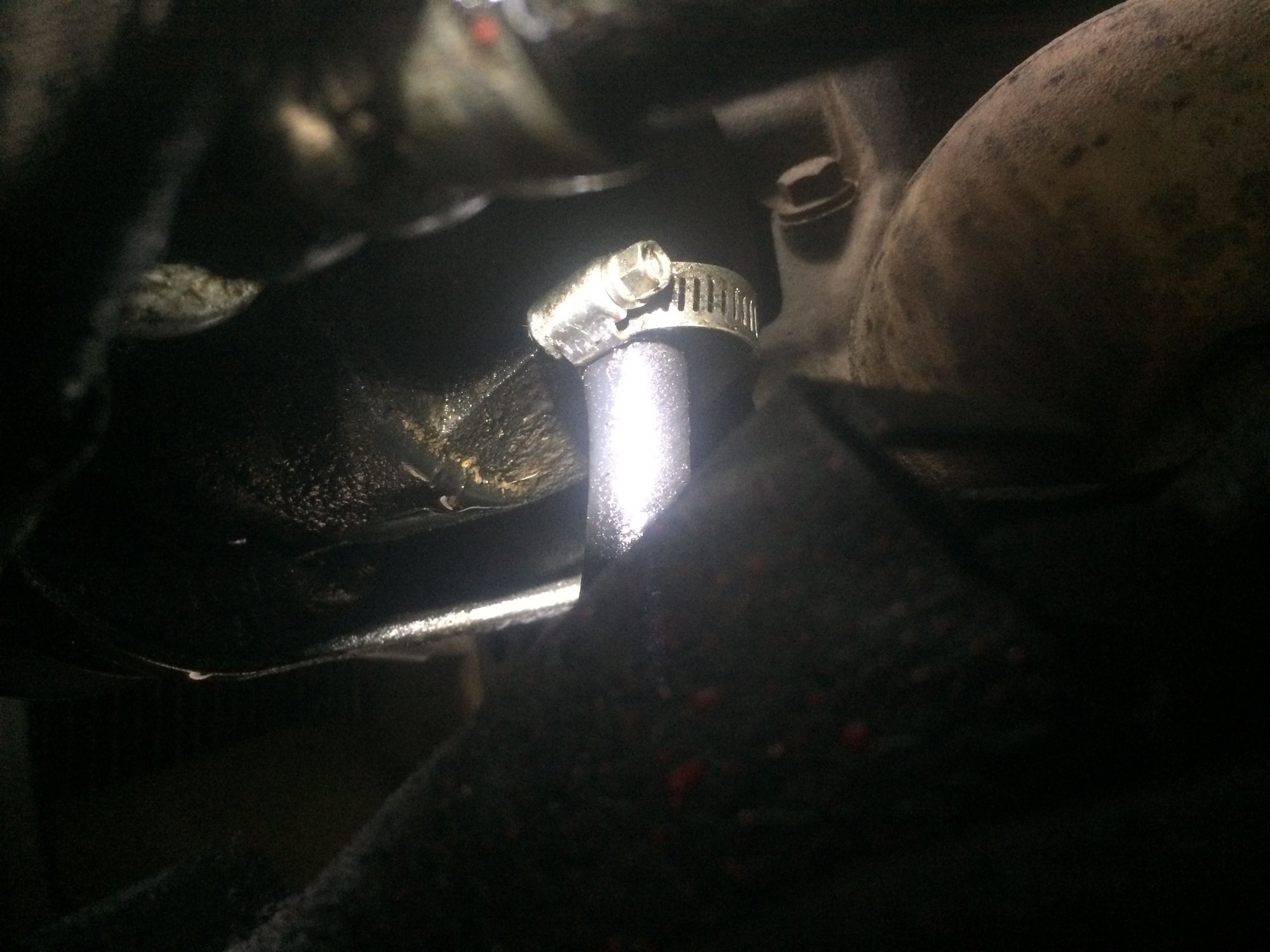

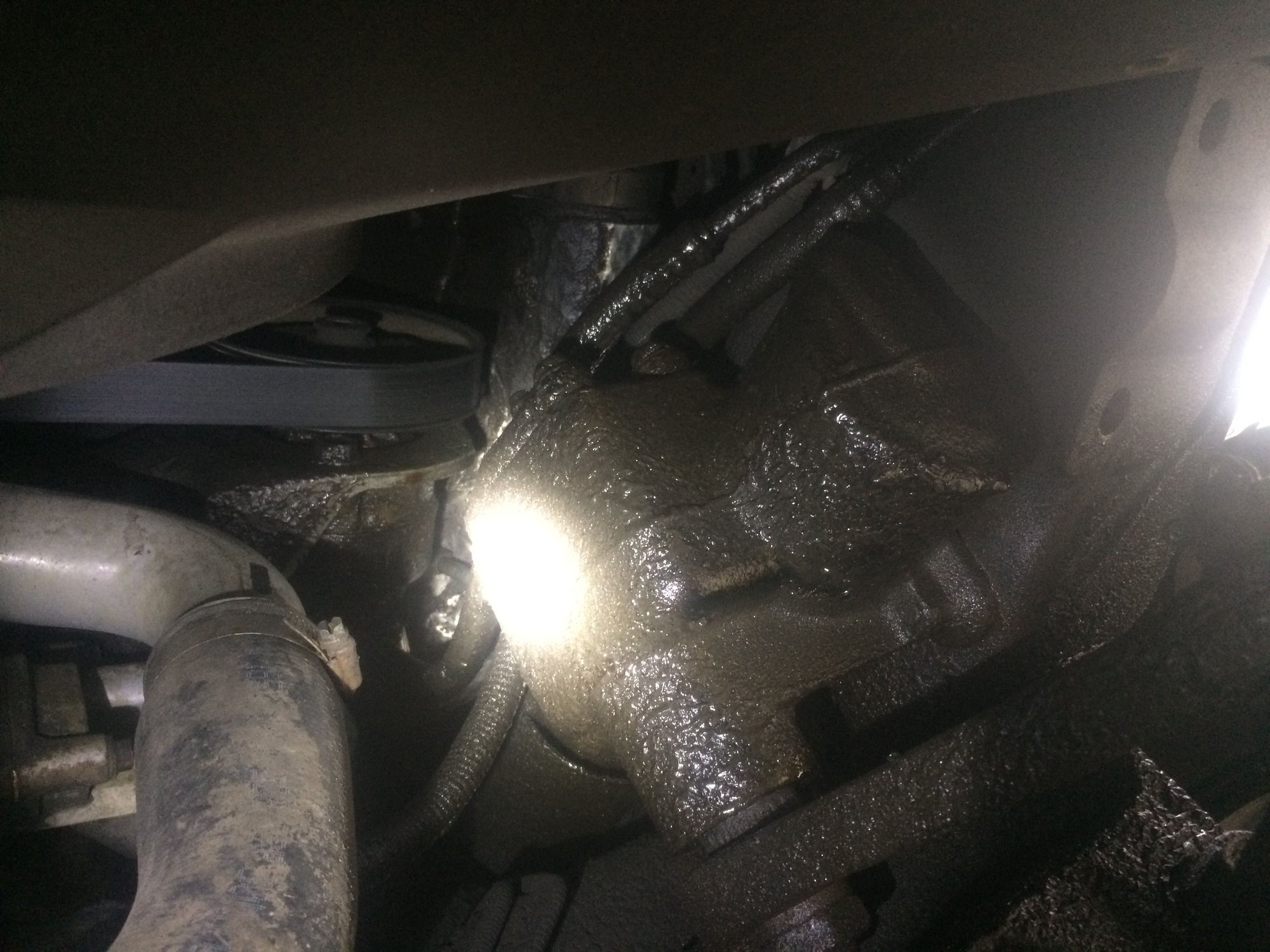

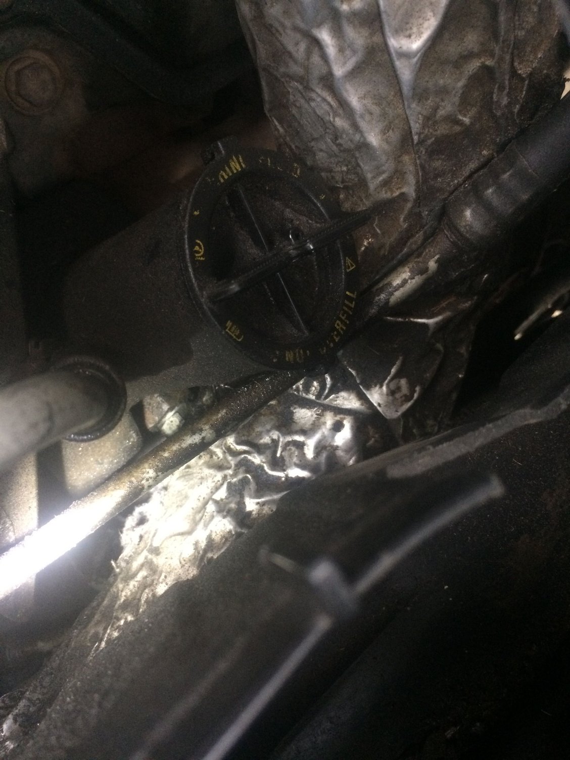

Pictures of where the leak it running down from or to at all? Sometimes that can help others that have had similar problems recall their experiences.
From Underneath
Pump from underneath
Wheelarch
Top pipes
Reservoir Connections
HP PS hose connection
Steering box??
Bottom of reservoir

The foregoing pics are before the clean up, I assume.
I suggest cleaning everything up thoroughly, filling the reservoir to the correct level, and making no other change for a while. Just monitor once or twice a week for the development of red wet spots. What gets wet first will help pin point a problem, if you still have one.
One possibility is that you may not. You recently had your front axle worked on. Not once, but twice, the second time for the shop to repair the mistake they made during the first time. The point is, whenever the front axle or ball joints are being worked on, from time to time it becomes necessary to swing the steering linkage to the left or right in order get it out of the way or position the knuckle bores in line to remove and replace the internal axles.
Whenever the steering linkage and gear are moved without the truck running, the Ford CII pump pukes steering fluid all over the driver's frame rail and steering gear. The fluid squirts out of the breather hole in the power steering reservoir cap. I noticed that your breather hole was quite clean, compared to the muck covering the rest of the cap. The relative cleanliness of the tiny breather orfice suggests that it was recently used as a squirt nozzle. Fluid can squirt all the way up to the hood liner insulation, when the steering is moved without the pump turning.
I know this to be true from personal observation... while manually manipulating the steering linkage from under the truck, and, from involuntarily having to drive the truck home without a serpentine belt. It was the latter experience that taught me just how far the fluid can fire out of that little hole. I have an oil spot on my hood insulation just above the fuse box.
So, the oil mess that you are witnessing may or may not have had anything to do with your long trip... depending on the timing of when you actually looked for the mess, and the time that work was last done with or on your axle. Not necessarily a diagnosis here... but just another possibility of causes for you to consider.
