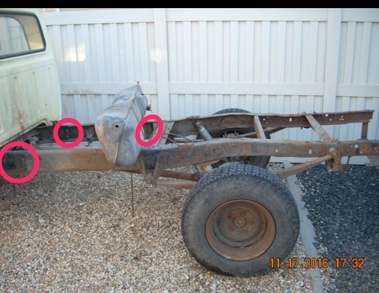

Here are some pictures. I have ground around on the frame and I can't find an area that was extended or welded on.

Upon closer look, I see weld joints in 3 places and I assume the 4th is simply hidden by the fuel tank.

There are no weld joints. The frame as I said is solid, unspliced and original looking. When I bought it I noticed that they had added fish plates to the inside of the frame. I asked him about it and he said that they had a feeder mechanism of some sort on this thing and that they braced the frame with these plates. Again, I ground around on the frame with a flapper wheel and can find no area where it was welded together. It's all smooth top and bottom. The vin says its a long bed (131 inch wheelbase) and that it's a conventional cab, 67 f-100 4x4. ??
