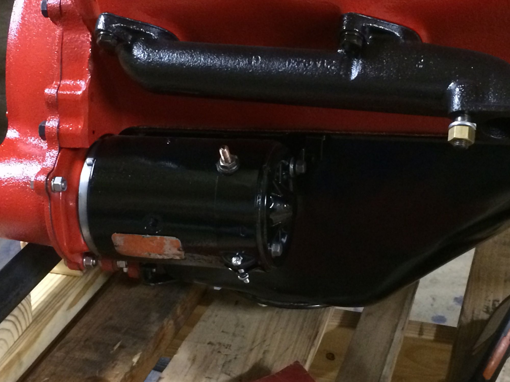

Couple of pics of the lower pan, can't even tell it's helicoiled. Got the starter on and got the bellhousing supported in the back.

Looks a lot sturdier!

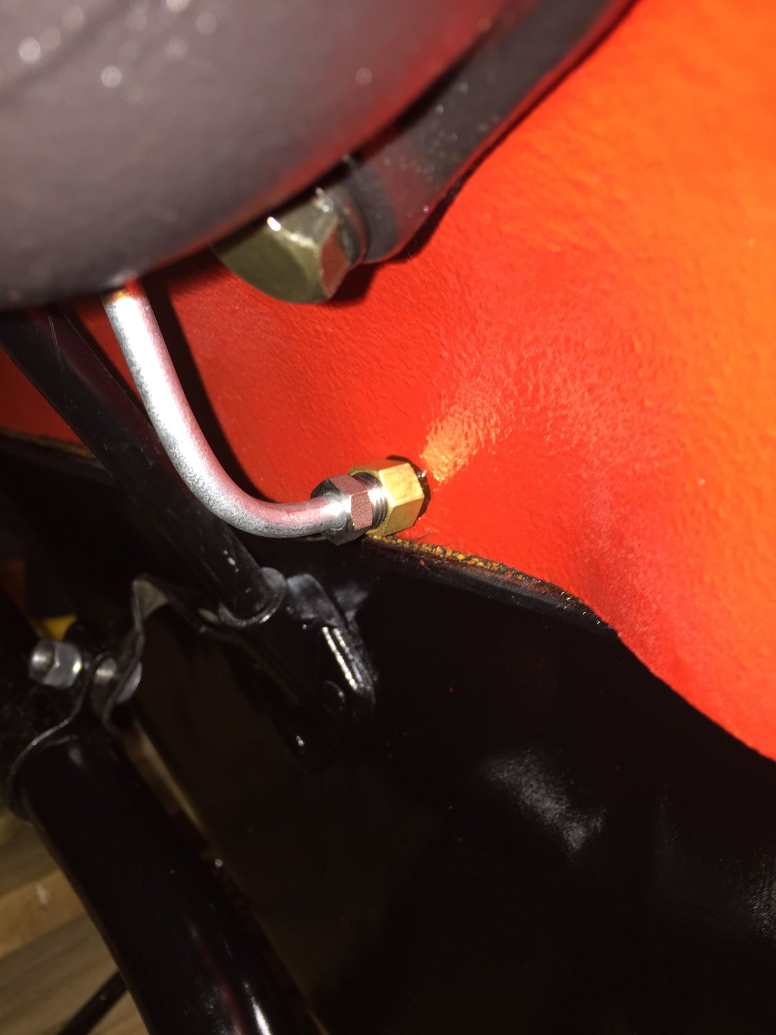

When I started the oil lines I had visions of using stainless 1/4 but that was almost impossible to flare at least for me, so I switched to steel brake line, much easier.
Wen end with the elbow on the block along with a 1/4 to 1/8 adapter and the combination let me tighten the fittings to get a good straight run. I used permatex aviation on the threads of the pipe fittings and left the flare fittings dry.
I put the restrictor going into the canister and was generally happy with the input line. The return line was tougher and I nicked the pipe with the curve tool so not 100% happy but I think it will do. I may get a new piece of line tomorrow and redo it since I have a pretty good template now. Once my canister bolt gasket gets here I think the oiling system is complete.
JB
