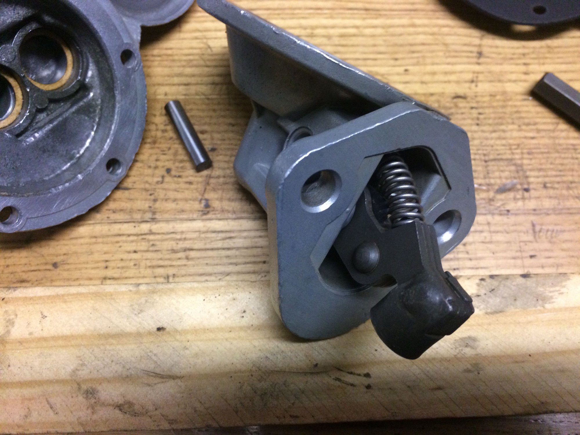

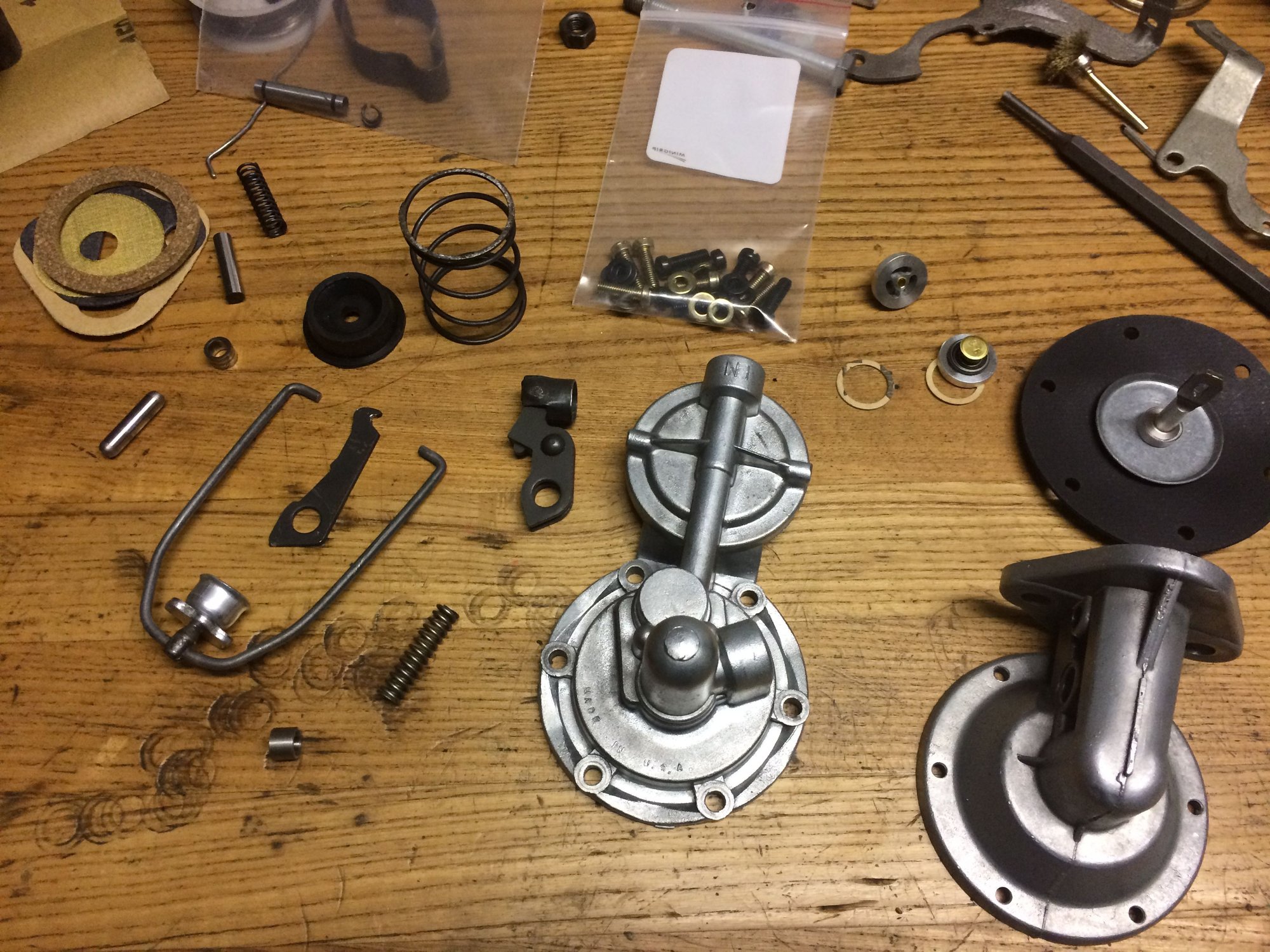

Rebuilt the USA made AC fuel pump tonight. I have been tumbling the parts in walnut shells all week and it looks better than new. Rebuild kit was from Then and Now automotive, USA made and ethanol resistant.

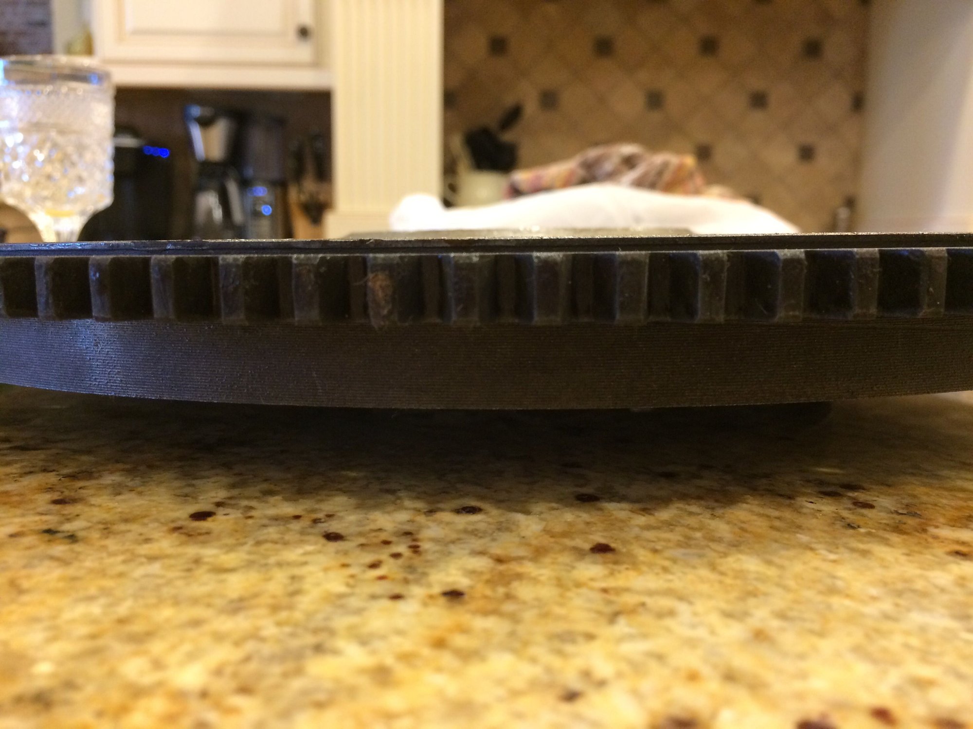

Left the flywheel in the freezer all night and this morning heated the ring to 360 in the oven per manual. It just dropped in. It's an original NOS ring and there was no taper on the teeth or on the ring (that I could find) so in installed with the FoMoCo emblem out

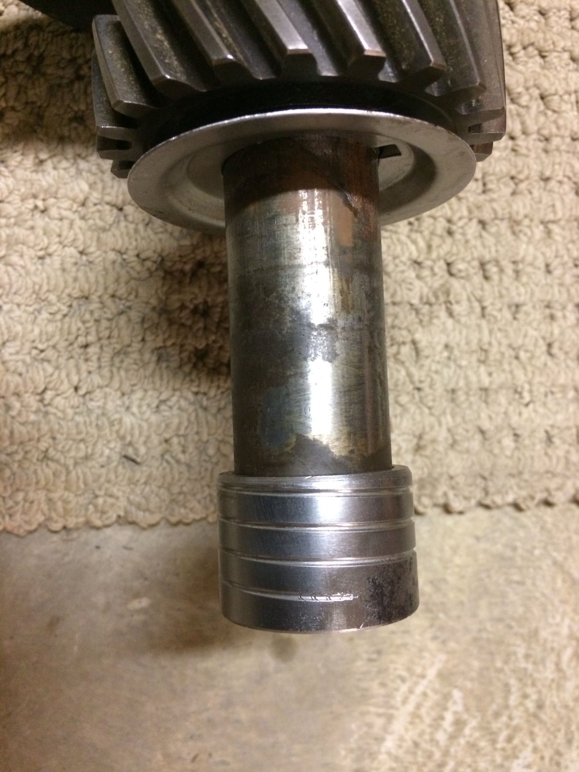

Started on the crank tonight, getting it ready to drop in. Was unsure of the crank gear install so experimented on the 8ba crank as a test with an old gear. Followed advice and heated it in oven to 350 and it slid right on, made sure it seated against journal with a 1" oak dowel. Next is the slinger followed by the spacer. Which way does the spacer go? Spiral on edge towards the journal or towards the pulley?
