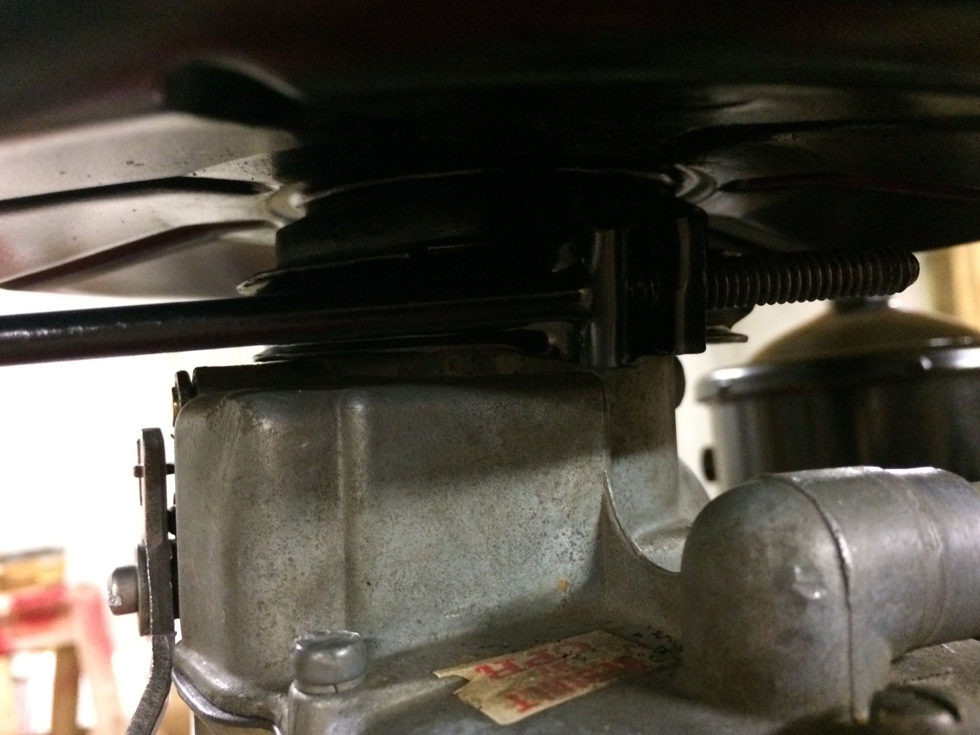

Ran out of bolts on the starter plate and had to stop. Everything is sealed off, but need to circle back on a few minor things like tweaking the steel fuel line to not be so tight and an oil canister lid bolt gasket.
I need to work on the air cleaner clamp as it's still a little loose even after tightening.
