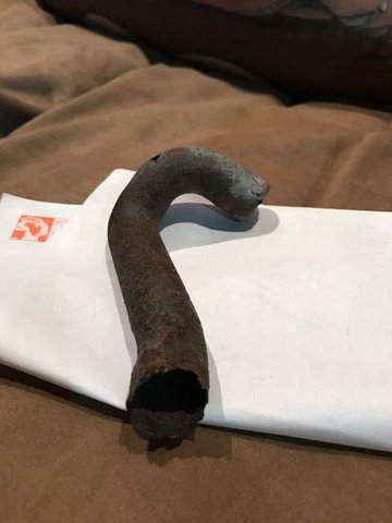

Old Dec 25, 2016 | 08:10 AM
texas2fst's Avatar
texas2fst
Joined: Jun 2014
Posts: 82
This is whats left of one of the tubes, Need 2, they go from the heater core through the firewall
Old Dec 25, 2016 | 12:17 PM
NumberDummy's Avatar
NumberDummy
Ford Parts Specialist
Posts: 88,826
Likes: 785
From: Simi Valley, CA
This is not a tube, it's 5/8" I.D. heater hose.
18472 is the basic Ford part number for rubber heater hose, 1961/79 F100/350's used 5/8" I.D. hose.
Usually dealers installed cut-to-fit bulk 5/8" hose.
At one time, FoMoCo sold an approximately 5' long 5/8" heater hose w/a preformed 90 degree end: C8OZ-18472-B / Obsolete
There are 4 of these hoses available NOS, but a similar hose might be available at auto parts stores.

How did they get from the heater core through the firewall? There doesnt seem to be a part for that.

AFAIK: The inlet & outlet tubes of the heater core poke thru the firewall. This is the way 1961/66 heater cores did.

OK. Now I understand. If you show that picture to NAPA and they can't get the part, you could make the 90 deg elbows from copper pipe fittings. Then use straight piecies of rubber hose for the rest. Or you could make an access panel there.
