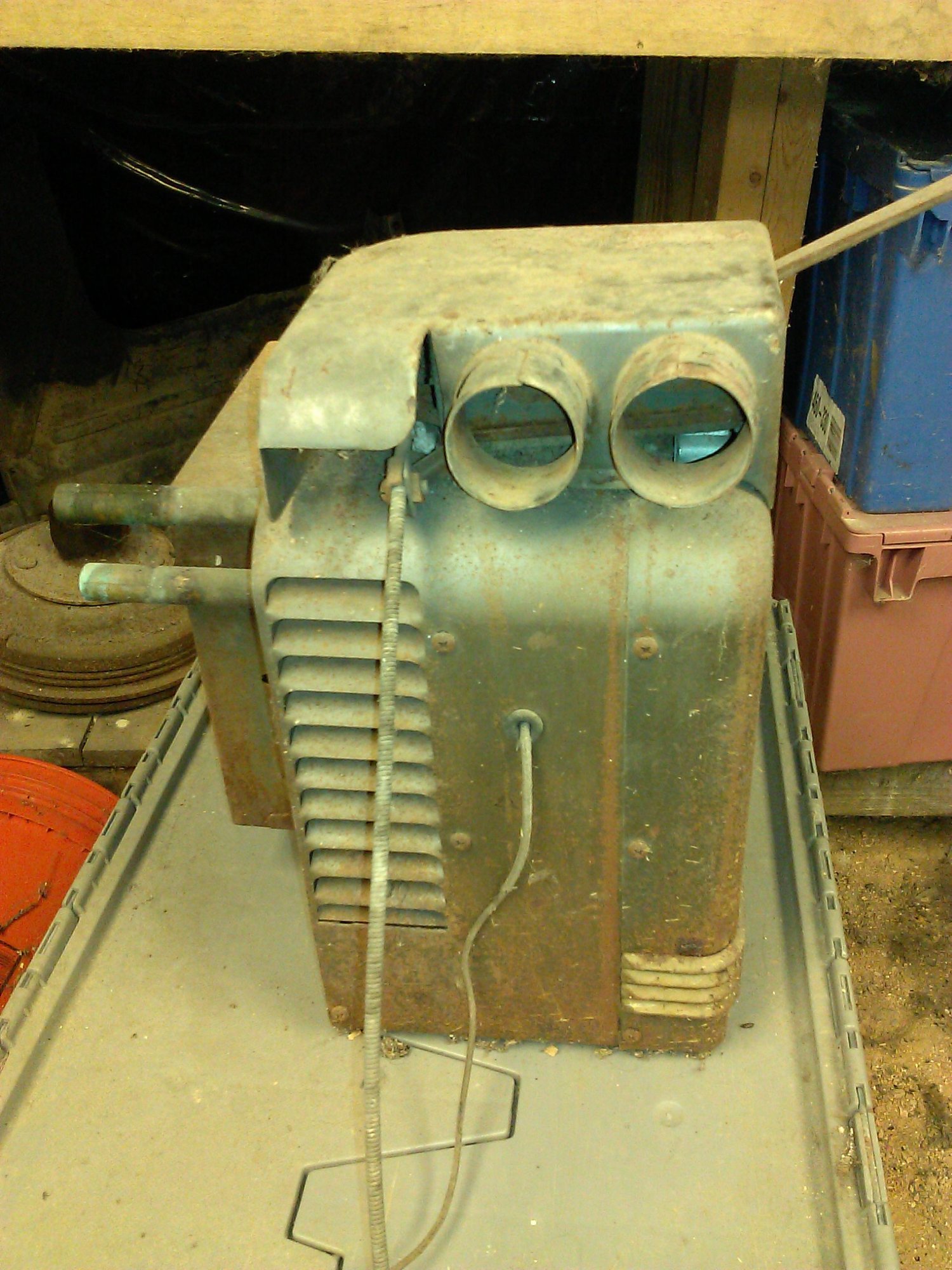

This is the heater that was in my 49F1. Does anyone have any parts for this one like front cover and heater coil. I think I may just need to find another heater to use.

No heater core for that model exists . You would have to have one made up .Those headers / tanks are 2 piece and align w/ the tubes in the core . If you are adamant about having a recirculating heater I have some core cases . The core would be the factor . One could acquire a core & have the tanks soldered on .All Magic air , fresh air & recirculating cores are all 2 1/2 " thick .

Thank You, I will keep looking for something else to use. Not in a hurry I was just going through my parts and I thought I would get a jump on this. I am not even road ready yet.
