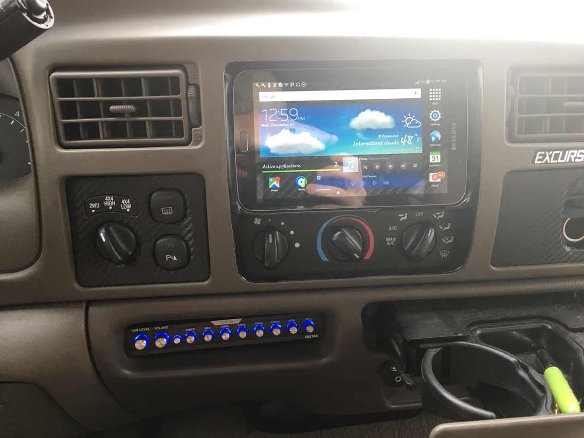

Originally Posted by Vince79vette
Here u go. Love the set up
Attachment 168321
How does the tablet stay up there? Do you have some sort of a custom cradle it docks into or something?
Old Dec 22, 2016 | 02:42 PM
Vince79vette's Avatar
Vince79vette
Joined: Oct 2013
Posts: 715

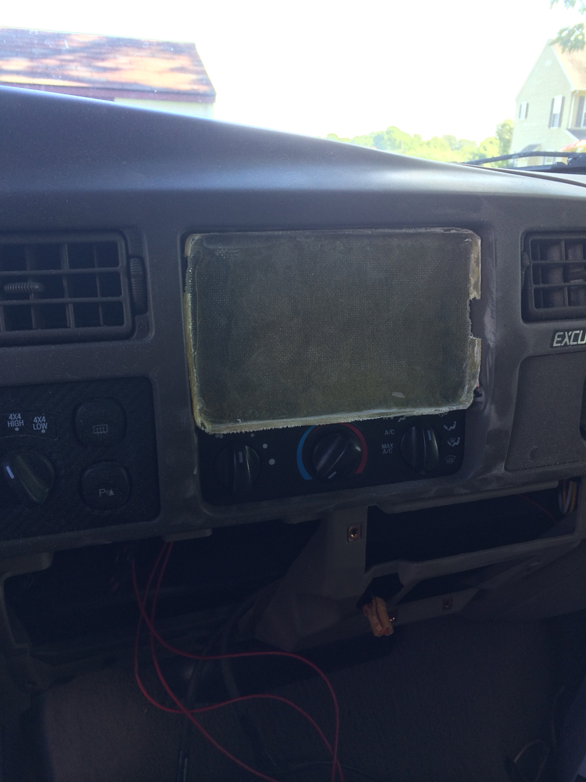

Ya what i did is wrap the tablet in foil and than fiberglassed around it to make a pod. Than i epoxyed it in. It really wasnt that hard really. Than i got it hooked up to charge off the power from the radio harness and than ran a aux cord to the eq and than went out to the amps and speakers. Full navi and music and pandora and games and internet. I also have it linked to my comcast so i can watch tv or shows when waiting for ppl Name:  photo809.jpg
