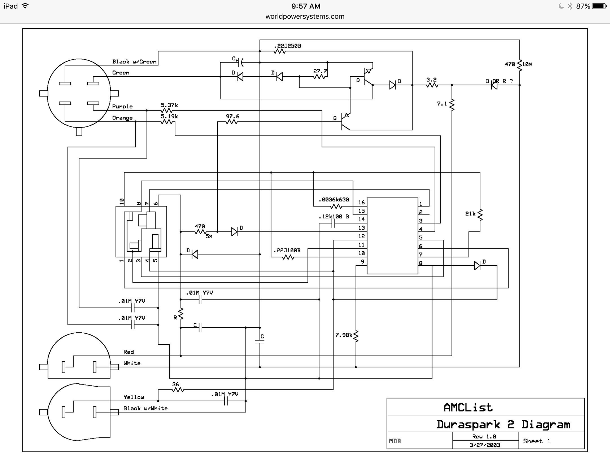

Years ago I found a schematic(reverse engineered) of a DS2 modal. Windoze crashed on that computer and I lost that file.... never did find it and I have tried!
Next time in the JY if I find one that oozed out the sealant, I might grab it and reverse engineer it.....
I remember it was not a complicated circuit and used basic transistors,resistors and ect.

Like Eddie, I've seen a schematic of a DSII module before.
Maybe it would take a trip into the wayback machine to find it but I think if it existed on the web it didn't vanish completely.

Found these images. Now can anyone make heads or tails as to all the components?
