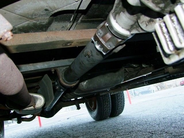

Since last Fall, the biggest improvement has been adding a Gear Vendors overdrive, documented in my "Learn my some Gear Vendors" thread. This improved the highway behavior a whole lot.
My shop went ahead and made a new driveshaft as well as moved the hanger bearing crossmember.
And lastly, I had to fiddle with speedometer extensions a little in order to get the speedo cable fitted up - it involved a 20" generic square-drive extension which was not included in my used GV setup.
