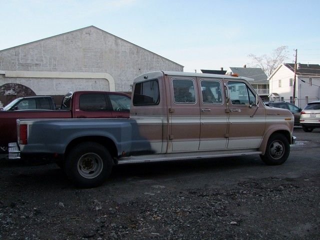

Bit of help with "truck words"... What is this fairing/cowling thing called, and does anyone have a favorite vendor to support? I'd like to pick one up for the Vantruck. Right now it "ends" very abruptly, so to speak. I'm pretty sure the bed is a few inches shorter height-wise than a regular pickup bed so it might need to be modified, but an example would help greatly.
I believe the most popular one of those would be a Lund "Fastback" cab fairing. They also had a "Racerback" that had a built in spoiler. But the Racerback mounted to the cab not the box. I don't think either are produced any more. And I seriously doubt they would have a direct fit one for your van/truck.
Your box appears to be wider and shorter then a standard truck box. So you might be stuck making one from scratch or having one made if you want one.
You could try to modify one but the top on one would end right across the middle of your rear window. And cutting one and raising it enough to match your roof is going to look strange without making the base longer to get a angle that looks good.
Another option might be to have one made out of tubing and then skin it with sheet metal. It depends how much you like working with fiberglass.

Thanks for the help everyone. Yeah, I'm not hankering for one, just curious if they were a common product. The bed is indeed shorter heightwise than a standard pickup bed, so all the fitment issues stated would come up.
I may pursue the headache rack option later on since it might play better with a bed mounted toolbox.
Higher priority is more than rear-tank-only range though
