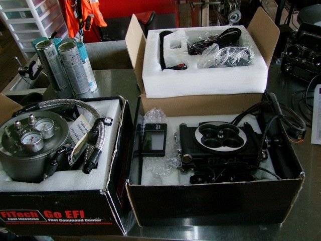

Things are starting to get exciting. I picked up this FITech rig on Craigslist the other day. Now to figure out how to install it! Anyone have some good reading material on the matter?
Specifically, I'm wondering what needs to happen to get fully electronic timing control. The manual mentions something about locking out the distributor advance mechanisms. Is this as simple as plugging the vacuum port?
Additionally, it says timing control doesn't work with "ready to run" distributors. I'm not familiar with this terminology. What type would come with an 86 460 Duraspark II system?

From: Fort Smith, Arkansas
You can probably remove the vacuum advance or lock it down so that it can't move at all. I'm guessing this is a generic kit that is designed to fit and work with any brand vehicle, so some of the instructions will not apply on your vehicle.
In addition to a vacuum advance some distributors, such as a GM HEI, have internal swing weights that physically vary timing based on RPM. It sounds like you will want to remove that feature too if it exists.
The computer will want a static timing signal and any variation of the signal such as that caused by any timing advance mechanism is going to throw off the whole program of spark and fuel injection pulse timing. If you have noticed on modern fuel injection systems, they have a toothed ring behind a pulley or on the flywheel with a sensor that sends a signal to the computer telling it exactly where the engine is with regard to rotation degrees. This allows the computer to know an exact timing sequence based on the physical position of all the engine components. On some engines Ford also uses a cam position sensor that took the place of the distributor. It still has a distributor shaft, but externally there is a simple small sensor instead of the old type distributor cap & rotor bug.
If you didn't get instructions with the kit, be sure to download the instructions and read thoroughly before you swap any parts and especially before you modify any existing parts. And don't be shy about contacting that company's support if you find something you aren't sure about. That is what they are there for. And I am sure they will enjoy knowing about this vehicle as much as all of us on this forum do.
I have a buddy that recently upgraded his old carbureted 302 to fuel injection, but he used all Ford parts from later model engines. One really cool thing I have learned about Ford is that they will overlap technology, such as the 1996 Bronco, the only OBD2 Bronco. Even if it is a short run Ford will have some really interesting "swap parts" like the first run of mod 4.6L Romeos that had the old SBF bell housing bolt pattern.

Need to disable the mechanical advance as well.
I know nothing about "ready to run" or actually installing a FITech system though...
But Google led me to this because I was curious.
The Duraspark has an external control box, right? So maybe it will work with timing control?
No real help from me so I look forward to the results!

You can tell it's been actually working lately since I haven't been on this forum! The EFI install was highly successful and I can now answer a ton of questions about the FiTech systems. Decided to use "easy mode" and not try to switch to electronic timing because of the need for a dyno to tune it. It's been nearly 500 miles since going EFI and I have not dug around under the hood a single time.

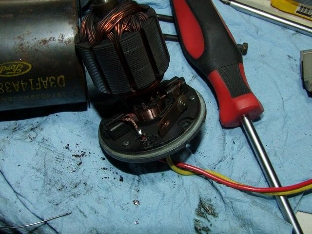

And pulled off a power window motor rebuild because right after installing the EFI rig, it of course has to offer me another problem...

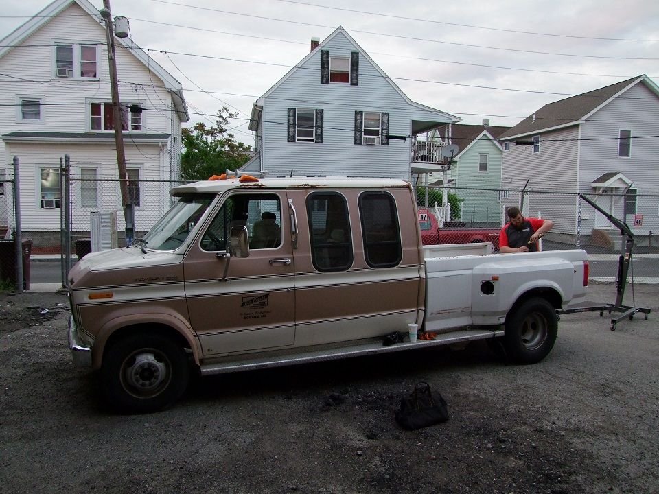

Here it is on a test drive trip to Lake Whatever-the-Hell, around 160mi round trip, 9.5mpg the whole way Shows the better-aligned bed now.
