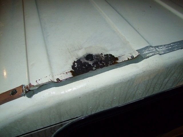

First, while doing some minor rust-picking, I found where they joined the van halves! They make it look easy - make I can make my own vantrucks now.
This has been shown post wire brushing and treatment with rust converter compound. The seam sealing goop is universally deteriorated, so on the docket once it warms up is a full teardown and cleanup of this whole circumference which seems to be hiding other rust spots.

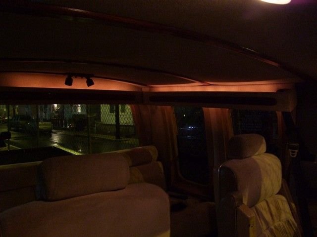

The "MOOD LIGHTING" was seemingly cut beneath the dashboard at some point - it has been reunited as part of the body lighting circuit. I will likely replace the christmas lights with LED strip in the future.

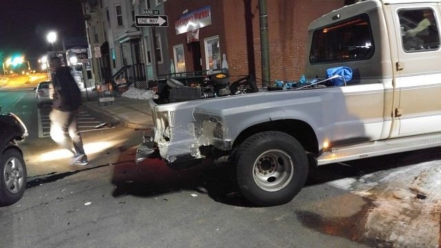

The universe does not like this rear fender!
A few days ago, I was carrying equipment back to the shop when it got rear-ended IN THE EXACT CORNER THAT WAS REPAIRED!
(You should see the other guy though...)
So things have gotten a bit more real; my mechanic says this time it's gonna be unrecoverable and I'd have to find a new bed. While it's waiting for an insurance company visit there, I'd like to start researching solutions.
