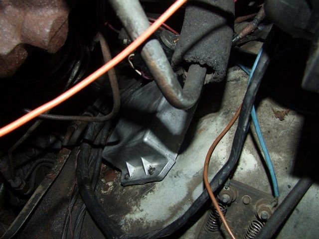

First though, the selector valve was indeed malfunctioning, so it was a compound problem. You know up there where I said I knew it was working? That ended up being BS. It seems like the contacts that move inside are old or worn, so some times it did not move properly and hence would end up in the wrong position (But I hear it toggle, so "it works!)
So at least I have a new selector valve:
That didn't fix the problem though. Next up, what had happened was when I replaced the fuel pump and replumbed the selector valve assembly, I didn't put inline filters on the lines... Not having a lift or crane (& having to work all on the ground) meant I never got a good look inside the front tank, and the rear tank's condition is also unknown to me. Also, ******* brain fart mistake.

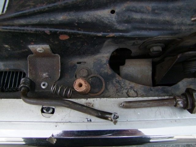

Basically I discovered this condition when I did a fuel volume test on my own and noticed the fuel was heavily discolored and had a huge amount of sediment. I then ran to buy the biggest inline clear filters I could find at Autozone. Here is the hot garbage that ended up in the front tank's filter after only ~20 minutes of running!
And then I ran around to pull the carburetor inlet filter (the little metal sponge). You can SEE the crud in it. And also the fuel hardline I sheared off trying to unscrew the wrong thing:
So then the truck ran great. And has been running great. I went and did about ~50mi of highway driving, making sure to do repeated offramp-onramp full throttle pulls. The carb is obviously not tuned since my mechanic never got a chance to properly road test it - currently seems to run a little rich and likes to backfire a little. I'll probably have him do a final tune....

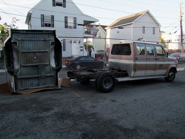

Ladies and gentlemen,
Took 4 of us about 6 hours to fabricate the new bed rails, rig it up, test the fit, edit the rails, test it again, edit some other parts... But it's bolted down solid now!
Needs a few frame spacers up front to line up the bodywork, but my nightmare is finally over.
