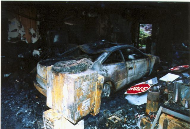

Originally Posted by Yahiko
From the looks fo it I would lean towards the brake rotor and overheating.
One other thing about fires that a lot of people forget is the leftovers
STINK BAD
This is how I know that.
What you don't see is my Little truck and the Explorer. Both took weeks to get the smell out of
and neither of them were that close. That smell just gets into EVERY THING and is hard to get out
of the duct work. I ended up using stuff you use in a building fire to remove the left over smell.
Took the full can to do both trucks.
BTW the car that was in the garage was a Toyota. It burned the tires off of it.
Sean
6.0L Tech Folder
That was a Solara, right?
Yep and the key word is WAS.
Sean
6.0L Tech Folder
What year and what happened? I have an 02 that was my commuter car until I ended up with a company van that I take home.
1999 or a 2000 I think. Might of been older just not sure.
The fire was in October of 2001.
Sean
6.0L Tech Folder
Wow. I've had mine three years, it's an 02. Never had any issues with mine. It had 95K when I bought it. Now it has 140k on it.
