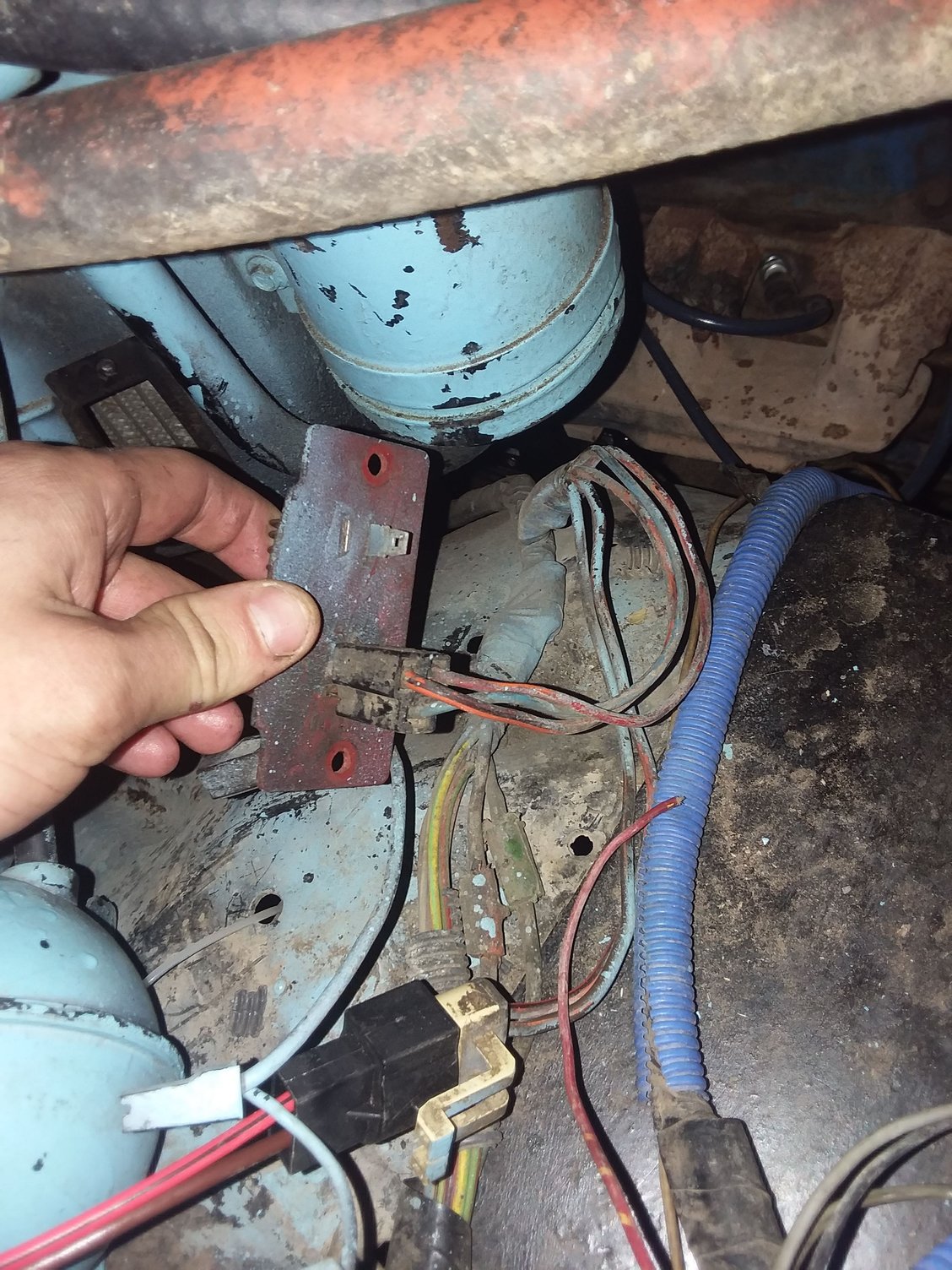

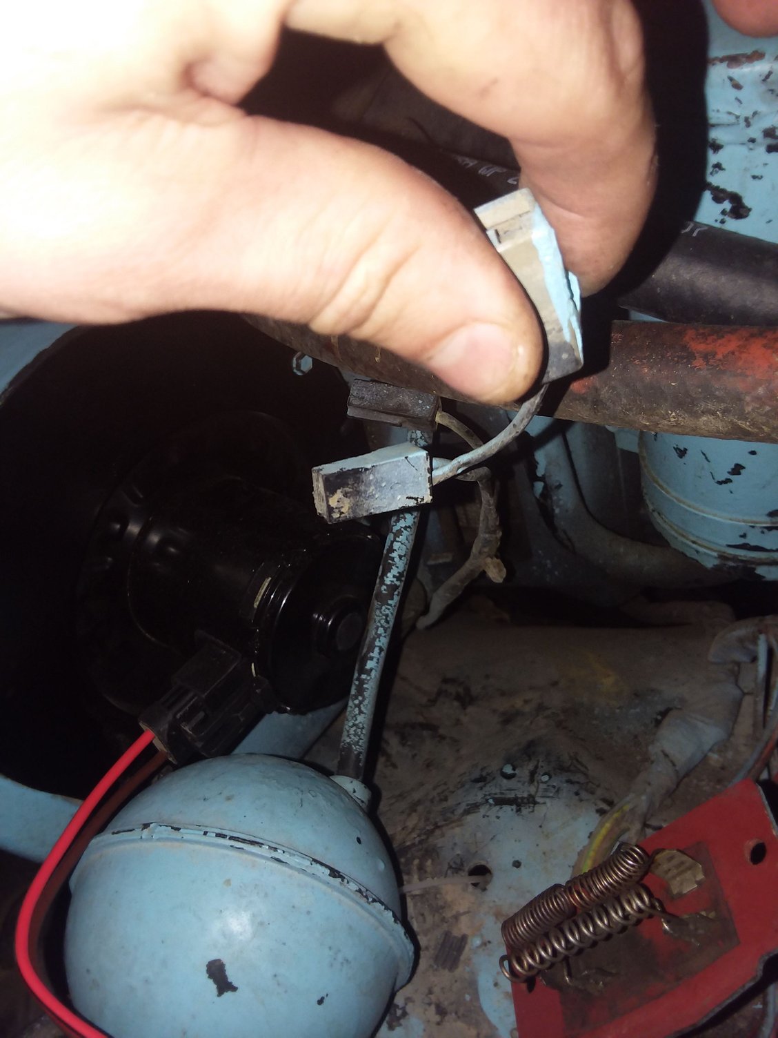

Trying to figure out why the blower isn't working on my 85 f150 351w. I put a new blower motor in and looked at the old blower motor resistor. The bottom cable is connected but I can't find the cable that connects to the single top post. I found a dorman replacement with that cable is it just a ground?
it used to have a.c. and has extra plugs everywhere just need to figure out what that top post is. If the resistor doesn't fix it I'm thinking heater control switch in the cab maybe?

That single one is used with air conditioning, I think it was part of the system that turns the blower on Low to keep the evaporator from freezing curing certain conditions.
Look at the EVTM for troubleshooting hints:
A/C & Heater - ???Gary's Garagemahal
