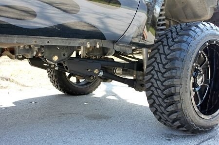

Some pics that pushed me to get the 3.5" kit versus 2.5"
All have 37" tires i believe besides the white platinum he's running 35s
so mine will look identical to that if i go 35s
None of these trucks or pics are mine all off the web
