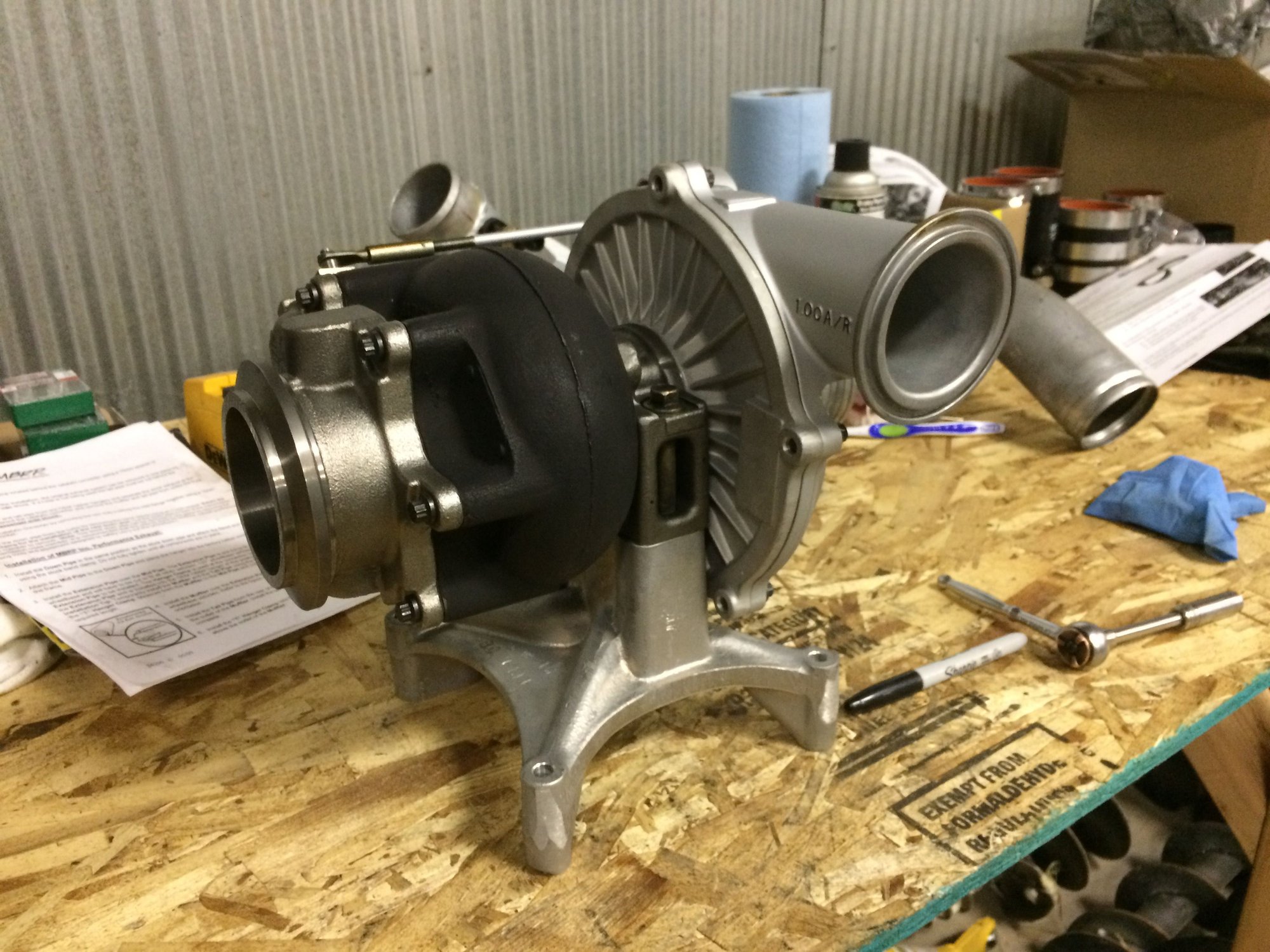

So, I'm about ready to start putting things back together. Wondering if there is a best/easiest order for the following:
  1. Up-pipes
  2. 4" exhaust(anyone have the length of the section that needs to be cut for cc standard bed?)
  3. turbo & pedestal
its a short list, but I don't know if it's easier to have the the down or up pipes in place first. Pretty sure doing the turbo last is the right call😉
Prepped turbo & pedestal

Turbo looks nice, you did a great job. That is identical to how I painted mine when I removed it last year.
Based on my own experiences, I would go 2, 1, 3. I waited to do the downpipe 4" exhaust for last and it was a pain in the ***. If I had more room up top and next to the up-pipes I would not have struggled with it nearly as much. If you leave the downpipe loose you can move it out of the way if needed to mount the up-pipes, but the passenger side should already be tight by the time you get it in there.
Let us know how it goes though and we look forward to more pictures.
Thanks. I was thinking the same thing on the order based on what a PITA it was trying to get the downpipe out before I just removed the old up-pipes. I've been trying to keep a journal, but it's been hard with work getting in the way.

Definitely #2 first!!! (as Sous recommended) I used a small bungee to hold the top of the downpipe while I installed the exhaust.
Then 1. Leaves plenty of room to get the uppies started. Working at the back of the engine is hard enough even when the turbo and pedestal are removed.
Lastly 3. Set aside some time for this. I probably spent 30 minutes just trying to line up the nipple on the baby's butt to the turbo. It's just luck to get that sucker lined up.

I ended up calling an audible. Did the Ups first, then down, then turbo assy.
if I had a stock length down then that would def be first.
Finished up up this evening. I'll work on my write up w pics this week, time permitting. I'll post my purchase list and thoughts as well.
