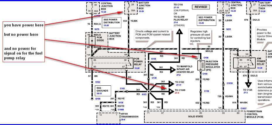

I think you still need to check the cab fuse which powers the PCM relay in the engine. The reading shows the PCM giving the ground signal to the fuel pump.
The arrows are not mine but part of the thread I found..
Try going through this troubleshoot I found on the net:
200 ford f550 superduty 7.3L powerstroke: We are having trouble

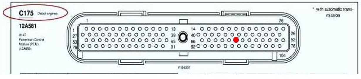

Using a Scantool or Bench Testing Unit. But, from your writings, It probably won't connect with the PCM. You can check the 12 (+) Pin in the Harness to see if it's getting power. I'll look up the pin# for your truck.

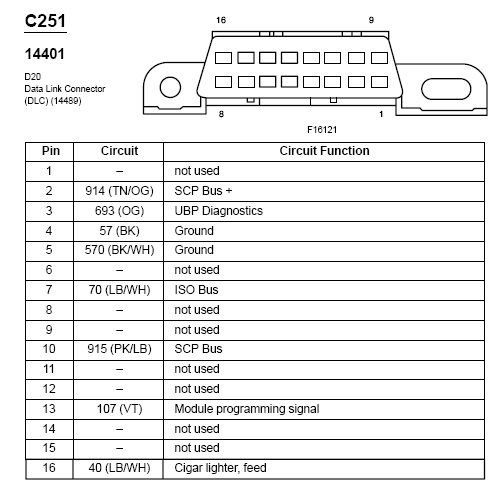

Use my light tester it lights up on plug #16 on the DLC. I'll check the pin 71 as soon as I get the PCM off
I just hooked up my volt meter and it getting 11.98

Update...I'll have to wait till tomorrow when I get an extra hand to hold the PCM harness so I can plug my volt meter in and read pin 71 see if its getting power. I do know if I have the PCM connected I get a ses light but if it is not plugged in I get no ses light. Makes me think it is getting power.

I have not tested the 71 pin on the PCM harness but I'm betting it is getting 12v
So I'm guessing the PCM is getting power but sending a bad signal...am I correct with this assumption
