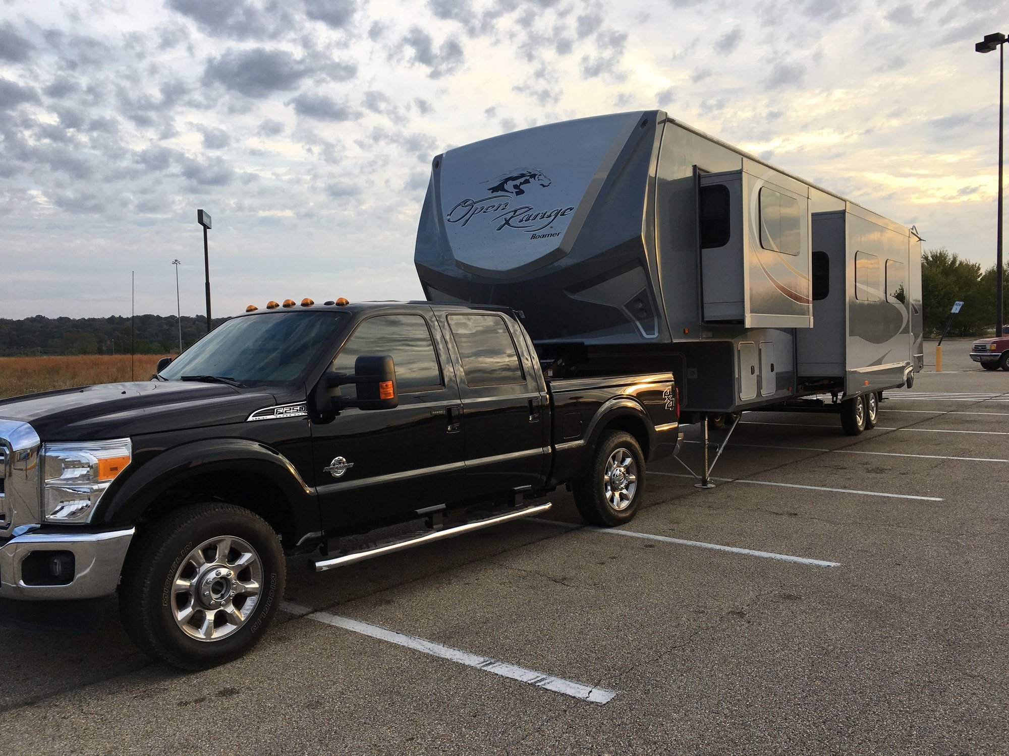

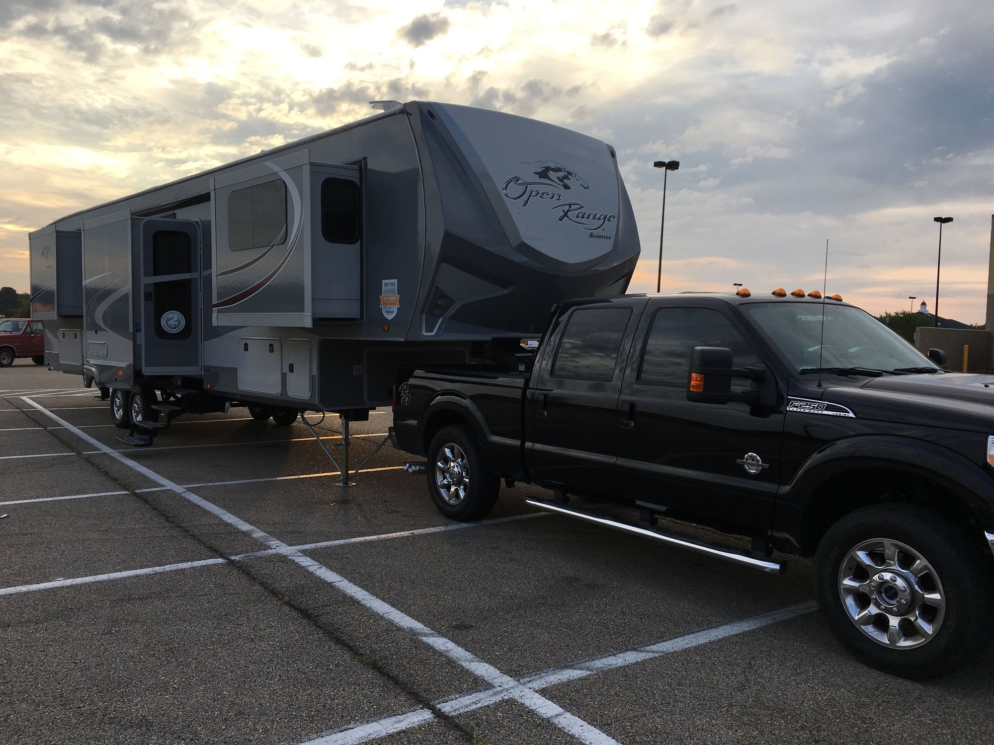

I get to the place and we look at a lot more floor spaces. I make a few more calls to some guys that tow for a living. They told me I could do it. So I did it. 400 miles later and I'm towing perfect. Straight as an arrow, no sway, etc. I've never towed a 5er. Only trailers and boats. This has been such a relief. About to leave the Walmart parking lot and head the rest of the way home.
I did squat 2.5 inches so I will get the airbags.
But seriously. I have so much more control. And I am just at 11 mpg when flat. Just around 10 through the Ozarks.

I think most answered my question with, "it's up to you". I never felt like I did not have enough power or that I was in danger of losing control. However, I always felt it back there. I did test out the power that I had left over a few times. I hit 80 going up a few inclines.
Where I think it really comes up to us is if the transmission fails? And the tires will wear out faster I guess? I think people just like the peace of mind with those DRW's. Most DRW's passed me as opposed to me passing them. I think that says a lot for comfort level. Also, I was keeping an eye on that turbo needle. I knew i was drinking fuel when it was passing the 1/4 mark on up to the 1/2 way mark. So I tried to not cross the 1/4. That kept me around 65 mph. The DRW's seemed to cruise 70 and higher. I personally think that's what we're talking about. The ability to drive it like it's supposed to be driven. Not babying it along. Although, I'm perfectly happy cruising at 65 with an eye on that turbo needle. I'll also say my temps never even hinted at going too high. Trans would go from 198 to 208. Oil.....it got a bit higher. Like 210 - 218 I thing? That's my 2 cents. I do need to get airbags though as I'm squatting 2.5 inches.
