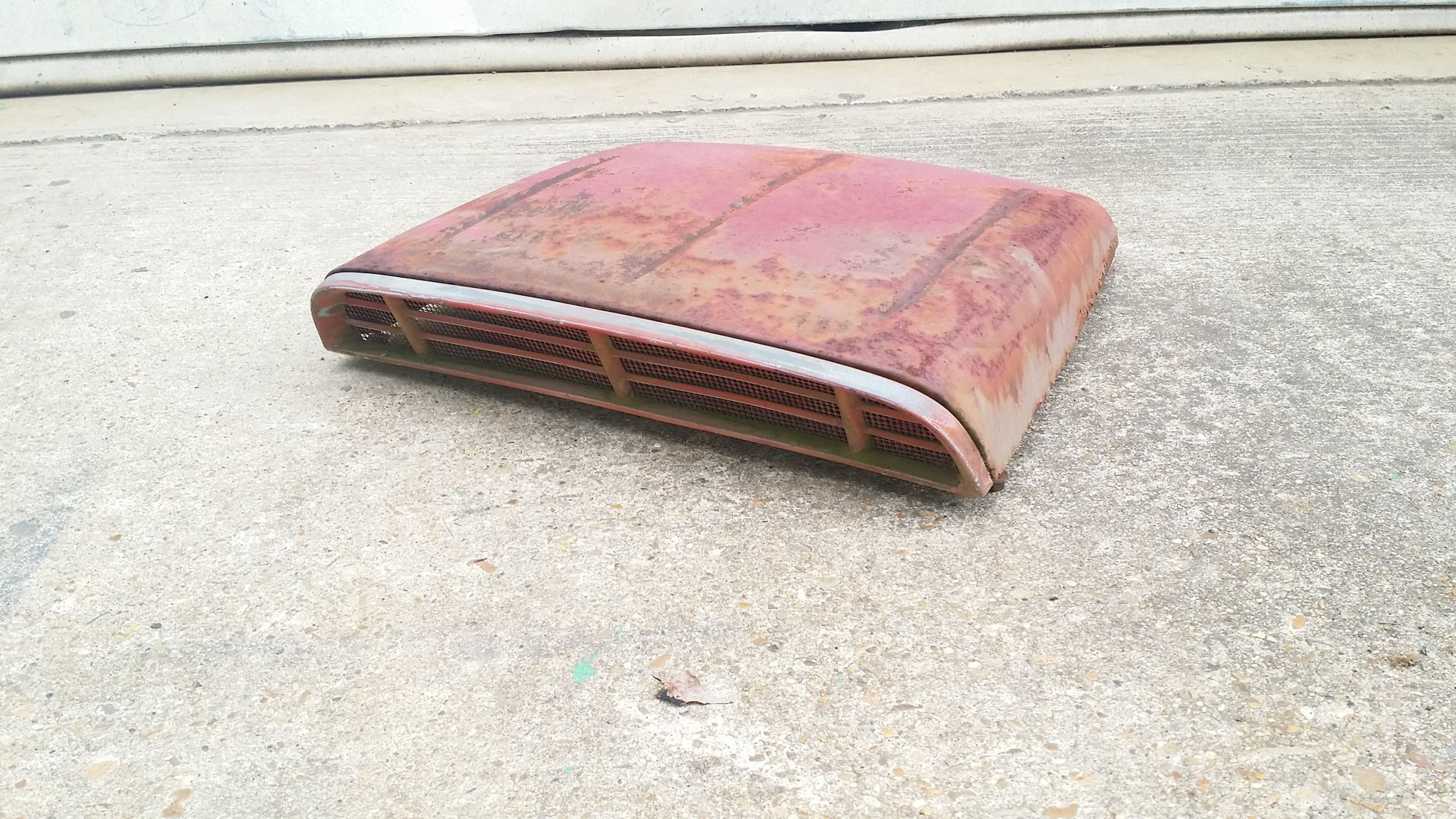

In April of last year, someone was looking for a Ford F500-up big truck instrument cluster and I replied to say I knew where several were. I pulled 4 of them and ended up selling 3 out of the 4 clusters.
This is one of the trucks I had pulled one of the clusters from back in April, 2016 ('68-'72 F7000 with a diesel engine). --notice what's on top of the hood.
Before today, I hadn't been in this wrecking yard since that day in April, 2016. I had been thinking about that factory steel hood scoop lately and wondered if it was still there(?). I went back today to investigate and it was.
While I was there, I found 2 more Bumpside F600 instrument clusters that I grabbed as well, since it would be a shame to see them go to the scrapper.

Congrats on your score Steve. Note, that hood will also fit our pickups.
Ford used part number D0TZ16612A to replace 67/72 B,F100/750.

Unfortunately, the hood was pretty cancerous with rusted through places all over it.
....turboed, fuel injected, cowl-induction, small-block V-8, here we come.....
I don't know if I would actually do this or not. It's really just a matter that I set it on the hood mainly for $#!+z and giggles. .....but, you never know what I might do.....

Here's an idea that might make up your mind. Years ago I had a 79 Trans Am. Those reverse shaker hood scoops are fake. Blocked off on the exterior but Pontiac did give them a large O.D. air cleaner body and a mini top. So I cut mine open. Then I formed a door and hinged it on the bottom. Now to make it move I mounted a Holley vacuum secondary diaphragm pot to the under side. Installed a nipple in it to hook up a vacuum line to it. Hooked that vacuum hose up to venture vacuum on the carb. So the door I installed moved as with my foot on the accelerator pedal.
Not such a good idea in the rain though.

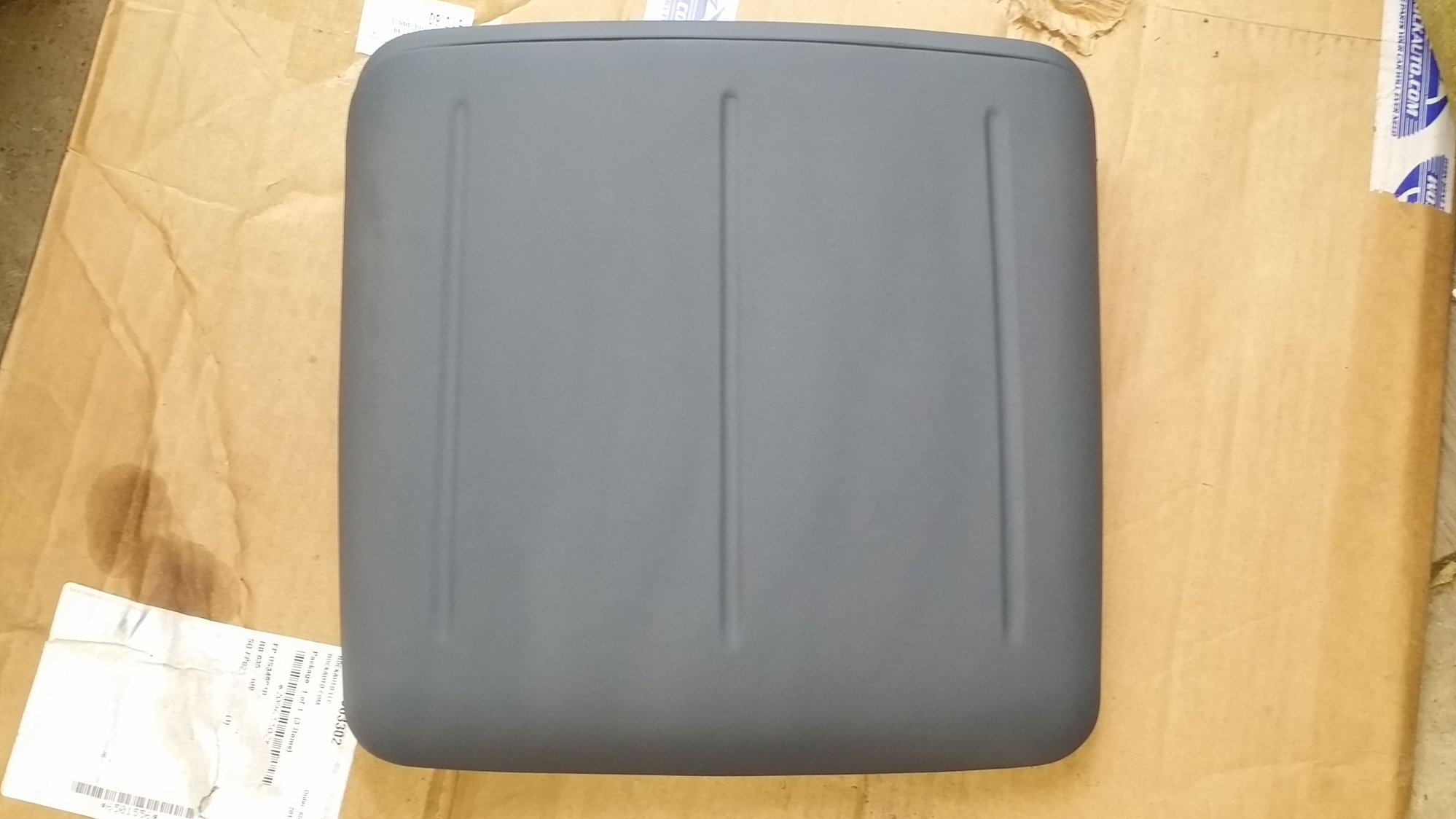

I bead blasted the old paint and surface rust off of the scoop and put a coat of primer on it to protect it from rusting any further.
In spite of trying to be very cautious not to break any of the studs off, when removing the nuts from the rusty studs, one broke off anyway.

did you make a template off old crusty hood so you know where it goes ?

After I got to the wrecking yard and removed the scoop, I was going to take photographs of the hole layout, both on top of the hood and from the under side. However, once there, I realized I had left my phone back at the shop (Doh!).
I'll have to go back out there with some cardboard and trace off a pattern and get photos of it too.
This F7000 has been out there for several years. With my luck though, they'll crush it this week, before I can get the pattern off of it.
