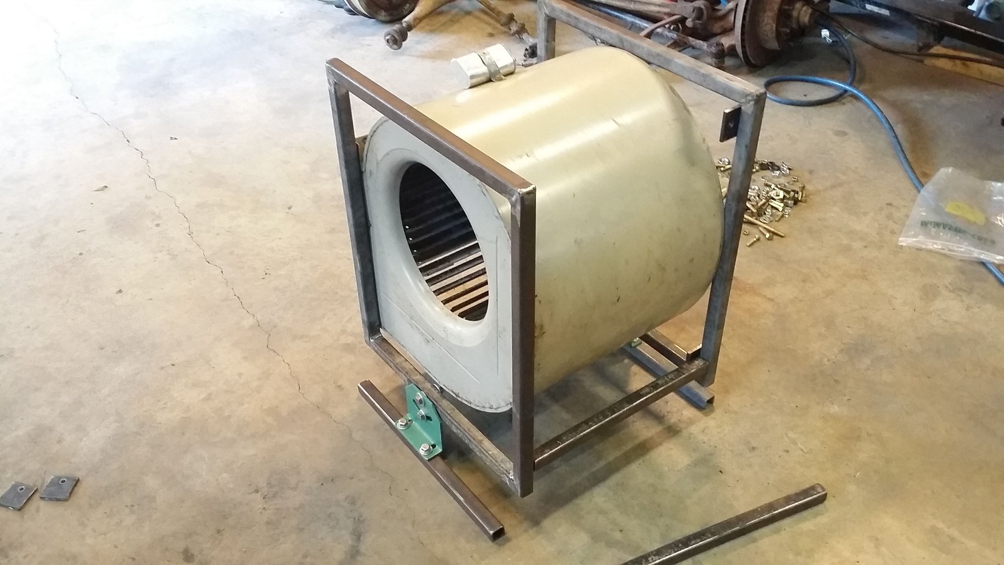

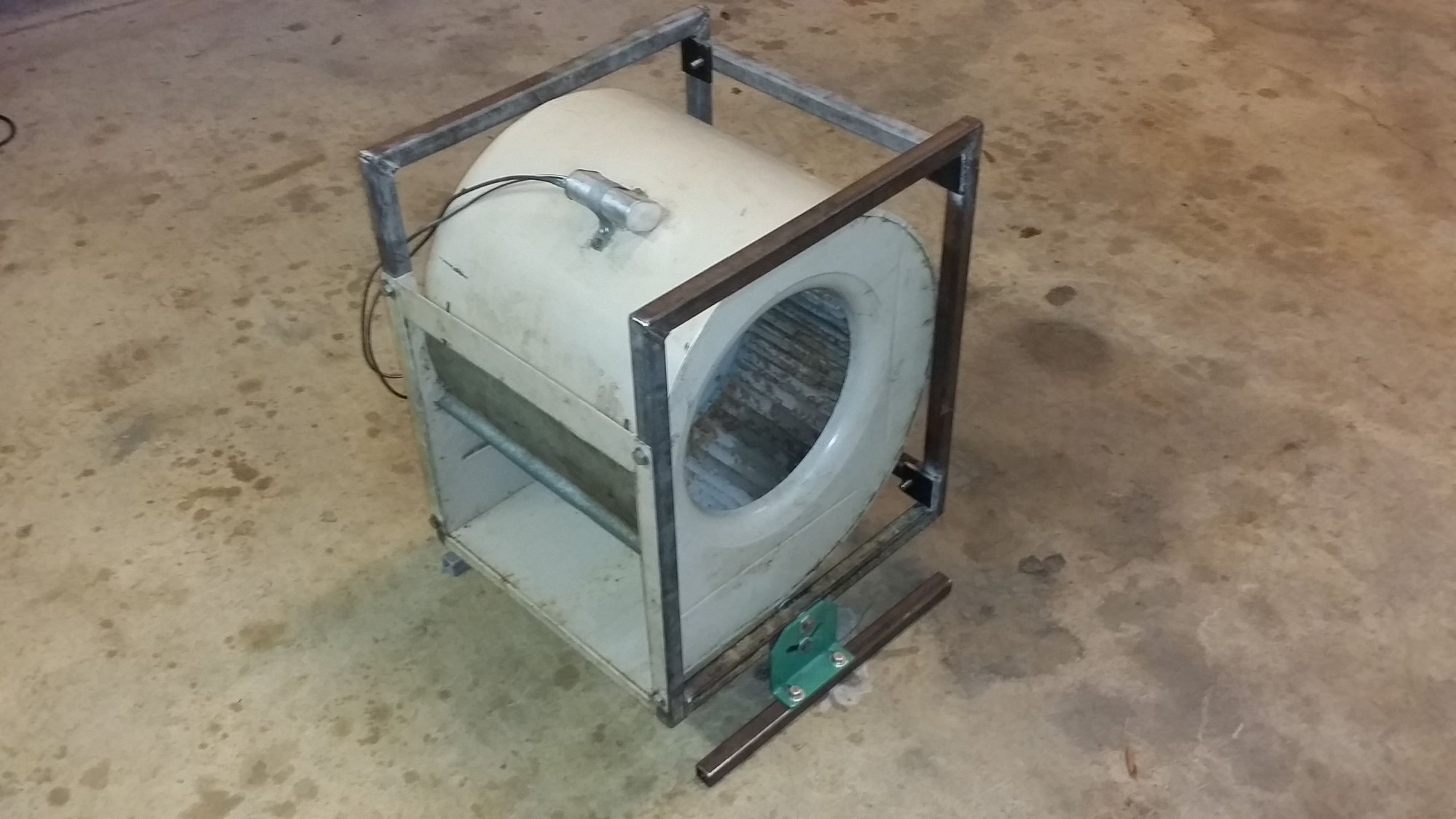

I just got through finishing up with making the remaining frame pieces and assembling them onto the blower housing --still needs a power cord and a speed selector switch but, it does work.
It won't do anything about the high humidity here in the summertime but, it should make it more tolerable in the shop when I'm working on the Bump.

Good idea putting the slots in those brackets.
The slotted 'tilt' bracket on the landing gear is the only pre-fabbed piece on the blower framework I made. It was a component from some surplus conveyor parts they were throwing away at work so, I grabbed them.
Just prior to finding these brackets on Tuesday, I was trying to figure out how I was going to make the blower/frame tilt. When I saw these pieces about to go in the scrap metal dumpster, it was clear I had found the solution of what I could use to do this with --the best part is they were free too.

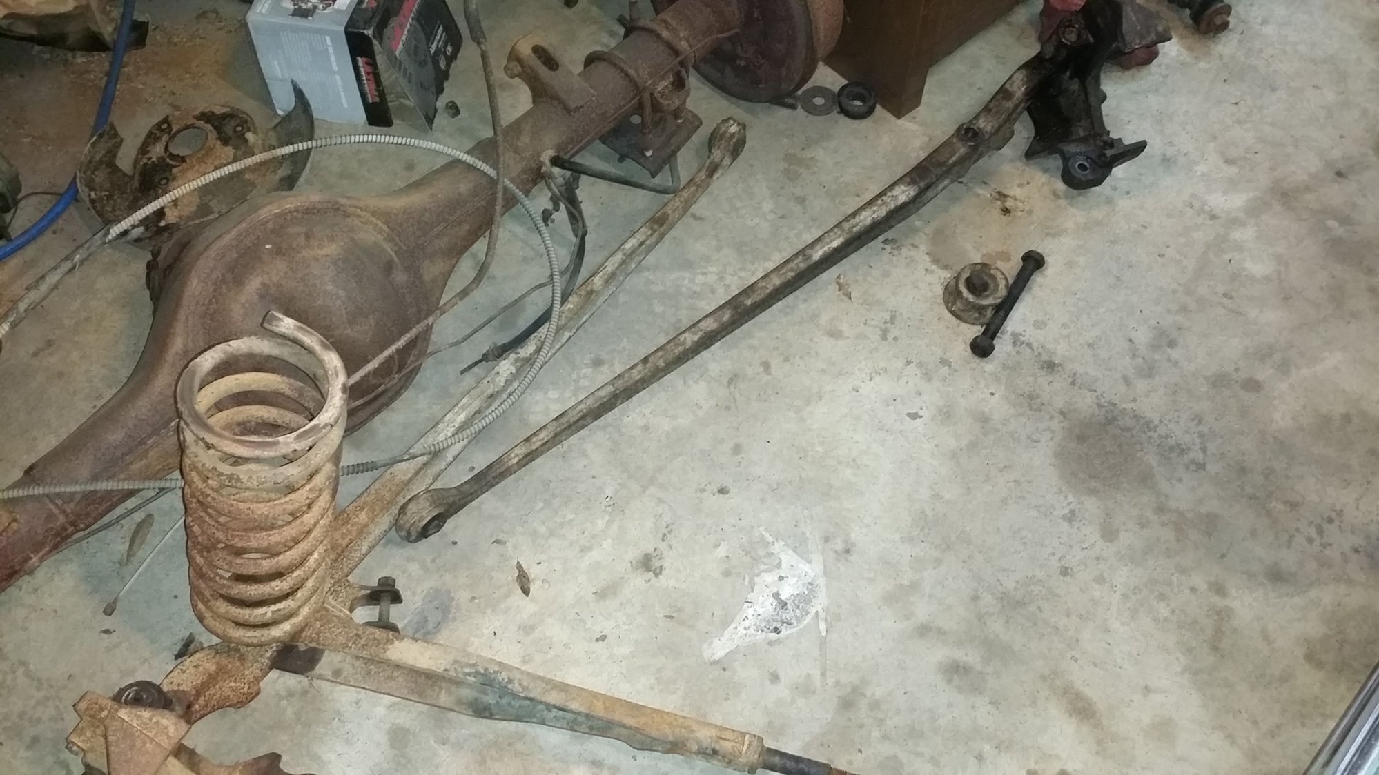

Today's episode was to start cleaning up a front disc brake suspension I pulled from a '75 F100, back in late December.
'75 F100 front discs/suspension shown in the bed of the truck, after I got home with it from the wrecking yard.
I started breaking the suspension down to begin the task of scraping/wire wheeling the grime off before bead blasting the components.
When I took the kingpin caps off the spindle and saw that it had nylon bushings, I thought the kingpin would push right out of the spindle --NOT!! After applying copious amounts of penetrating oil, I tried using a brass drift and a 32 oz hammer, the brass drift and a 10 lb sledge hammer and, I even put it my my 20-ton shop press and it's still not having it. Eventually, I will prevail though in getting them apart, to get the spindle and the I-beam cleaned up.
Right hand radius arm before.
After I wire wheeled and bead blasted it.
A coat of primer applied so the radius arm won't start surface rusting (it's already getting humid around here and it rained today).
I have to do a little work on the dust shield before I finish bead blasting it. Eventually, the rest of the parts will be nice and clean too.
