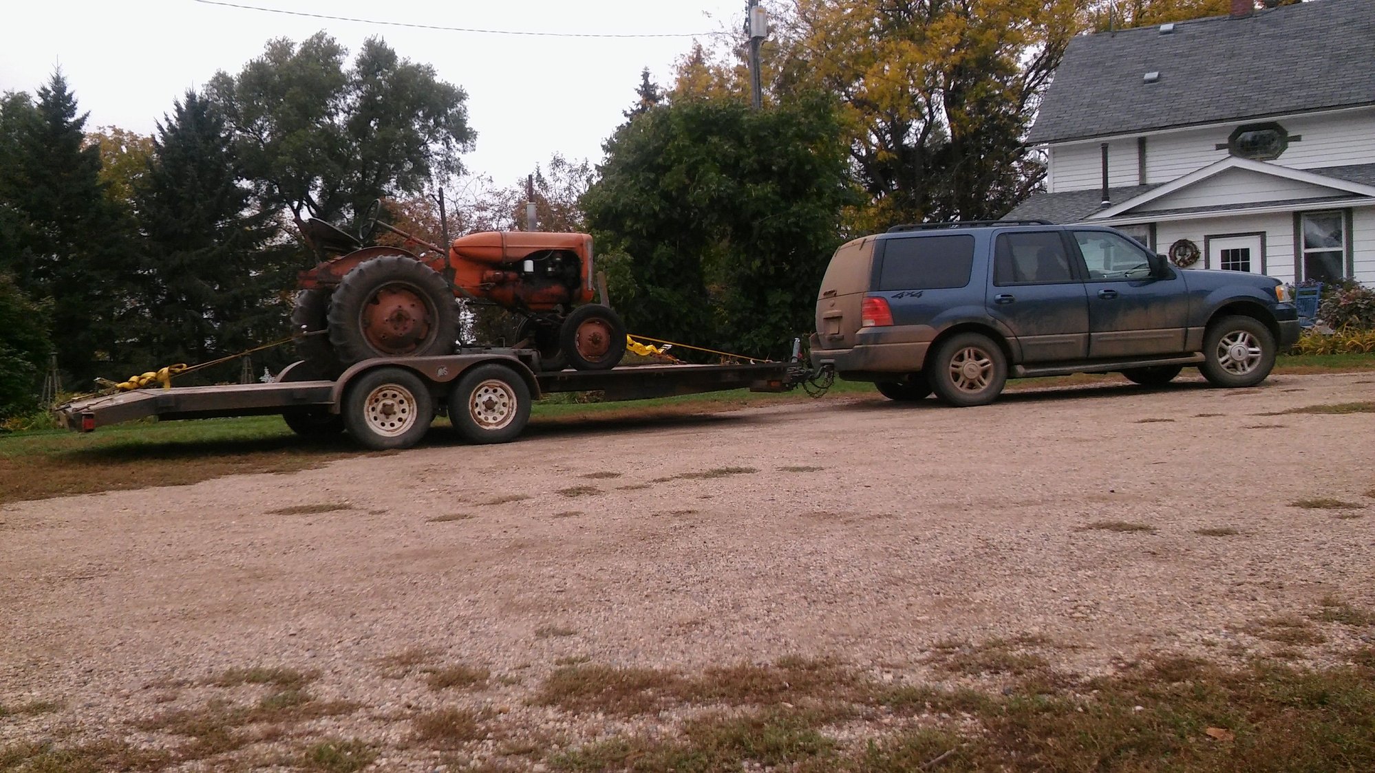

We just bought an old Allis-Chalmers B with a 6ft belly mower. Runs good, no smoke, but it has been mostly sitting in a shed for the Las 3 years or so.

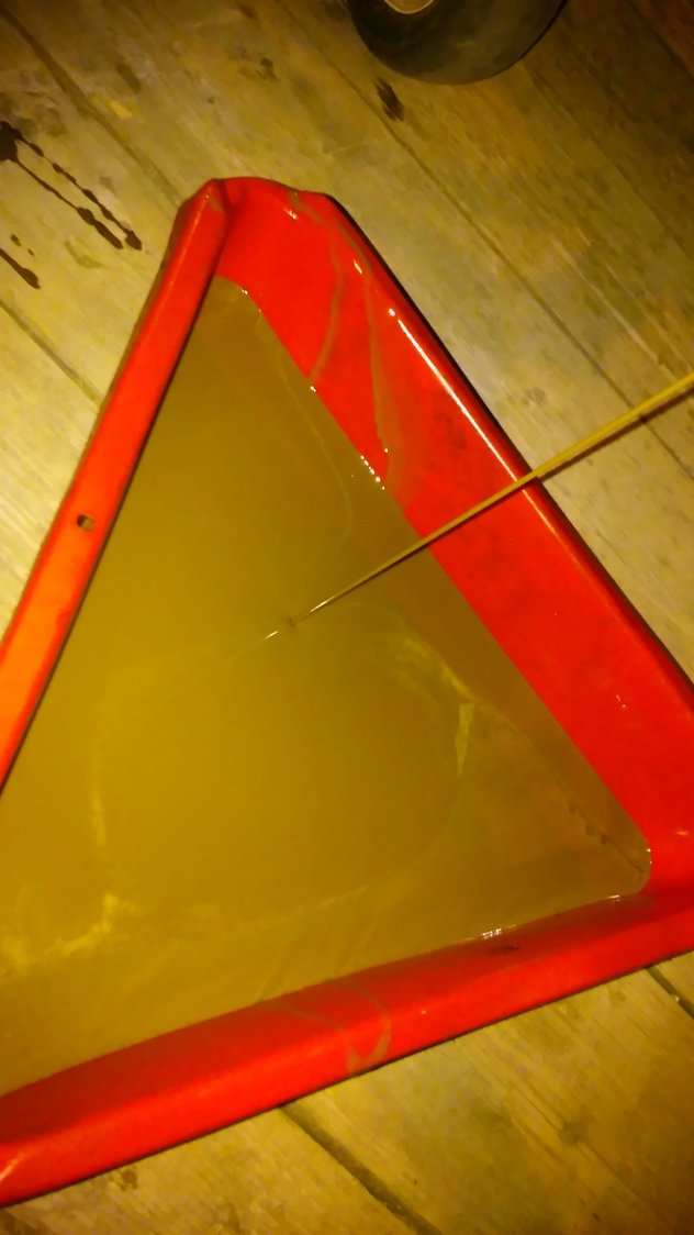

When I pulled the dipstick, the oil was very cloudy and appears to be very moisture laiden.
What's the best way to get the moisture out of the crankcase? My plan right now was to just change the oil and hope for the best, but I got to wondering if there is a good way to flush the moisture out.

On the way home
Oil on the bayonet
Top of cylinder head from the oil fill/breather.
What came out
In the pan
Any thoughts?

IMHO, drain it, run it to get it up to operating temp and drain it.

Good idea to drain the oil, don't forget to change the filter if it has one & I agree run it to get it good & warm to evaporate remaining moisture & keep an eye on the lube condition using the poor mans oil analysis spot check on blotter paper in the Tech Info section. Then do another Hot oil & filter change when you feel it's time, before winter sets in.

I think that's going to be the plan. It's still on the trailer drip-drip-dripping so when I get the time ill go back out to the shed and change filter and fill it back up.
I think for round one, I'm going to use up the gallon of oil I drained out of the 806 when I accidentally overfilled the sump. The oil has maybe 10-15 hrs on it so this is a good use for it IMO. I think ill mow down some of the thistle trees I've been growing all summer, then change it out after a couple hours worth of use.

^ Sounds like a plan. Cut the old filter open to determine if it's loaded with sludge or not & that can sorta help decide how long to run this puppy on the clean up cycle without clogging up the new filter & having it go into the unfiltered bypass mode.
I'd also consider changing the other fluids & filters too, before the mowing session to get the engine good & warm, as they've likely been ignored too. Bet with a little scheduled maintenance TLC this puppy will run real good & last a lot longer, while doing it's thing. Let us know what you find & how it goes
