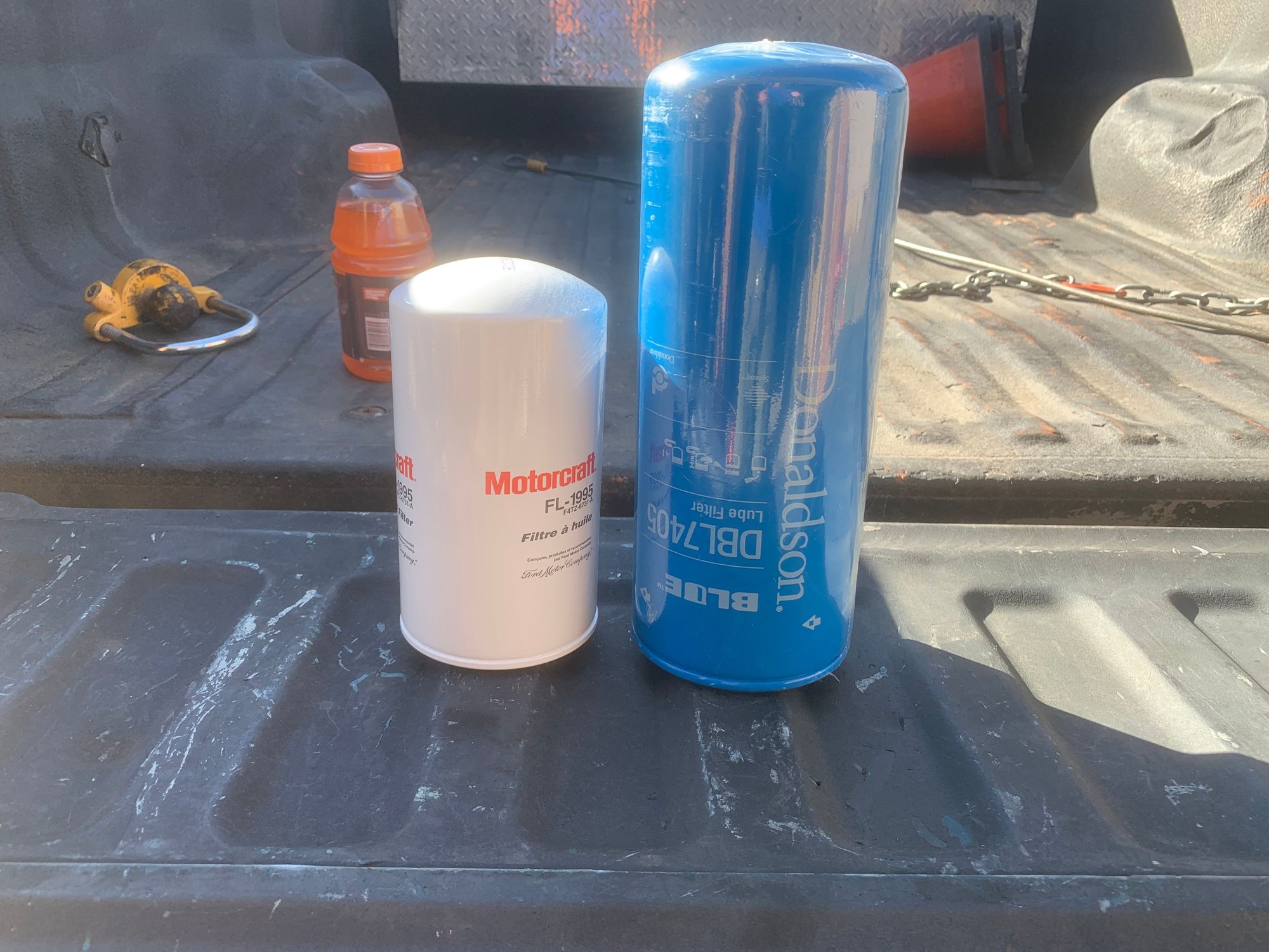

Anybody using those big blue Donaldson filters that Riff-raff sells? I put one on with an oil change a few days ago. Couple of things I noticed:

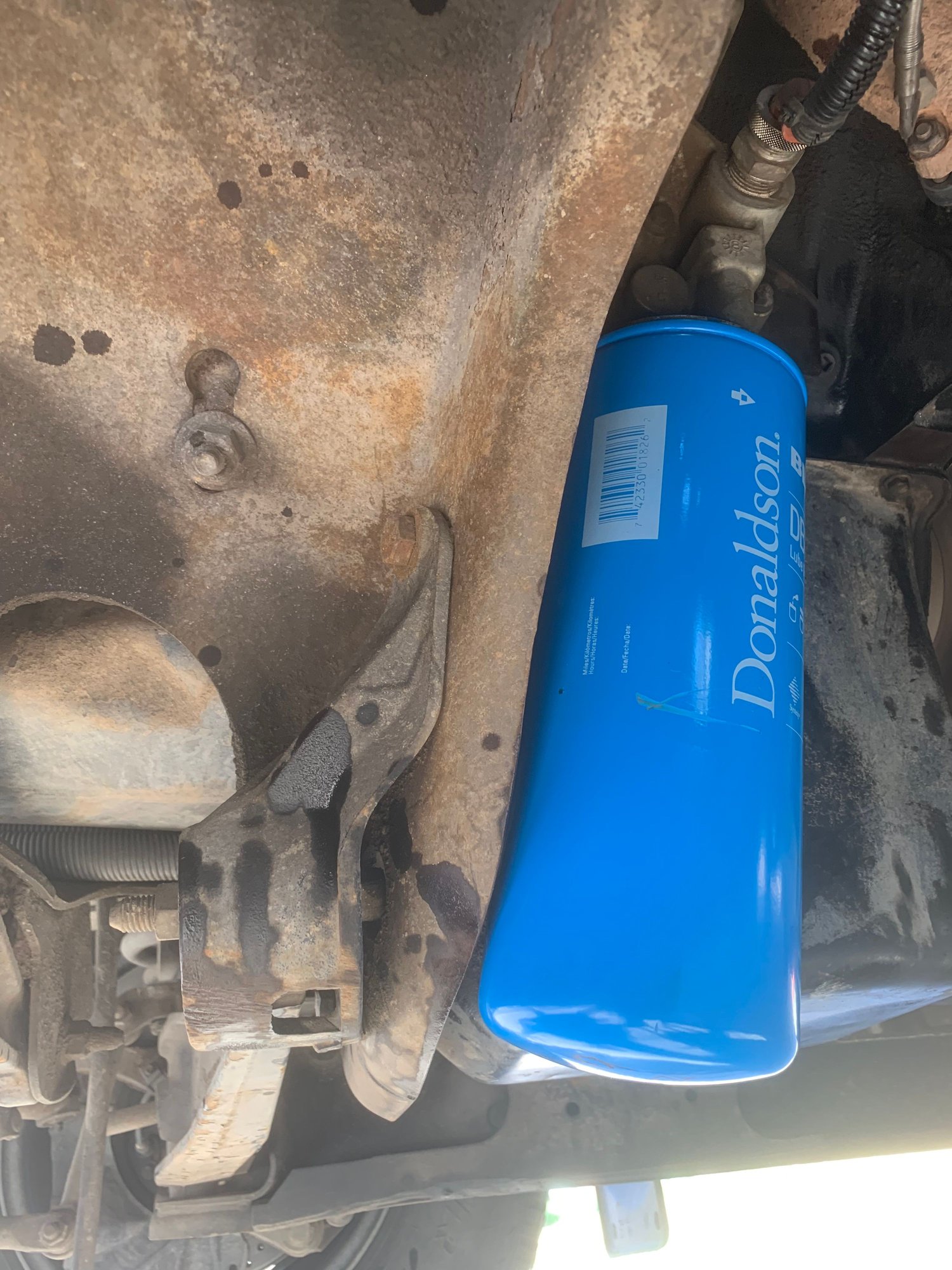

-Hangs down about even with the bottom of the oil pan, and was lightly scuffing the side of the filter on the side of the pan as I twisted it on.
-Takes 17 quarts to fill the pan now instead of 15.
-Motor will run out of ICP and shut itself off unless you either pre-fill it (the filter) or jump the starter relay for 10 seconds or so to build oil pressure. Stock sized filter you can just fire it up with the key and will fill itself fast enough.
-PCV vent tube gases smell nice. Like how the oil smells in the bottle. I had not put new oil in since venting it.
I am also hoping for better luck with the Fumoto drain valve than I had with the EZ. The EZ in my case did not seal well against the pan and caused a seepage mess on the bottom. The gasket on the Fumoto seems to seal much better but I have not driven it enough yet to tell. If that one makes a mess too I will go back to the plug.
I took a sample and sent it in to Blackstone and await my light scolding for running the oil and filter 11,300 miles. 2/3rd's of that was highway miles at least, and it was good oil...Mobil Delvac-1 5W40. We'll see. The last sample of T6 I send in at around 7500 miles they said was fine still.

I guess it is a little wider than stock. The stock white filter is fine and that is what I had on there prior to a few days ago. Riff-raff sells these for an extra 10 bucks or so, so I decided to try it. Coupled with synthetic oil it theoretically should allow extended drain intervals because of the added filtering surface and the extra two quarts of oil.
