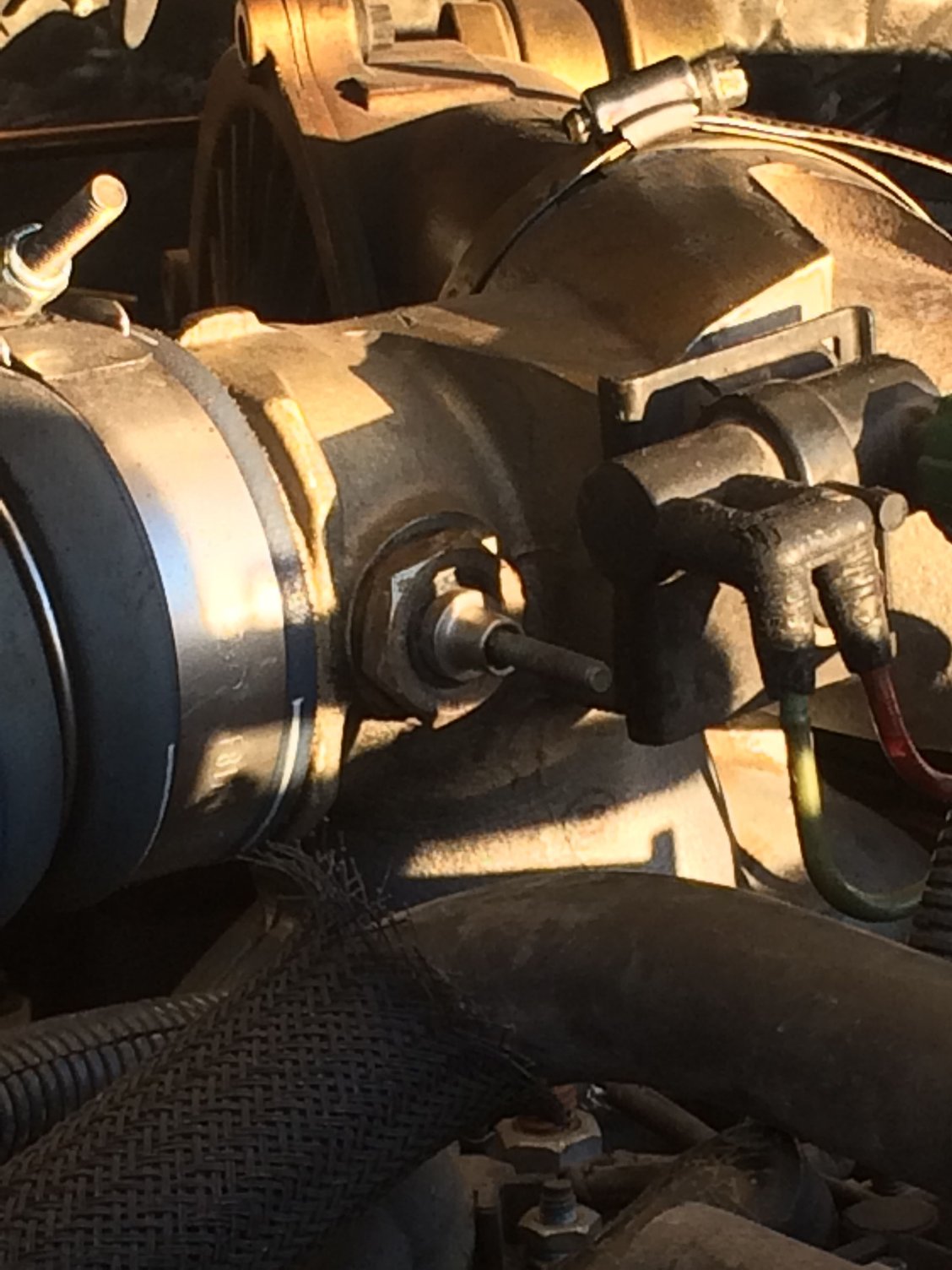

Can anyone tell me where this wire goes?
Old Oct 4, 2016 | 06:22 PM
Dstosh's Avatar
Dstosh
Joined: Mar 2006
Posts: 218
I took off turbo to do ebpv delete and had all the related garb off I noticed this was just floating around the other day.
I taped it. Not sure if it is hot. Black wire with red stripe. Thanks!

Looks like it goes to your air intake heater. Right behind the green line in the pic.

That's what I was thinking. Wanted to double check. Thank you!

I removed that wire from the AIH solenoid. Please note the gauge of that wire - it carries a lot of current. If that black tape falls off (incredible as it sounds in a greasy environment), you are exposed to the potential for a very big short.

If I delete the AIH can I just take that wire right off?

Absolutely!

Deleted! I will get a plug with a port when I get a boost gauge. Thanks all.
Isn't the black with red stripe the ground? That's what I had loose on my truck. I took it off and it was just attached to a bolt on the motor. I pulled the solid red wire off the aih solenoid.
Not calling you out tugly, I have a lot of respect for your posts and have read a lot behind the scenes with your info, just wanted to clarify
Thanks

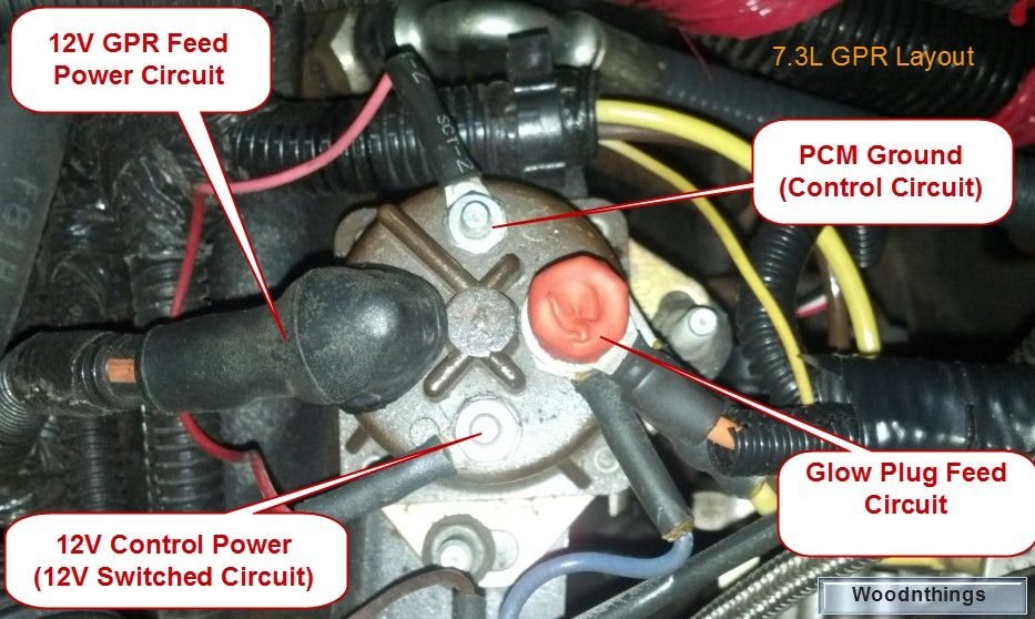

I actually appreciate it when people catch me when I slip... I dread the idea of leading people to wrong conclusions. Look carefully - that isn't a black wire at all - it's shrink tubing on the connector. I can't explain the red color on there, other than it may have rubbed on something. If you're looking for a black wire with a reddish trace, consider this:
Maybe the coffee hasn't kicked in yet, but I can't remember any large ground wires in the valley - nor can I think of a reason for one with the whole engine being a ground.
