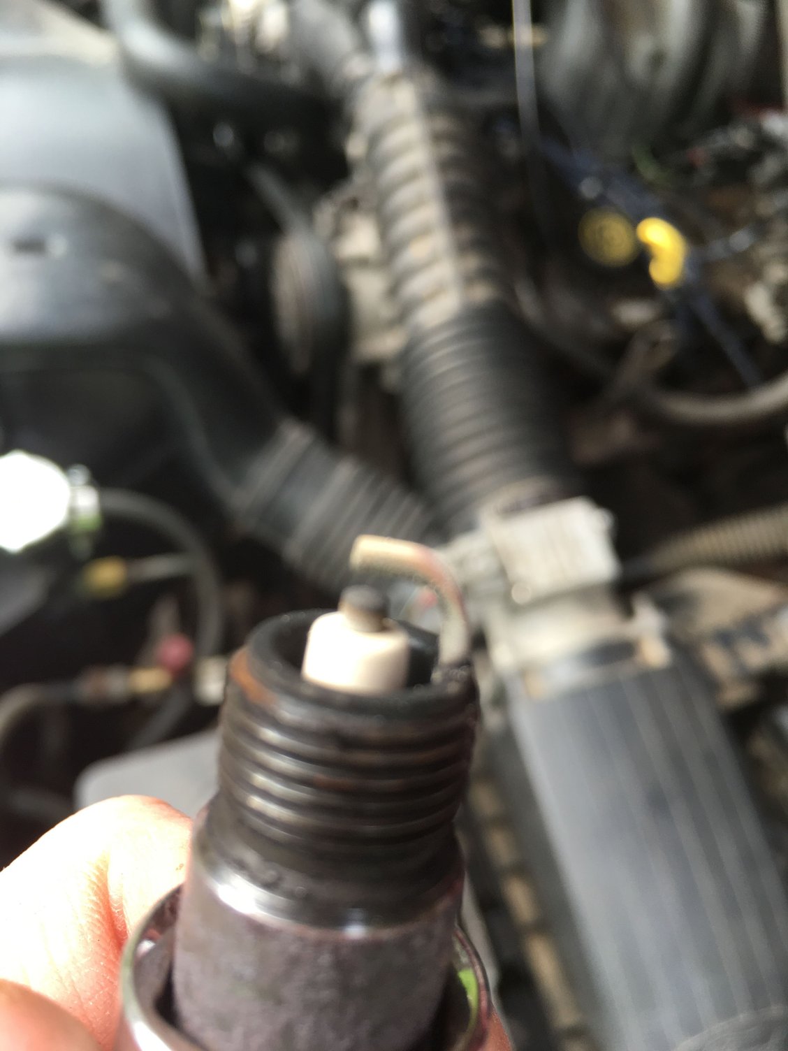

Old Oct 8, 2016 | 08:56 PM
BeholdenZippy's Avatar
BeholdenZippy
Joined: Sep 2016
Posts: 219
Originally Posted by Encho
The sparkplug gap should be .044 (stock) or .055 (sixlitre tune-up). I've still recently replaced my sparkplugs and the gap had opened to .070 with no negative consequences.
Some of the plugs had some light blistering. The gap was all in specs(.052 to .056).
