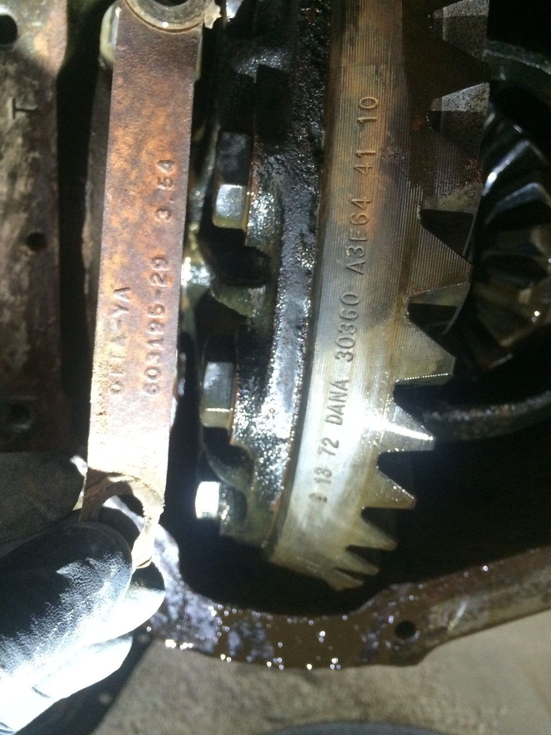

Best way is to just take the cove off and check the numbers. This will also give you a chance to put eyes on the hard parts. Never know what you might see that is on the verge of letting go! As you can see in the pic below, someone before me changed the gears and left the old 3.54 tag on the cover. I also found the very end of another tag under the head of a different bolt. The axle tube code said 3.54, the tag said 3.54, actually installed were 4.10.
