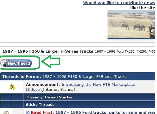

how do I start a thread I have search and can not find where to do that
Old May 3, 2018 | 11:57 AM
rla2005's Avatar
rla2005
Posts: 20,789
Likes: 1,753
From: Kentucky
Upper left side of the forum page...New Thread
