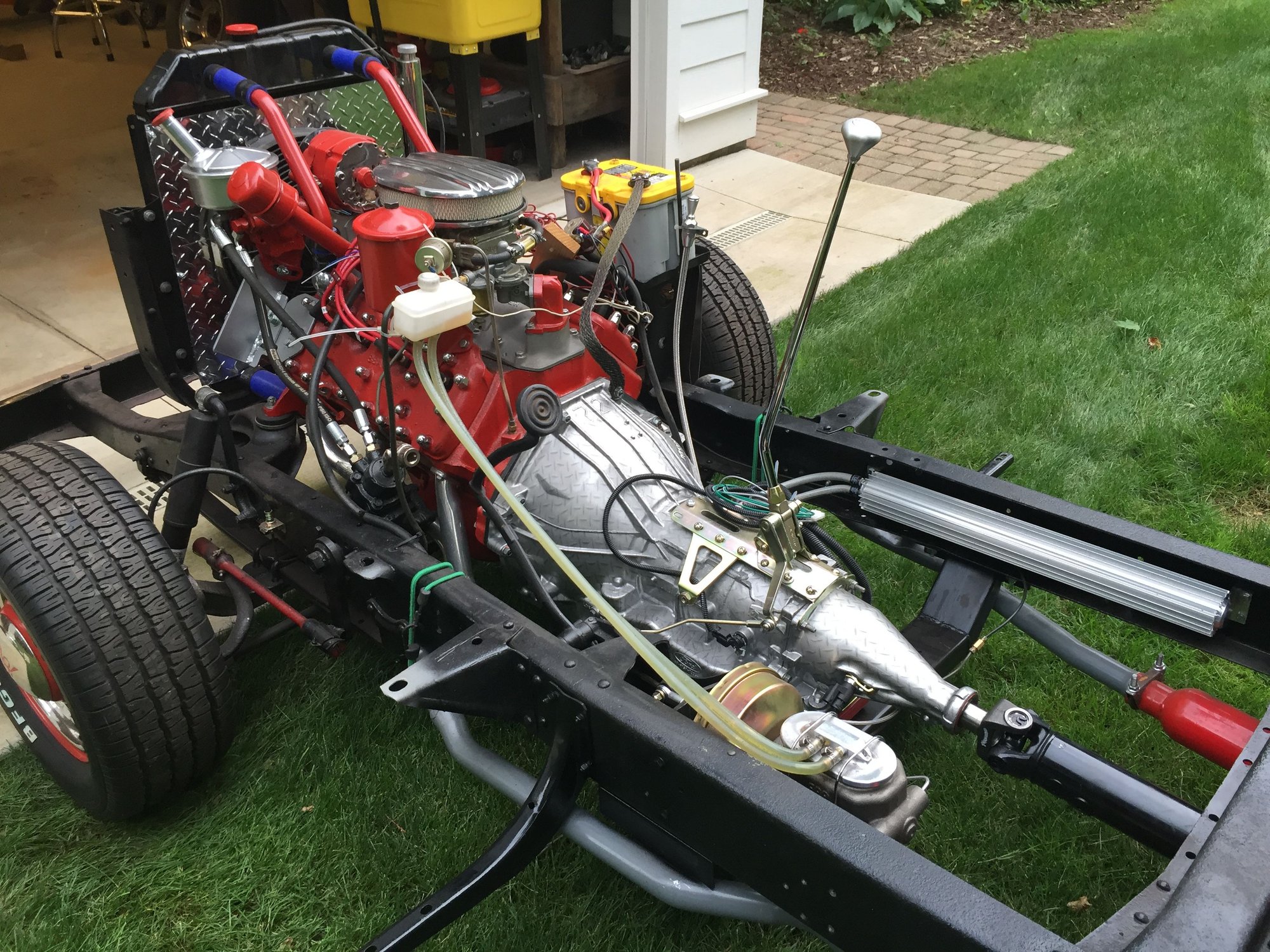

The only problem that I had was because the F2 crossmember is significantly different from the F1 nobody makes a booster/dual chamber master cylinder kit kit specifcally for the F2. So I modified a CPP F1 kit slightly and it fit really well. This link shows you how: https://www.ford-trucks.com/forums/1...-48-52-f2.html. Just make sure that you order the disk/drum version if you have drum brakes in the rear so that you get the right proportioning valve. This setup also lets you retain the stock brake pedal sled. PM me if you have any questions.

thanks! great pics! I will watch for those fit issues you mentioned with master cyl install. I did try installing disc brake on current spindles and outer bearing inner race bottomed on taper, thought Chinese bearings might be the problem, noticed number on bearing was same as timkin number for 70s to 90s Harley wheel bearings which I had in stock (I work on Harleys for a living ) tried installing with, same results. called CPP and was told spindles need to be from F1, I was under impression that F1 F2 had same also. I know they interchange for stock application but with conversion, maybe a problem. bought a set of spindles off of a F1, gonna try them on for size before putting on to axle. I'm thinking of turning down the taper a little on the lathe but worry it will weaken and break under load. don't want to ruin a good set of spindles knowing they're not remanufactured either. Are the tapers thicker on F2 spindles for heavier load capacity I wonder? going to mike them and compare when it gets here. By the way, saw lots of pics of your stuff, nice work! great advices!

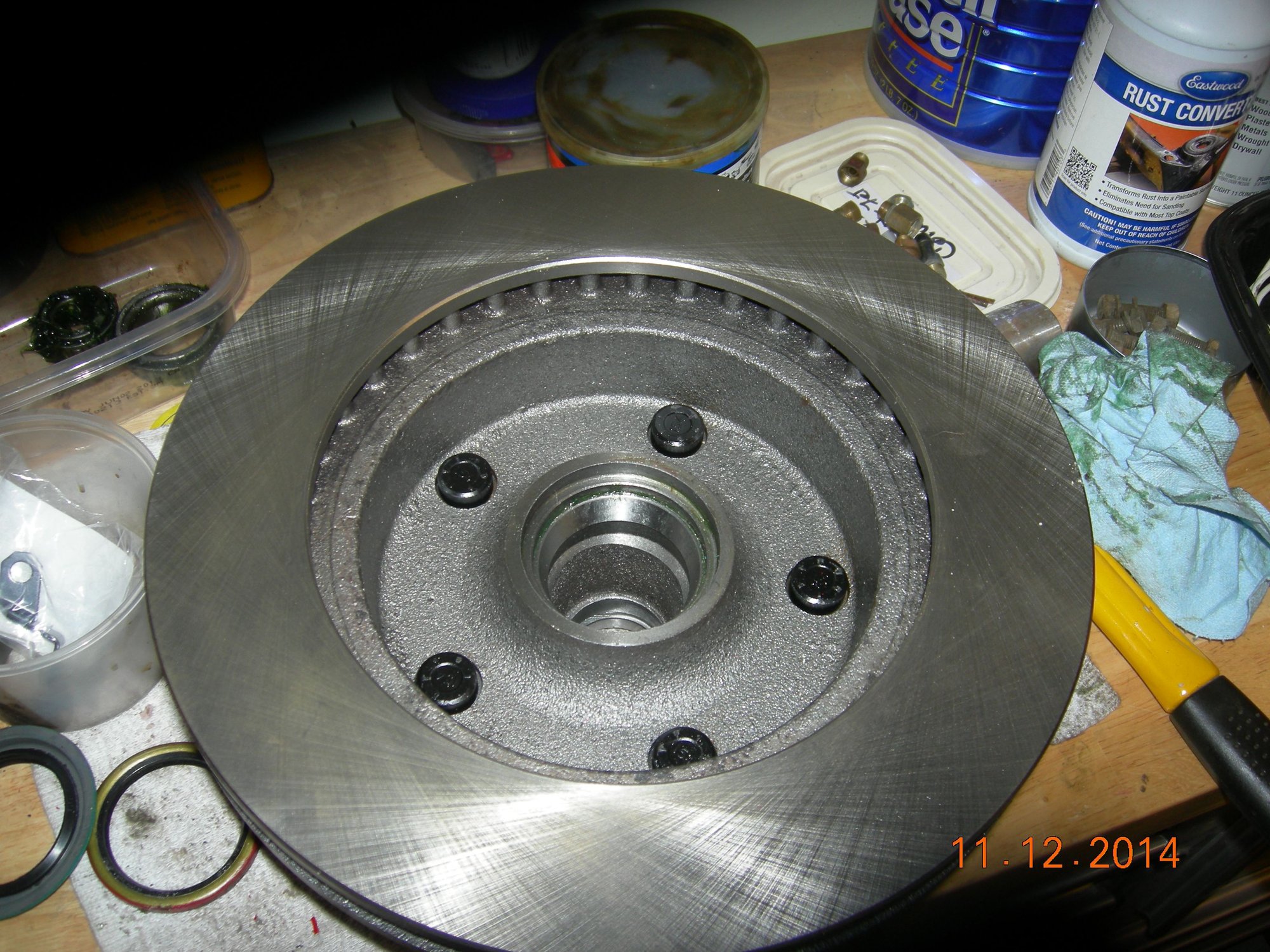

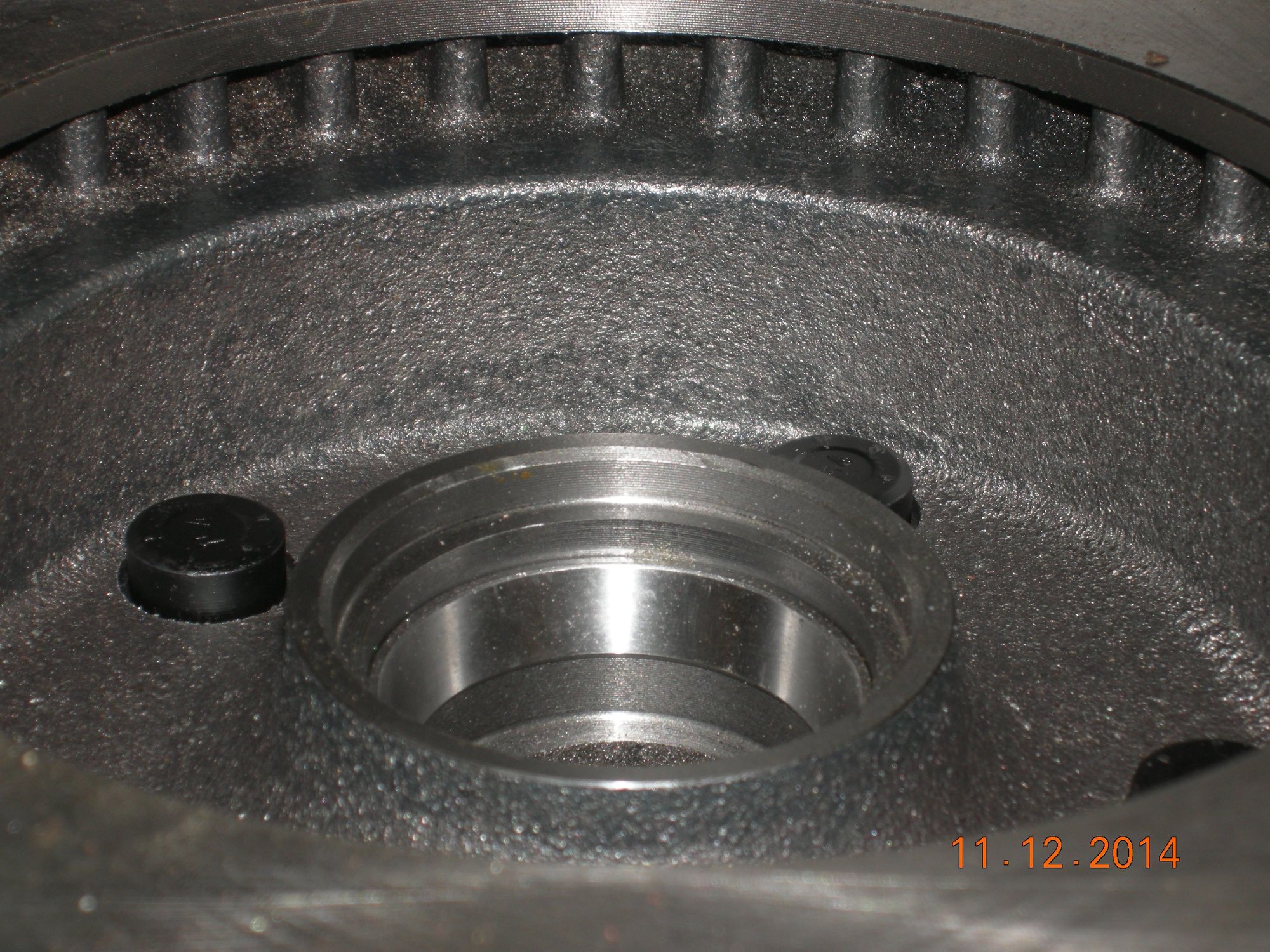

The only real problem that I had with the rotors (F100 rotors according to Speedway) was when I went to install the inner grease seal. I ruined one trying to get it in. Then I looked at the other rotor and the edge was chamfered and the seal went right in. So I chamfered the edge on the other one with a die grinder and the seal went right in also.
Unchamfered
Chamfered
So I would check your new rotors. Easy enough to fix.
