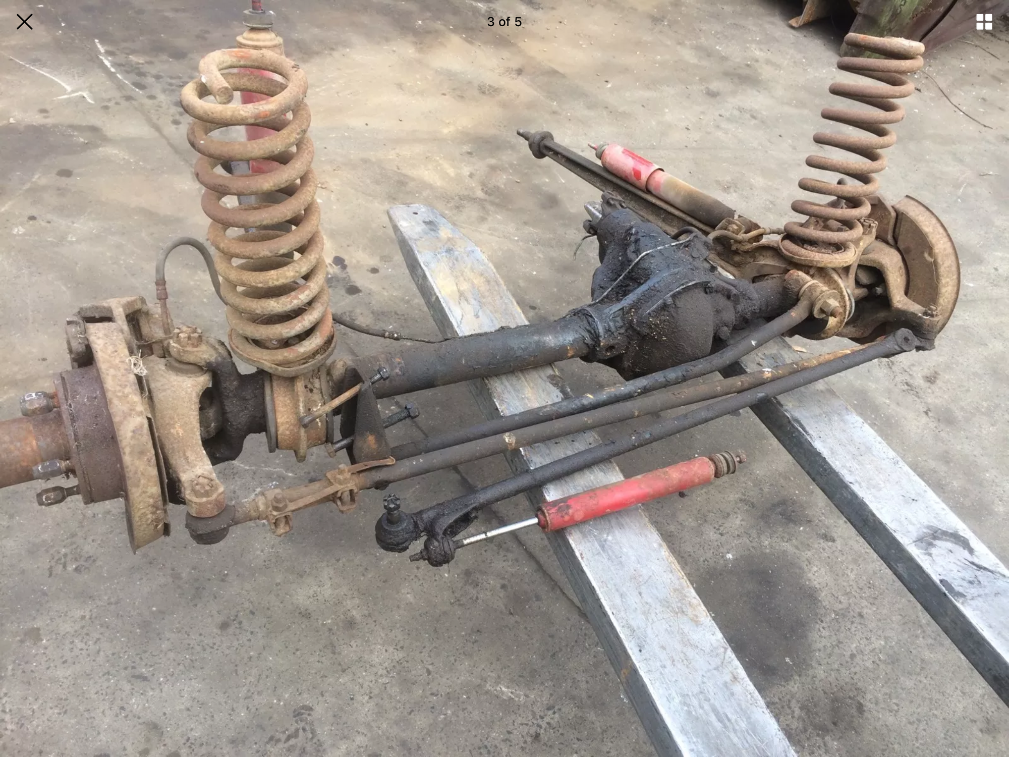

Would something like this from a local f100 wreckers bolt straight into the stock radius arm mounts and Spring location?
No, the above front axle will not bolt in. A original style 2 piece ttb 4x4 axle from a 80-96 f150 will bolt right in.
Your transmission plans will not work. You will need a 4x4 transmission. Once you get that, it will bolt in, change the rear driveshaft, add the front driveshaft and you are ready to go, all a bolt in.
P.S. You need to find out your rearend ratio, the front axle ratio needs to match. If that is a problem, just bolt in the rear axle from the donor that you get the front axle from. Check your wheel bolt pattern, some f100's had a Ford car pattern. If yours does, I would go ahead and swap the rearend out also, the 4x4 axle will have the Ford truck lug pattern.

I will back away from saying the above axle will not fit up. I see you are from Australia, they did things differently down there and that axle pictured may bolt up, we didn't have some of the features you guys have down there. I see in the picture it's a right hand drive axle, the steering box is on the other side.
