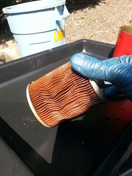

cool thanks! I had a nice brown sludge in my coolant filter that I attributed to oil - hence the oil cooler seals being done yesterday. Here is what my coolant filter looked like:

That's pretty bad, I'd keep a close eye on it.

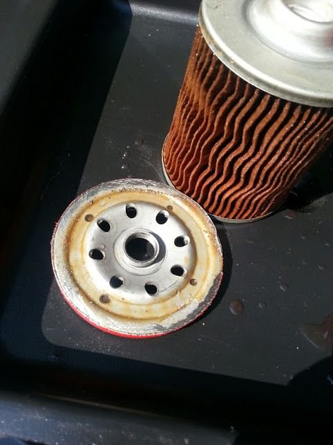

I plan to. Those pics are from mid-July. I put a new coolant filter on at that time (duh - cut open the old one). I cut that one open last night and it looked much better. I also flushed the system and put new red ELC and distilled water in.
Here are the pics from the one last night:
